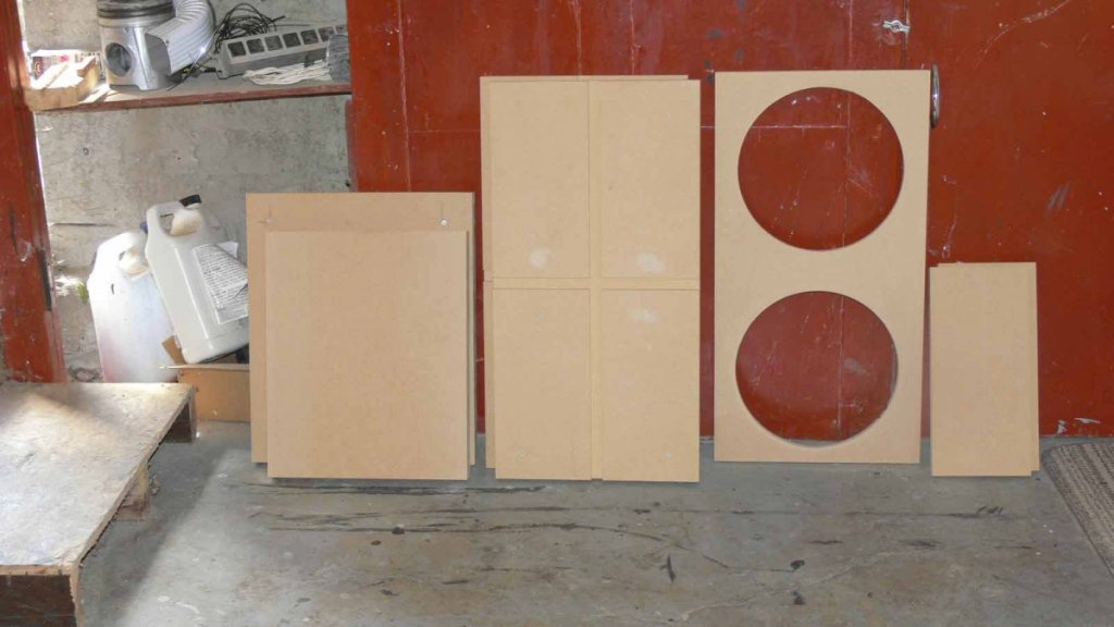

I'm starting with  one dual 12" OB H-Frame, can't afford to  do them both right now .  This will replace my current sub, a CSS Quartet 10 ( 10"  SDX 10 driver and  2 10" PR;'s).  Eventually I'll  build the 2nd H-Frame and have them config'd in stereo.

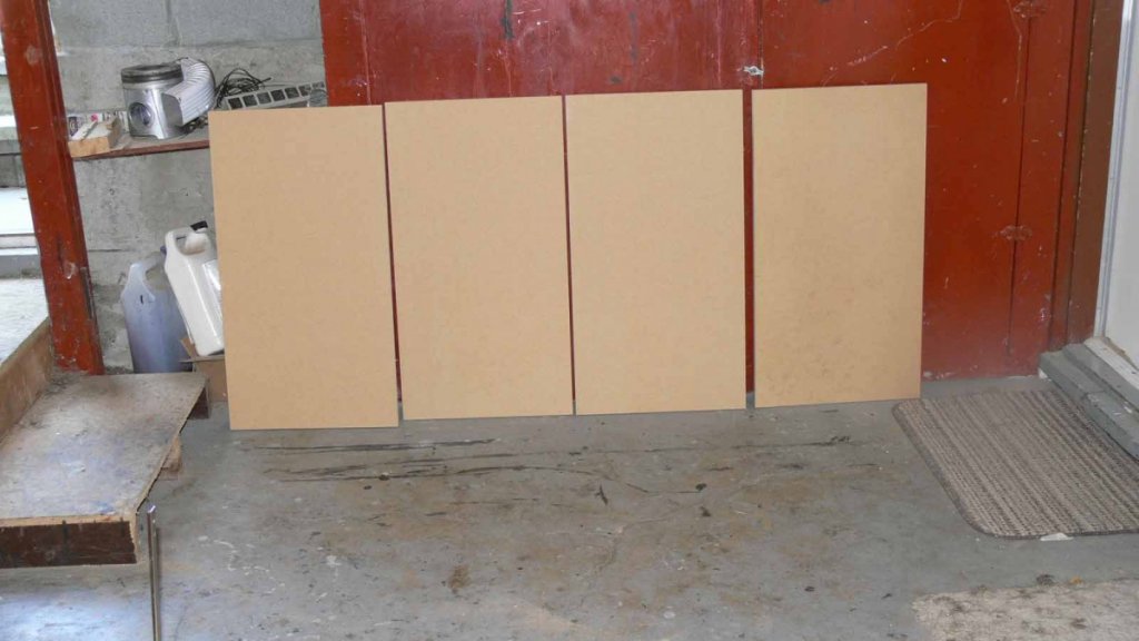

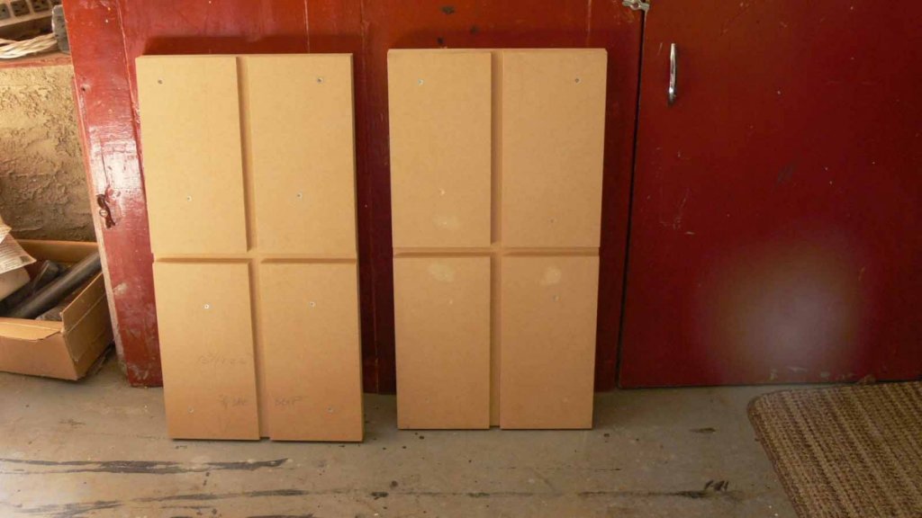

So,   I started with 4  panels,  27" x 15" x 3/4"

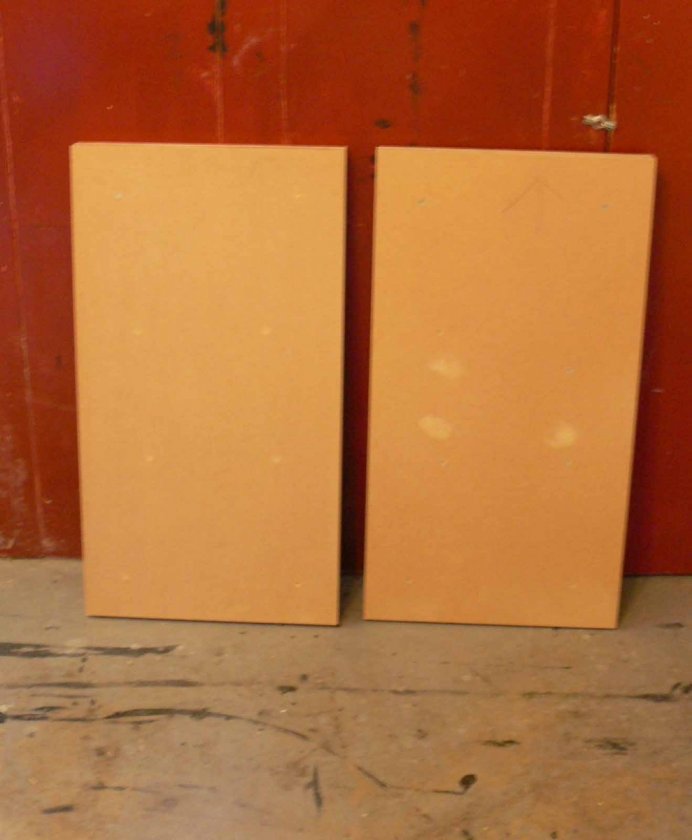

I laminated these into 2 panels

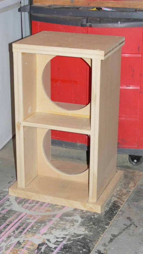

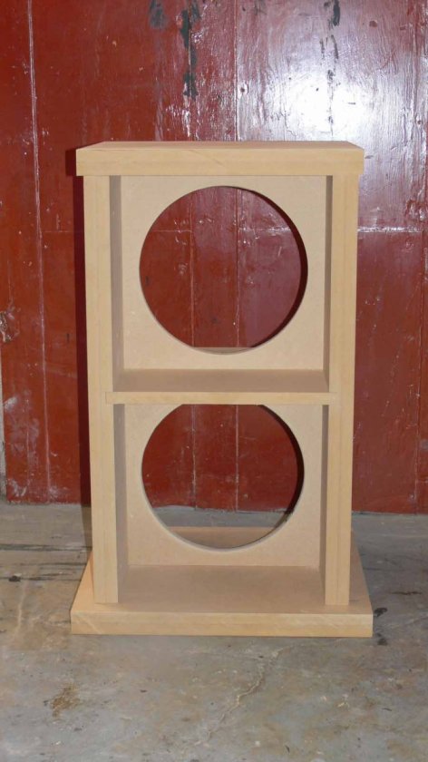

Next the panels were trimmed to size  ( 26 3/4" x 13 3/4"  and  3/4" x 1/2" dados were cut for the  baffle and braces
I  cut the baffle 26 3/4" x 14" (an extra inch wider for the dados), routed the 11" holes for the woofers and  put a  small roundover on the rear  side of each cutout. Braces were cut 14" x 6 1/2".   Also  laminated  a base and a top plate that I left  long so I could  trim it off after I glued it in place
Next I dry fit it all together to make sure there were no issues

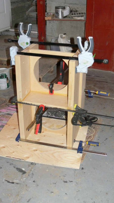

After that it was time for some  glue
I had to use screws  instead of clamps to  glue the top plate  on,  I don't have long enough clamps  :(
Plan was to   let the glue set up and then   get the flush trim  bit out and zip off the excess....  problem.....  my  flush trim bit only has a 1"  cutting blade :duh:  Had a 2"   one sent out this afternoon.  So instead,  I   did some sanding  and  put a 3/8" round over on all the  inner edges  of the cabinet.  I'll add 3/4" roundovers to all lthe outer edges once I get the new  flush trim bit and can   cut off the excess  from the top plate.  Note, I'm  just dong the round overs on the cabinet for appearence.

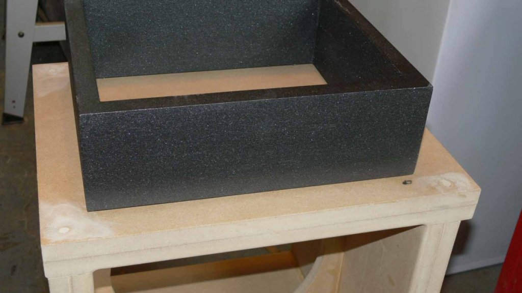

As for the amp,  I  just built an open box  to houe it in.  I am going to put some small rubber feet on it and try it both ways... sitting ontop of the enclosure as well as on the ground to see if I notice any difference. I kind of doubt  it, but you never know

Once  the  new flush trim bit arives (need a longer one), that top panel will be trimmed down to the overall width .I did see the pics  you mention, I think they were actually made by Ruben  (post #59 http://www.audiocircle.com/index.php?topic=125667.40 ) and  really liked them, thought about going the same way but I want these towers to have a similar shape to the OB7's (at least from the front) so there will only be the wider base.   I did not double up the baffle or the braces.... thought about  doing the baffle  but figured with the dados and the little area of baffle left exposed,  there would be little room for any   movement /resonance once the drivers are installed.  It's  very solid as it it is
Not much I can do  until that bit arrives .... this afternoon I did  finsih up the open box for the amp Gone back to the Duplicolor paint for the finish but going a little draker than the  OB7's ,  figured the darker color  would   be more versitile if I ever decide to change spekaers in the future . Color is  called  Metallic Graphite.
