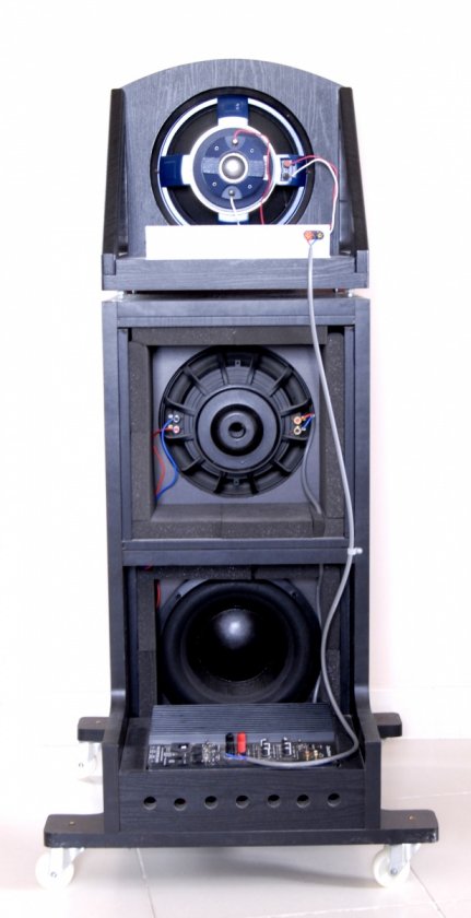

Here is a  brief update.   I finally placed the parts order with Danny for my 2nd H-frame.  Received  them all last week and this past weekend  I got it all assmebled, so..... it is up and running  8)
 Right  away, there were  a couple things very apparent 1.  significantly more  "wieght" behind the bass , 2. An increase in both the  depth and width of my sound stage, this I was not expecting at all.  I shot Danny a  mail about this and he said  he has had similar experiences, he suggested playing around with the dampening  settings  as they can have an effect on the size of he stage  (I'm trying the low setting out   now Danny).
I know  bass is supposed to be omni directional but adding the 2nd H-frame definitly seems  to be creating more movement in the reproduction,  you really notice a drummer going   from one side to the other now.  This was present before but not to the same deree.
I listened quite late on Saturday night and didn't seem to notice much difference comapred  to the single H-frame at low volumes but,  listening late  again last night ( the subs now has  some time on it)   I'd have to say there is  even  more behind the bass at low levels.    Guess the bass just seems more  dynamic with more  ooomph
As I mentioned to Danny,  I'm finding the pair very impressive !!
Here's a couple of piccs, one without grills, one without
-jay
