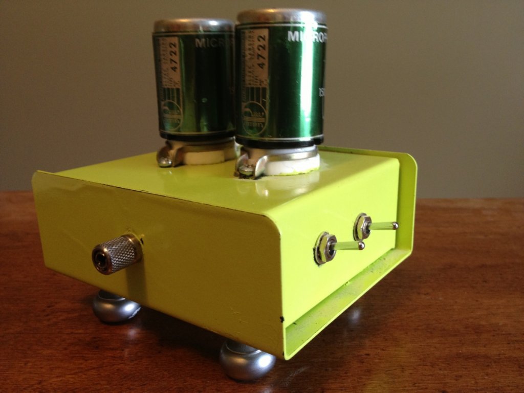

I plan on getting an SUT in the next week. I friend has a Peerless/Altec Lansing 4722 SUT i'm thinking about buying but I don't know jack about it and can't audition it. I now have an Audio Technica AT120E cart. I like the sound but want to upgrade to something with better definition.
Are you familiar with the Peerless 4722 SUT at all?
Here's a pic of it. Not sure what it's worth, I thinking maybe $350.00  :dunno:

I buy that in a heartbeat for that price. :thumb:

I can see you've got the itch, but the scratch is going to cost you going the LOMC route.
I'm not partial to SUTs, however the Peerless is a good buy if it works.  It's tough buying something like that without owning a LOMC and you'll be setting the money drain wheels in motion.  Just the SUT is like owning a canary with a tracheotomy and is $400 enough for a LOMC ?  Maybe.
If you're getting good results with the 120E and just want more detail, get an ATN150MLX stylus and you'll get a lot more detail and all kinds of harmonic texture and all that good audiofool stuff and they're < $200 at Amazon.
You'll have to spend at least 4 or 5 X that amount to equal the SQ with a LOMC considering the price of the SUT.  There are some used ones you can get for around 5 - $600.  Sometimes it works out great.  I saw a used Maestro on Agon for $600 (I think), but I'm not sure if it's better than a 120/150MLX which is a really nice combo.

But I will say this in argument for the stepup I have never heard the OC9 ML MKII sound like it does now without it.
Excellent with the Parks Cinmag 3440A step-up now at $289 unless you can find used.
After hearing I would not run a low output MC without a step-up.
That Peerless is an ugly little puppy but probably sounds good if it matches the Cart correctly.
