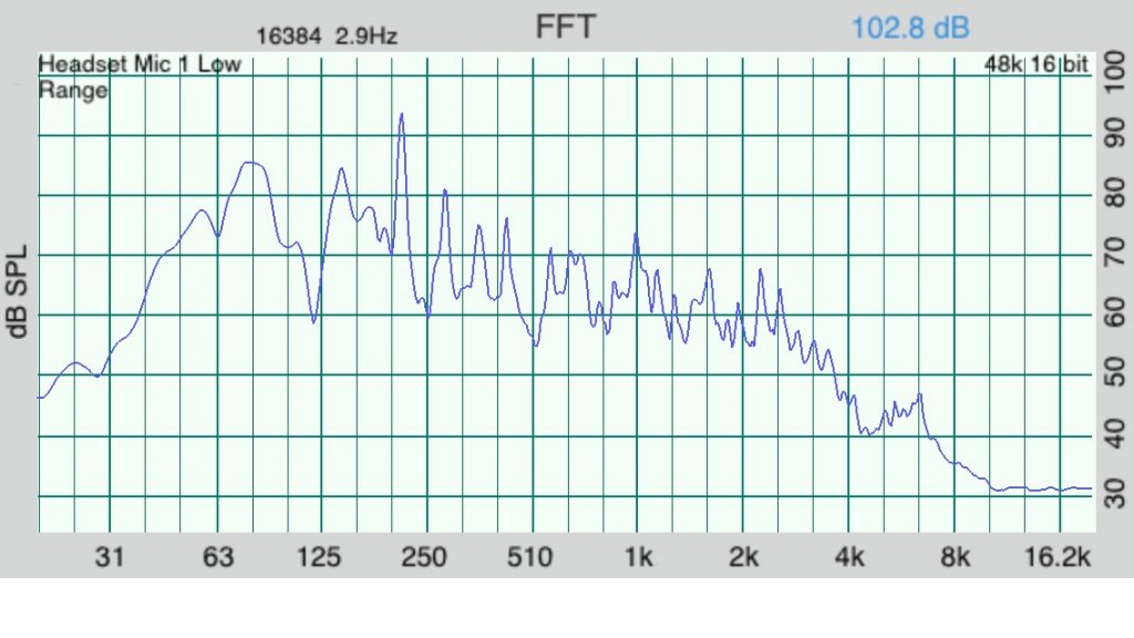

When I built up my basement last winter, I paid some attention to sound transmission, but did not try to build a sound proof room by any means.
The compromises I had to make were numerous, but in the end I can measure significant reduction in sound transmission from the basement to the main floor and bedroom levels.
For the basement, I did the easy stuff.  5/8 drywall ceiling (single layer, directly attached to joists), Roxul safe n sound in all the joist bays in the ceiling, and all interior walls too, Roxul safe n sound door at the top of the stairs, door sweep and weatherstripping around the door, and I stuffed my bulkhead (where the HVAC main trunk line runs) with pink insulation.
With roughly 85-90db peaks in the basement, it is 25-40db quieter upstairs using an app on an iPad for SPL.  Not scientific at all.
I can listen at any sane level anytime of the day for music.  Movies with significant bass (keep in mind I have a 500w amp and a DIY 2x12 sub) will transmit vibration to the whole house if played over 85db in the basement.
The only real sound transmission from main floor down to basement is footfalls.  Using hat channel on the ceiling would have helped a lot, but confusion between my contractor and my electrician during the install of the 23 pot lights made using hat channel not likely.
If I were to go back and change anything, it would only be to use hat channel for the ceiling.
I did all the sound proofing work myself, so it added only the material cost.  Less than 1K added cost for the door, Roxul  etc for the 500 square foot basement project.

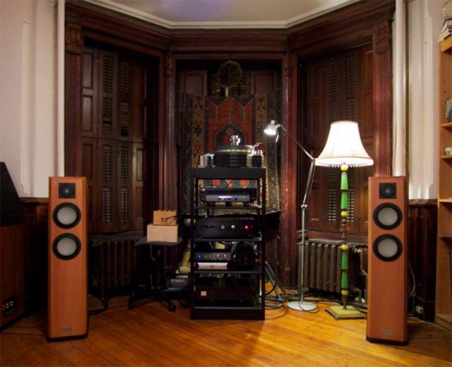

I'm bettin music sounds pretty darned good here.  Anybody got a particular speculative favorite set-up you'd post?  Yours (which wouldn't be speculative in that case) or anybody's that you think might be favorably abetting those old sound waveforms of ours?  I got this from the AC photo gallery.  It belongs to a chap in Brooklyn if memory serves.  Ok, Maxboy, if I include this post and encourage others in this thread of yours?  Good listening to you, sir.
PS-  And check out this bad boy in a basement:
http://www.audiocircle.com/index.php?action=gallery;area=browse;image=75352
JoshK
Re: Dedicated 2 Channel Room
« Reply #19 on: 18 Dec 2014, 02:18 pm »
That is Occam's (Paul) system.  I've been there, but not since he got those speakers.
