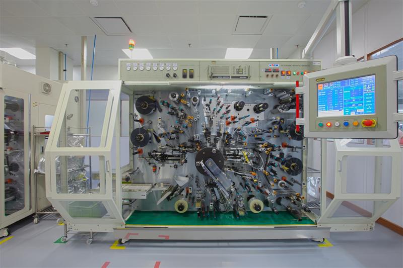

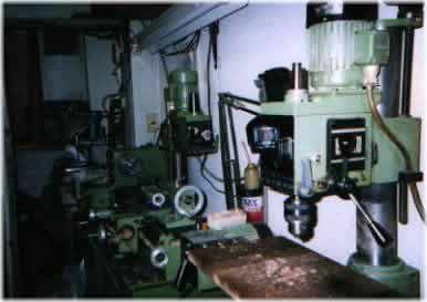

Speedskater
  • Posts: 2758
  • Kevin
Re: Favorite Coupling Cap Brands and Types
« Reply #29 on: 27 Jun 2014, 05:35 pm »
Boutique capacitor manufacturing:
Mainline capacitor manufacturing:
Roger A. Modjeski
« Reply #30 on: 27 Jun 2014, 06:13 pm »
It takes big expensive machines to make capacitors of the highest quality construction. "boutique" capacitors (unless custom manufactured by a major manufacturer) are seldom of the highest quality construction.
I agree about the unreliability of Boutique caps. Thanks for the pictures of the machines. The machine in the bottom picture is quite something and cost big $$$. Do you have a link to the company that made it?
