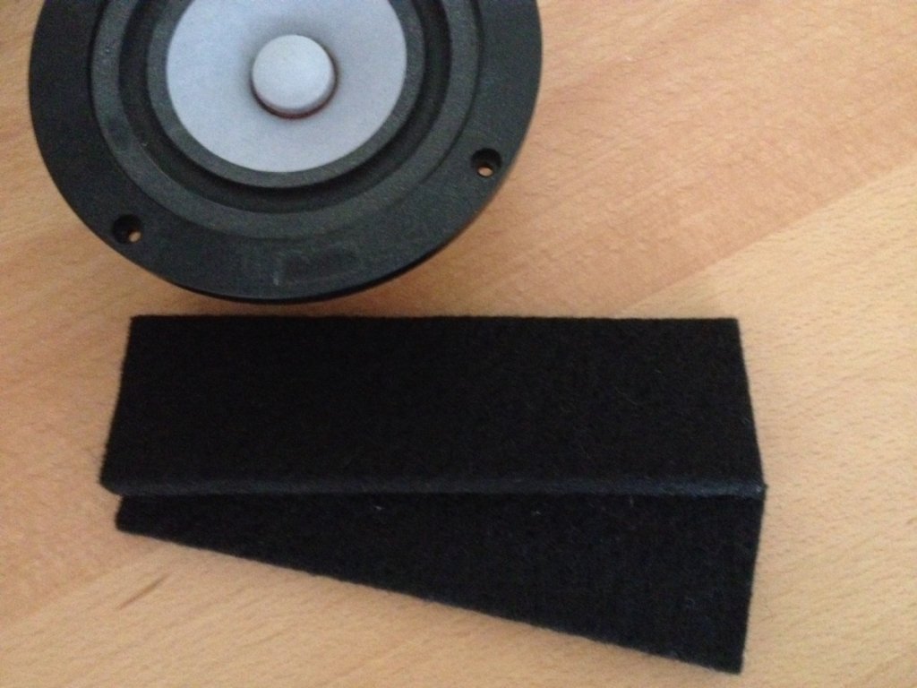

Tuning Out Dipole Bloom with the AMTPro The Dayton AMTPro is a really interesting driver. For those who might not be familiar, the driver is delivered with two thick felt pads suspended between the neo magnet frame at the terminus. This allows the AMTPro to be either configured with a primary cardoid pattern (rear wave attenuated) or as a true dipole source (felt pads removed). Initially I was frustrated by the in room measurements of the AMTPro. The response was acceptably flat with the double felt pads in place and the rear wave attenuated. Removing the felt pads really opened up the sound, as expected, at the expense of a less than ideal response curve. In fairness, the less than perfect curve with the felt removed is partially a result of dipole bloom heard at the listening position courtesy of the front wall reflection. In the beginning I alternated between the more flat, more constrained cardoid pattern and the nicely diffuse but sometimes glaring figure eight pattern. At some point I got the idea to try using the felt pads to "tune" the driver's measurements from the listening position. It worked well. The AMT diaphragm is divided into 18 sections by a black plastic grill/guide. The felt pads are held in place by friction and can be slid up and down the length of the frame. Covering 9 sections, for example, reduces the rear surface area of the diaphragm by 50%. Doing so reduces the amplitude of the rear wave but still maintains the proper dipole presentation relative to the front wall spacing. I suppose the figure of eight pattern is now somewhat irregular in its polar response, but it is a good alternative in the overall scheme of things. The photo below shows the AMTPro with 5 of the 18 sections exposed (yellow diaphragm showing through) which represents the flattest on axis response in my listening room. This will vary based on distance to the front wall, room geometry, absorption and reflection, and a host of other environmental issues. In my situation I chose to uncover the rear diaphragm at the top of the AMTPro, since the expanding baffle width is said to help reduce bloom by modifying the way the rear wave wraps around the front and causes cancellation. The second photo shows the thick felt material supplied with the AMTPro.
