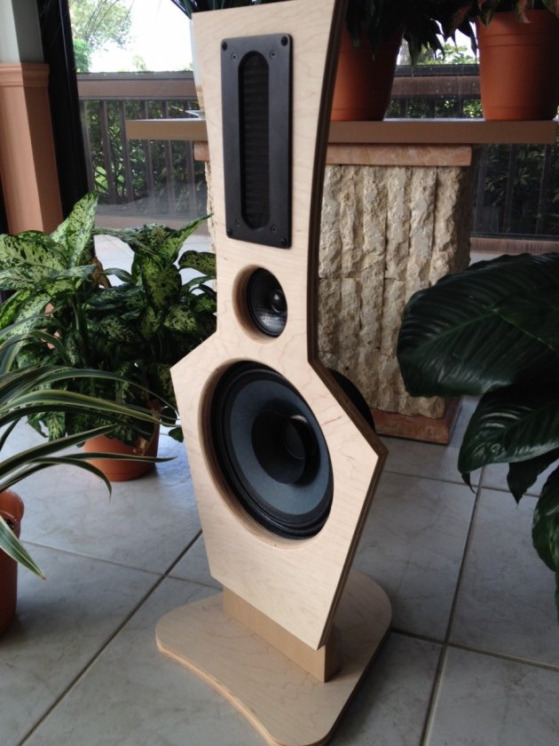

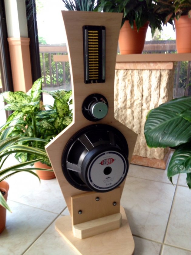

The Hestia V represents my 5th documented OB design on AudioCircle and includes many of the design choices I have found to be successful.  It is true-to-form regarding my own design philosophies and musical tastes.
Major design goals include:
•   A passive crossover/compensation network coupled with specific driver selection negating the need for active line level digital or analog filtering and more than two sources of amplification.
•   Availability of CNC baffle milling service for those wishing to build the design but avoid the complexity of milling one’s own baffle.  I have provided the shop with the .DXF file (Autocad) for use by AudioCircle members. Baffles can be reproduced quickly and shipped to your location.  Please PM me for contact information.
•   Dipole operation throughout the audible frequency range
•   A 3.5 way system including a separate H-Frame woofer system plus a main baffle supporting a lower midrange, midrange coupler and high frequency drivers.
•   General Baffle Shape in homage to Siegfried Linkwitz and his LX521 design.
•   Rear mounting of the Lower Midrange and Coupling drivers to help facilitate an unencumbered rear wave
•   Integral baffle round-overs help promote off axis radiation.

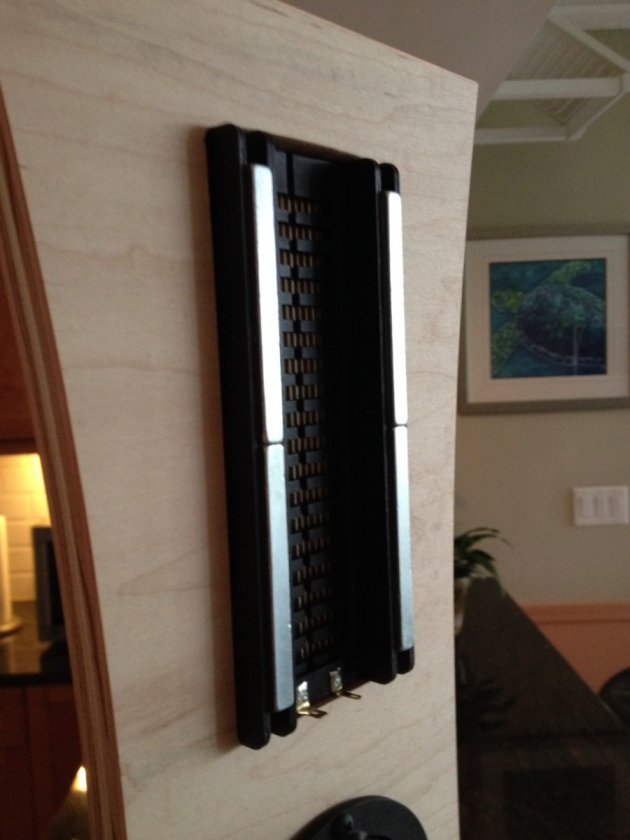

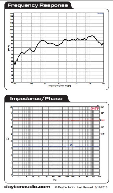

High Frequency: This is my first design to make use of a true dipole HF radiator. The Dayton AMTPRO-4 air motion transformer tweeter comes equipped with two thick felt pads that can be removed (friction fit) for open back radiation.  The pleated diaphragm squeezes air which results in a very open and airy presentation. It is known to sound very “fast” and articulate and compliments dipole bass nicely. The radiation pattern (both front and rear) differs from that of a typical dome radiator.

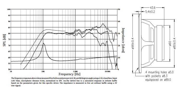

Mid Coupler:  The Seas FU10RB H1600-08 was selected as the 4” mid coupler in this design for its acclaimed “Curv Cone” woven polypropylene properties.  This driver is very similar to the mid coupler used in the Linkwitz LX521 but with an 8 ohm impedance rating. The higher impedance lowers the cost of the associated passive crossover components in this design and the higher Qts of the mid coupler facilitates a passive compensation approach.

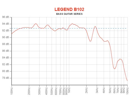

Lower Midrange:  In keeping with the lessons learned from the Hestia Forte design, Drivers manufactured for guitar/bass amplification can at times make great candidates for OB.  These drivers are often voiced for guitar players who favor a mid-scoop in their presentation.  If selected carefully, this particular voicing can be useful in compensating for dipole roll-off.  By targeting the roll-off correctly within the scoop, you are essentially left with a beneficial low end tilt without active compensation or additional passive components.  Contrary to the mid coupler above, I favor this approach to selecting a lower midrange driver with a high Qts. The driver’s motor keeps tight control over the cone, and unlike some other high Q drivers, the upper bass and lower mids are never sloppy.
These drivers are also typically about 5-10 dB more sensitive than their home hi-fi counterparts. The real challenge is finding a driver with the right combination of the above characteristics, along with a workably flat response, a reasonable excursion, and a slow or delayed breakup mode.
The Eminence Legend B102 is one such driver that incorporates a well vented cast frame and comes in at 93 dB 1w/1m. It has reasonable excursion before damage with XLim topping out at 8mm.  It also happens to sound very nice as it handshakes with the Seas coupling driver due in part to the whizzer cone design. While the crossover starts attenuating this driver’s high frequencies early (down 6 dB at 280Hz and 12 dB at 560 Hz) the gradual first order slope still presents significant amplitude in the area where the secondary cone has some impact on clarity and detail. And unlike some guitar speakers that are designed to be overdriven easily, the breakup mode on the B102 is more akin to a pro sound driver than a guitar speaker.

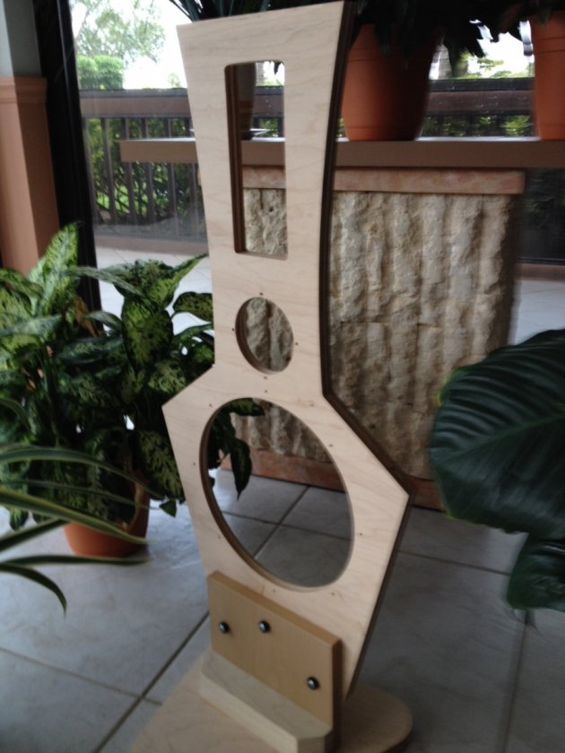

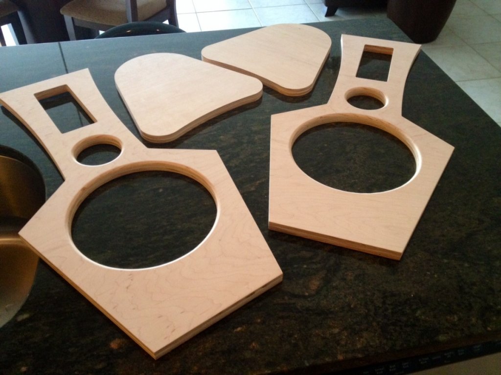

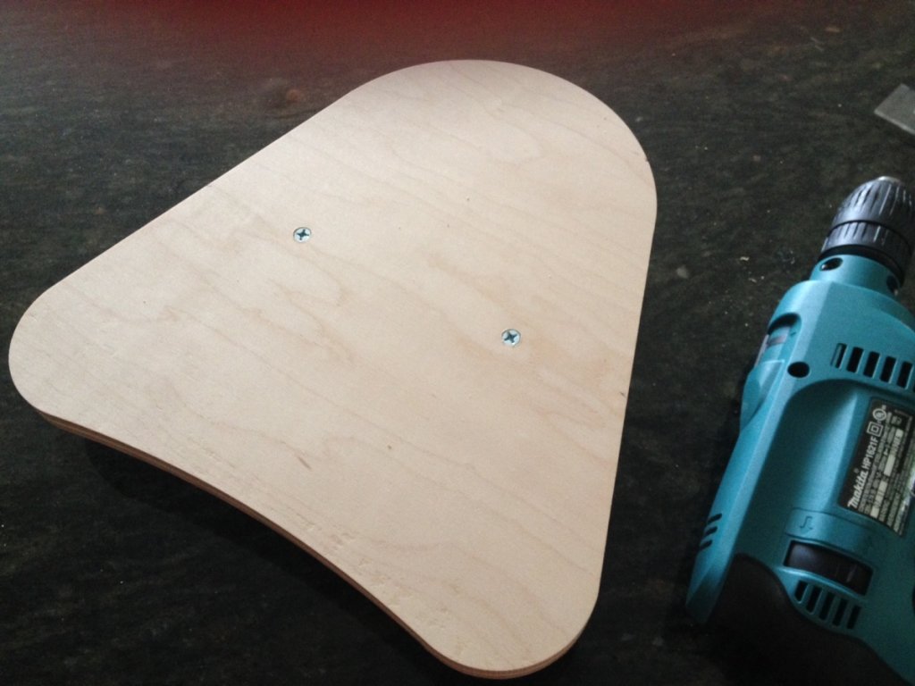

Baffle Fabrication
I have teamed-up with Melby Audio to offer first rate, CNC milled baffles for those wishing to build the design. Weston is an avid craftsman and an audio enthusiast as well. He can mill the baffles, bases, and intermediate parts and then ship them to your door as a "flat pack".  He also offers a variety of finishing options. His work is truly first rate and very reasonable.  PM me if you would like his contact information. (Please understand that I have arranged for this service as an enthusiast and do not profit from his work).
The standard baffle material is 19mm ply with a maple face, as seen below. Other options may also be available.
Melby Audio is also a source for many of the components needed to complete the Hestia V Build. They can offer discounted pricing on the Dayton AMTPRO-4 Tweeters, along with some of the other components you may need for this (and other) projects. As a customer, my experience has been very positive and I would encourage you to give them a try. I also believe in supporting the few "mom and pop" audio businesses that remain!

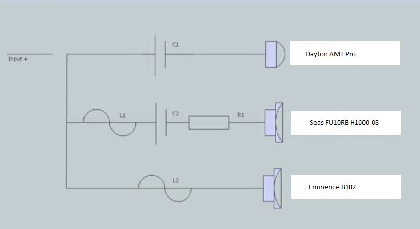

Passive Crossover
The crossover topology is similar to the Forte. I am using even higher quality components as it really makes a difference with drivers of this quality. The basic layout is as follows, along with the initial component values.
High frequency section (Dayton AMT Pro)
C1, Mundorf Supreme Capacitor, 1.5 uf
Mid Coupler (Seas FU10, 8 ohm)  (inverse polarity for flattest response @ x/o)
L1, Erse .27 mH, Perfect Layer Inductor, 18 AWG
C2, Mundorf MCap, EVO Oil cap, 5.6 uF
R1, 5.6 ohm + 3.9 ohm Mundorf MOX Resistors (in series)
Lower Midrange (Eminence B102)
L2, Madisound "Sledgehammer" 15AWG Inductor, 8.0 mH
Please note: While the crossover topology will not likely change, the drivers themselves are still new and are settling-in. When the drivers reach their final TS parameters some small value adjustments may be necessary. They have remained stable for the first +/- 20 hours of use.

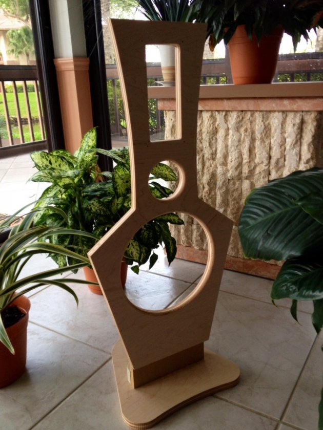

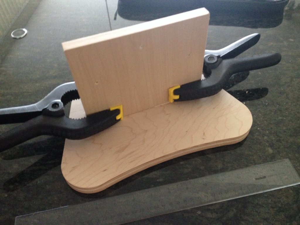

Here's a few more pics of the baffle/base detail, before adding drivers:

Cool!
You didn't need any padding on the tweeter?

Cool!
Good question. The Dayton AMTPRO-4 is rated at 94dB. I can only assume this measurement represents it's sensitivity in cardoid mode since it is somewhat less efficient as a full dipole. The driver comes with two thick felt pads saddled between two powerful neo magnets in the back. Both pads together make up a thickness of about 1/2 inch and block nearly all of the rear wave.  In this mode the driver approximates a cardoid pattern and is more efficient. With both pads removed the rear radiation pattern approximates that of the forward pattern (inverse) and the driver acts a s a dipole, albeit somewhat less efficient.  BTW, using only one of the two felt pads seems to yield a hybrid mode which may be helpful for dipoles that are placed too close to the rear wall since some of the rear wave is lost.
That being said, the drivers are still settling-in and I have tested both no attenuation and a small padding resistor (1-2 dB loss). At this point I prefer no padding at all.
« Last Edit: 13 Jun 2014, 11:27 am by matevana »

« Reply #9 on: 13 Jun 2014, 10:18 am »
That baffle looks like it would vibrate like crazy with those large drivers. Seems like it needs more bracing in the rear.
I like them alot, just seems like they would vibrate.

With regard to the AMTPRO's efficiency, note that amplitude is lost here as well when the driver functions in dipole mode and the rear wave is allowed to exit freely.
Thanks for the comment. I haven't found this to be an issue, at least at normal listening levels. Perhaps this is due to having very limited baffle real estate away from the driver cut outs. All three drivers have a rigid cast frame and really help keep the baffle well dampened and stiff. The 19mm plywood that was used in this build seems to have more alternating layers than I remember seeing at the big box stores. It is also void free. I would say this plays a role as well.
Still though, I would recommend placing the top baffle on a support that straddles the bass cabinet, similar to the LX521 design. This seems like a good way to keep vibration from the bass drivers from impacting the mids.

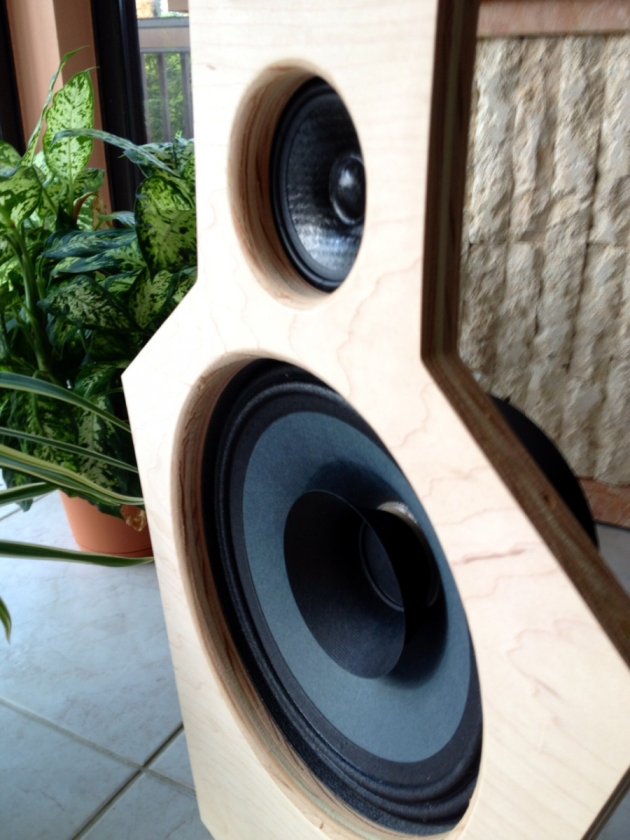

One question. The "mid-coupler" sits on the back of a thick baffle. That should affect the dispersion at the front of the Seas driver as it fires into a short tunnel. I would think some off axes measurement issues or horn "cupped hands" shout would be noticeable. Is there a reason why you did not front mount this nice little driver on the baffle?

Nick, that too is a great question. I have spent many hours listening to the FU10 as both a front and rear mounted driver on the baffle. First off, I haven’t experienced the “cupped hands” effect in this design (but definitely have in others so I was always very conscious of listening for midrange shout). The baffle front has a rather large 3/8” round over on a fairly tight driver cut-out. I believe this helps mitigate the effect you speak of.
But I had a bigger concern with the effect of linear and non-linear distortion if the rear of the cutout was not addressed properly, considering the physical design of the FU10’s magnet and motor structure. This phenomenon was noted by Zaph when he reviewed the Scanspeak 10F which is constructed similarly. As a design choice, I chose to eliminate this concern altogether by rear mounting the FU10 for a truly unencumbered rear exit. The alternative would have been to design a large chamfer on the back of the baffle, which would have necessitated further than ideal driver-to-driver spacing and may have structurally compromised the baffle at it's narrowest point.
