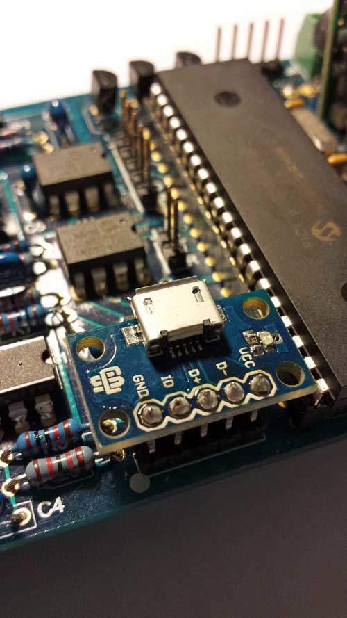

Our software update/download page is now live on our website for the new ldr3x.V2 preamp controller board.  :thumb:
We encourage owners of the V2 board to update their software to the latest version. This is especially important for those with the earliest versions 1.0.0 through 1.0.3 of the software since numerous bugs etc. have been taken care of since initial release. We anticipate that updates will slow down substantially over the next few weeks as the product matures. Announcements of new releases will be posted on this forum.
Please note that owners of dual V2 boards used in balanced audio configurations need to upload software updates separately into each board.
The software update/download page can be found here under the Support menu: http://www.tortugaaudio.com/downloads/
More info on the LDR3x.V2 here:  http://www.tortugaaudio.com/product/ldr3x-passive-preamp-controller-version-2/
The pic below shows the micro-b usb port on the V2 board that's used to upload software revisions.
