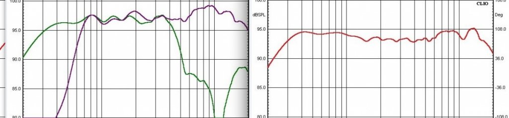

Why do these look different from start to end?   Seems like the top end is 5 db down..???
The right one is last total measurement and the left one is the first measurement taken?
The one on the left was taken with an input greater than 1 watt, and it was a measurement of the drivers playing full range with no crossover.
