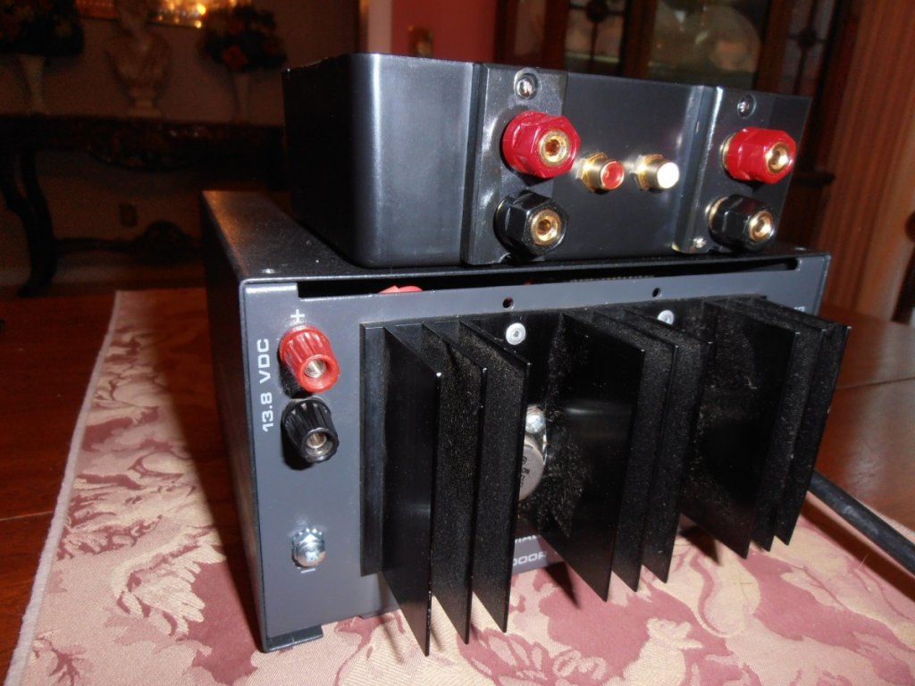

To conserve shelf space I'm considering attaching a TPA3116 in a case on top of an Astron RS-12A.
Thinking I would run new internal leads through the top of the Astron to the TPA so as to avoid the external screw down connections. How does this sound?
Am I correct to assume Astrons store lethal voltage even after being unplugged?
I just got an Astron RS-12A, got a reasonable price so I went for it.
I don't think it would have a lethal voltage, it is likely to have a transformer with 115V in, and maybe 20V or so out.  It doesn't need more than that to generate the 12-15VDC the supply can generate.  And the higher the voltage out of the transformer, the more heat it needs to dissipate, so it is unlikely to generate a very high voltage.  This applies to linear supplies, switchers are different.

Here's the TPA3116 siamesed to the Astron RS-12A power supply.
Amazing transformation of an already good sounding little amp. Next I may try mounting it inside the Astron.
