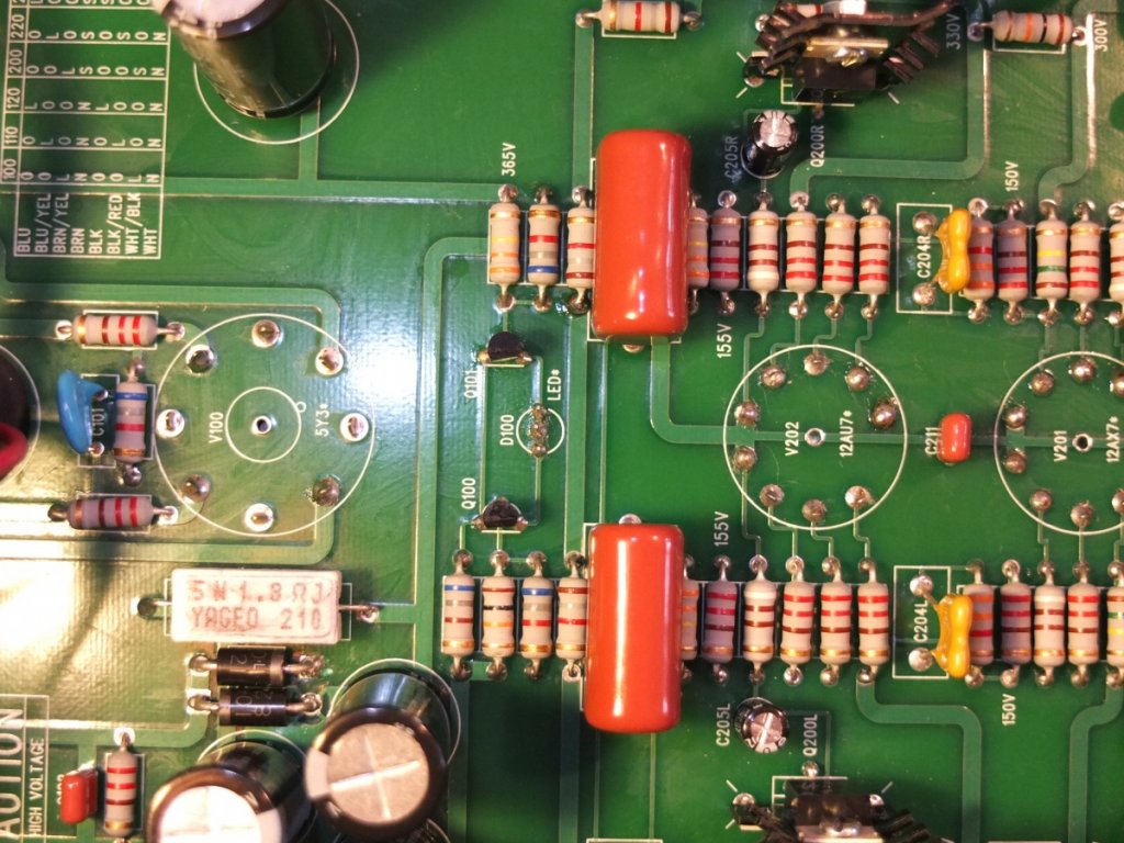

If you have sound from the device - basic voltages are OK. Reversing LED is out of scope as you have already mentioned. Cold joints are possible, but it seems (taking into consideration that all other joints are working first time) not the source of the problem. You maid have soldered Q100, Q101 incorrectly (I mean wrong base-collector-emitter placement)? Could you check this?

I've checked positioning of Q100 and Q101 - seems fine.  I've also resoldered.  Still no working LED.

Yes, it is possible to check the transistors. Before that - could you post the photo of the LED's area including the transistors?
If you have multimeter - could you measure the voltages across R106, R108, R104 and from both anodes of LED (outer pins) to the ground (inner pin or grounding post)?

I'll try to post a picture in a minute.
John
ticket
  • Posts: 16
