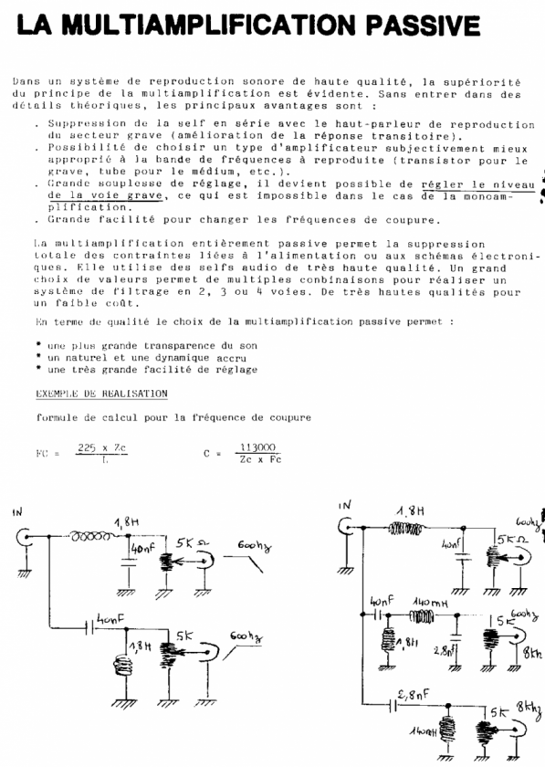

Long time ago there used to be someone with a virtue one or two. I did buy my sensation 901 secondhand in the States and now there is a satisfied customer with a 451 as well in The netherlands.
I am seriously thinking about getting some more virtue gear to imp[rove my bigger system. But i would like the input impedance to be higher because i wanna use it with a filter like this between preamp and amp
YES it is in French.My preamp has an output transformer with low impedance output. But there has to be a cetrain ratio between output and input impedance to make the filter work. Using tube amplifiers will give you high input impedance but with solid state it might be to low. Maybe i must look for a transformer to have a better ratio between the 2 devices. The new virtue circuits being so small i can put them anywhere where the influence of a little mismatch would be very minimal.
Sincere greetings, edward
