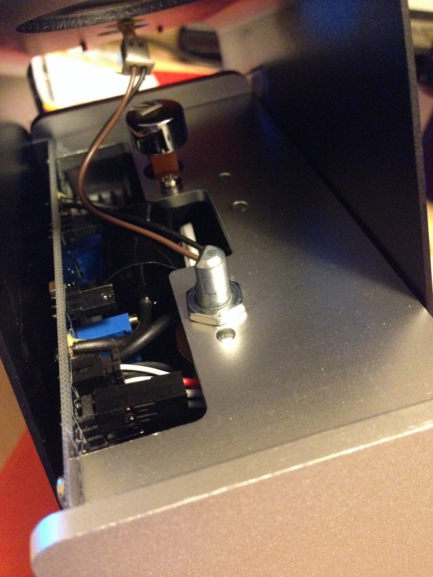

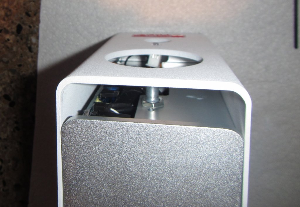

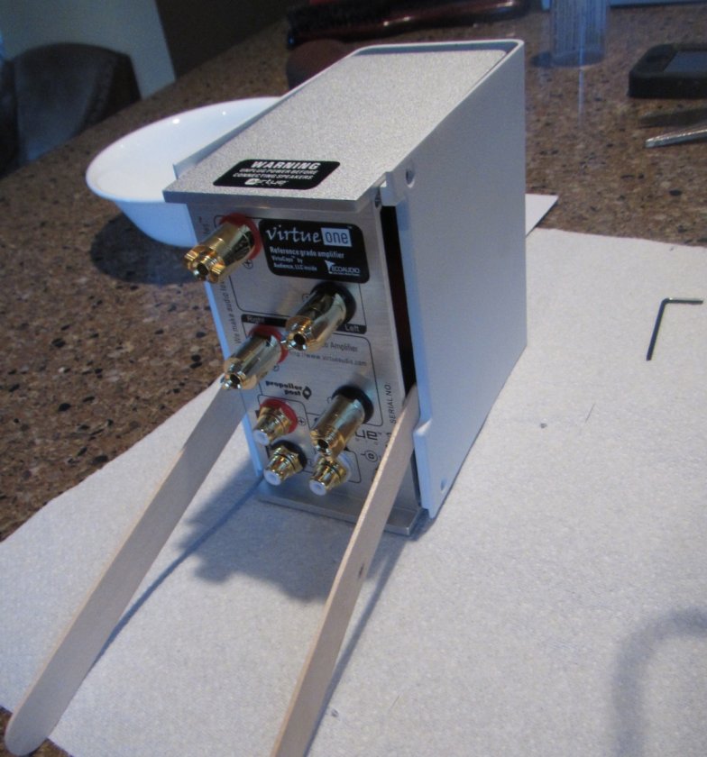

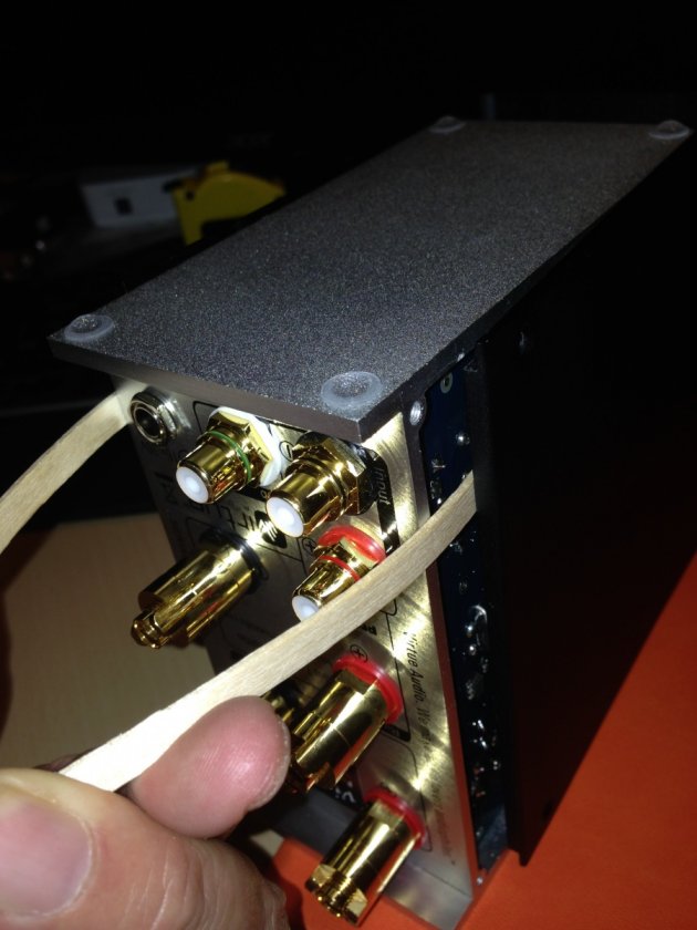

In other news, I found a great way to hold the wrap open while sliding it back on if you don't have access to a beefy wooden Popsicle stick: wooden coffee stirrers from Starbucks.  Please note that there are some delicate caps under the board (special, French AVX film caps) that can chip and break so be careful back there).
I'll start putting them in the boxes from now on.
Also, to Ian's point about the LED legs.  On this board, the LED is soldered to the Pre-amp board... so the only way to get it off is to bend the long leg straighter, pull off the plug fixture, and then push it back on when you're finished.  But you definitely don't need to do it to tighten the knob.  You would need it to mess with the jumpers and/or change the subwoofer gain.  If you need to do that, please fiddle with the top off but don't touch the boards while plugged in.  Low voltage but your fingers (and tools) can short stuff.

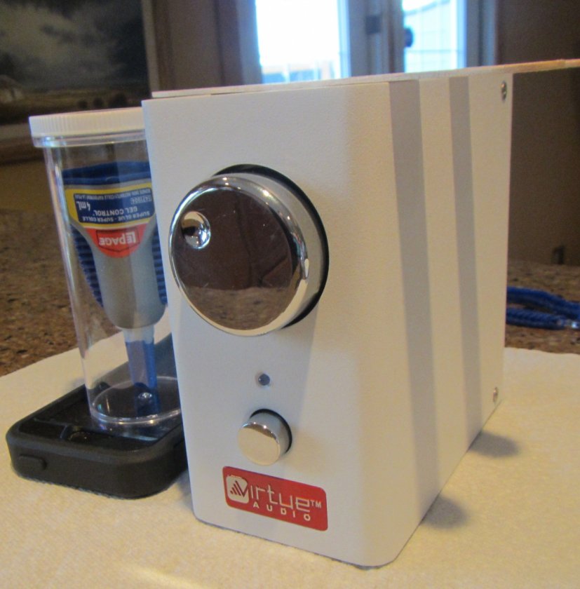

I set up my ONE.3 kit yesterday with Mission M71 speakers and Orb Audio Super 8 sub, it exceeds my expectations !
Thanks to Seth - I am vey pleased with my ONE.3.
Also, thanks to the folks that post here as I have been reading up on Virtue Audio for about 2 years - mostly on this forum.
I tightened my volume button today - the posted suggestions worked perfectly.
thanks again from Canada!
