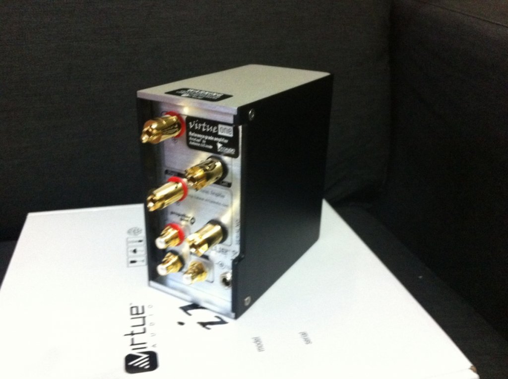

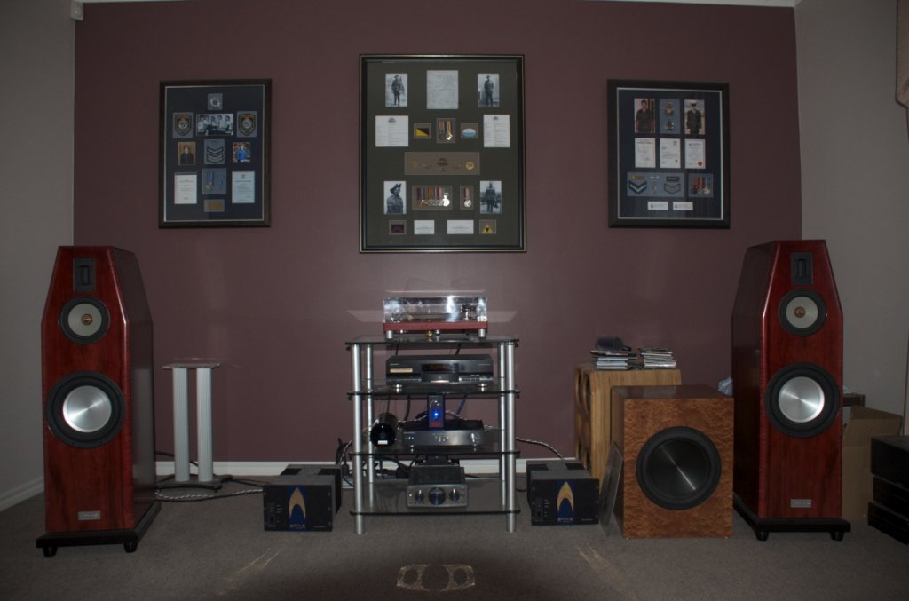

Well I'm a bit surprised but the Virtue One.3 arrived today from Taiwan. I did mention that we were roughly in the same vicinity of Taiwan but I didn't expect the amplifier to arrive today.  Anyway I hooked the amplifier up to my system and I have to say that the amplifier sounds far better than its asking price.  Surprising it is driving my 84db @ 4 ohm speakers quite well and the bass is quite impressive.  It makes me wonder why I spent so much on my amplifiers.  The fit and finish of the amplifier is also quite good.  The only minor issue that I can see is that the blue led is too bright for my taste but really its only a minor issue.

I can always blacken in the led or use blue tack to cut the light out all together.  If you look in the background behind the Salk Sound HT3'S there are a couple of pairs of Nuforce s9 speakers.  These are the speakers that I'm going to use with the Virtue One.3 and my iMod and I think the combination will sound quite nice as the speakers are about 87 - 88db efficient and I also have a Salk Sound rhythmic subwoofer I can use as well.

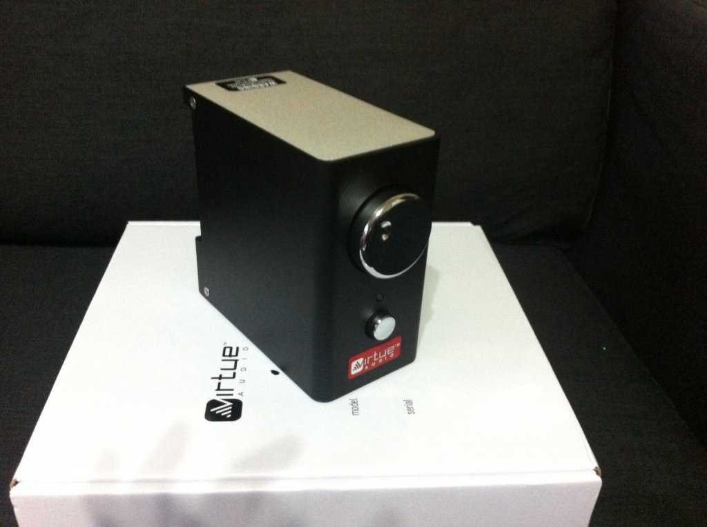

Been listening to my first production unit today!  A bit veiled but very nice!  Can't wait to see how it breaks in.

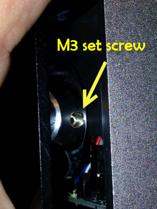

On the unit that I have the volume control knob is slightly wobbly.  It won't pull off but tightening it is not trivial.  You would need to remove the cover, remove the LED, and using an M3 allen-wrench to tighten the set screw on the knob.  It is intentionally inaccessible (so you can't see the screw) on the knob with the cover attached.  For my own unit, I decided it wasn't worth the effort.
Update:  It seems as though the screw was tightened very well -- creating quite a large hole in the flat part of the volume knob -- which subsequently loosened.  A big of tightening works like magic.  Good news!  You don't need to remove the top entirely.  Loosen 4 hex screws on corner of the unit and slide the cover back 1/2".  Rotate the knob, to expose the set screw.  Use same M3 allen-wrench to tighten the set screw from above.  Sliding back the cover is a bitch because of the spring action fit.  Find 2 non-metallic (non-scratching), stiff, flat things to spread the wings before you slide it back.  Be careful not to damage the back of the PCB.  I used some old PCB boards (fiberglass) but Popsicle sticks would work perfectly.

The volume position changed in the new version.  It was a detail I lost track of when we had the new knobs machined.  My vendor actually did bring it up during assembly and I let it go.
Now that there is an active pre-amp in the unit, you would rarely turn it all the way up.  Even a half turn may be too much in some cases.  So the reference position is less important in my opinion.
If you loosen the set screw enough (mostly out), you can actually turn the knob all the way around and clamp it onto the round portion (not the flat part).

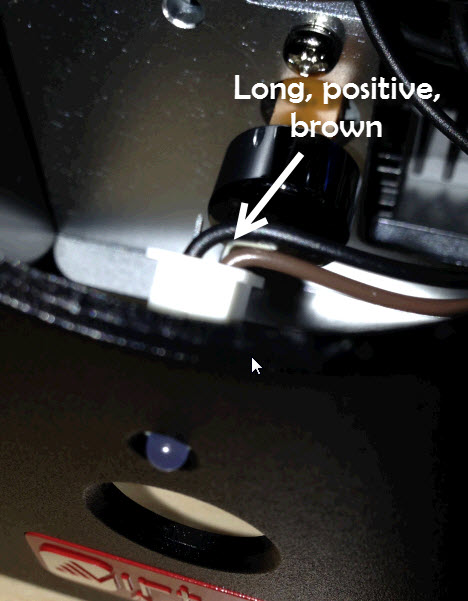

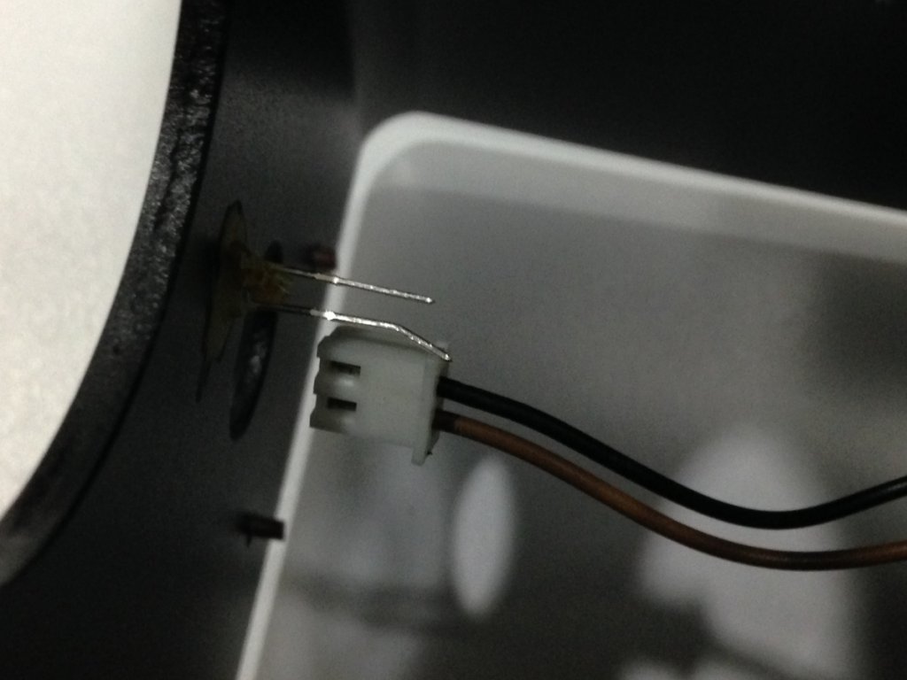

Hi Seth,
Whilst tightening the screw on the volume knob, i accidentally pulled off the connector to the LED light.  Do we need to reconnect them back in a black/brown order?  or doesn't make any diff?
