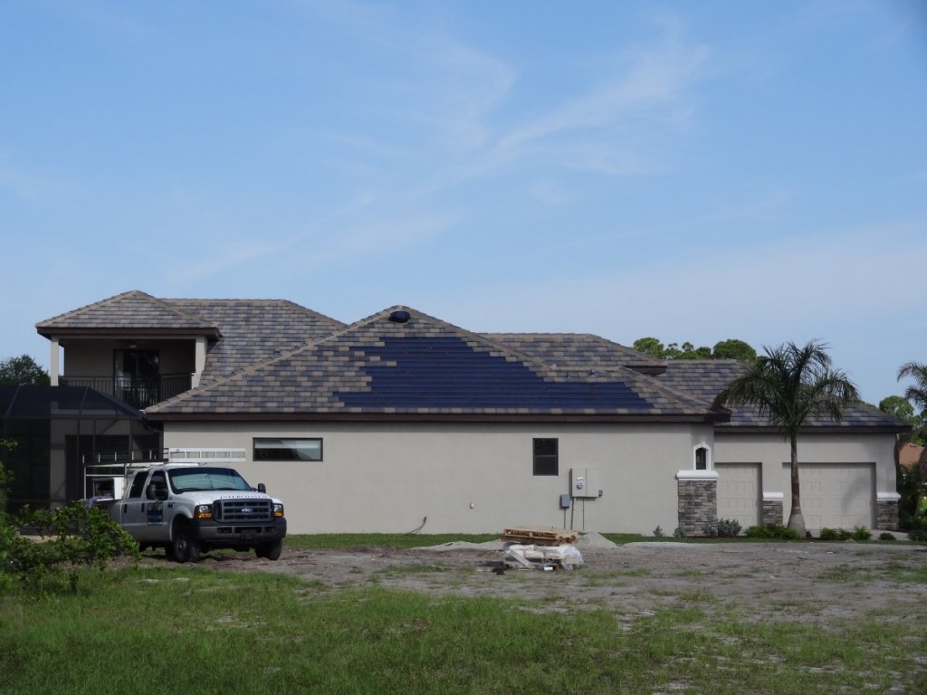

Central FL East Coast.  8.6KW.  The house came with solar water with electric back-up which is also part of the 30% residential energy credit - http://www.irs.gov/pub/irs-pdf/f5695.pdf
The panel system (pic below - there are more panels on the back roof) is integrated into the roof tiles.  The cost before any credits was about $43k.  It will be less of course after credits.  I'd imagine that it will save about $2k/year in electric costs so it may be a 13-14 year period before the costs are recovered in full.

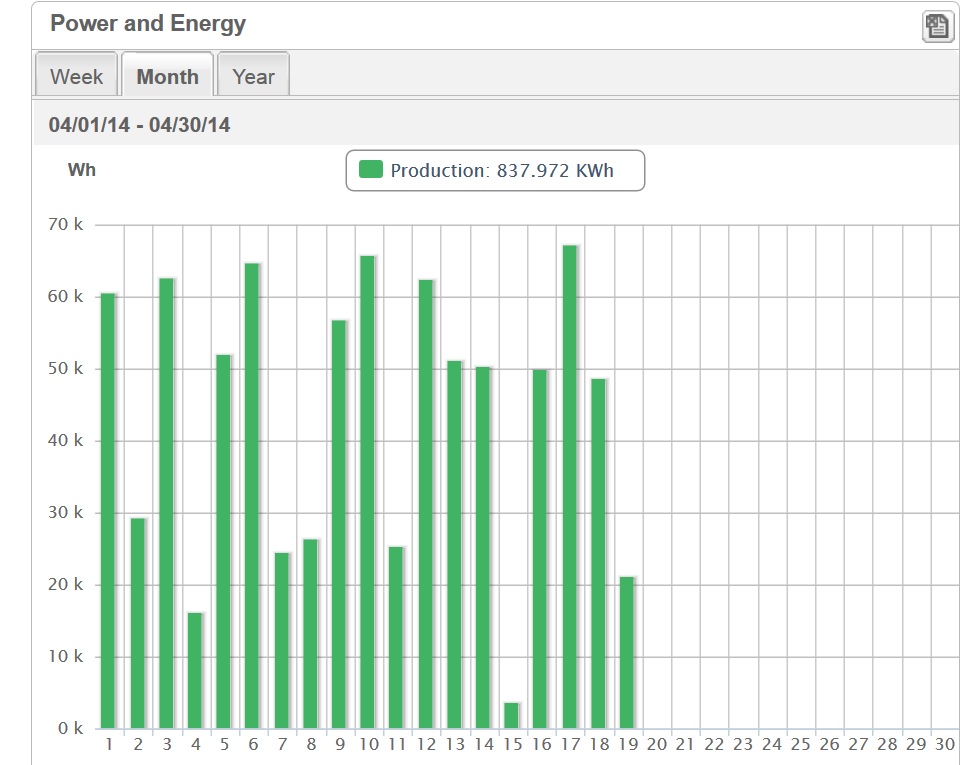

Here's what the power output from my 11.5kw solar system looks like in CT for April 2014.  It varies from about 3.6kwhr/day to 67kwhr/day. 838 kwhr this month so far, which should be more than we are using. Once we get to summer, the AC and pool pump will add way too much electricity usage and we won't be able to generate enough.
