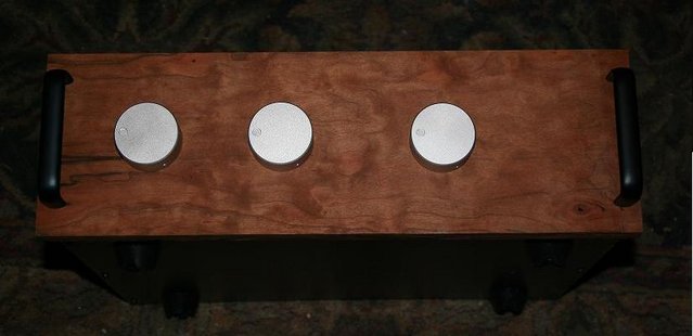

I really like this concept for a preamp, except that I think I might modify it somewhat making it more Raven like.  http://www.nutshellhifi.com/Raven-MarkII.gif
Essentially making it a differential preamp.   This buys me a few things.  #1 can be used with both single ended and XLR inputs/outputs.  I have both in my system.   It lowers the Zout by half and I want to be able to run 15' interconnects between my preamp and amps.  I have many if not most of the parts sans the output transformer and I have a large preamp chassis to do this in.
http://www.audiocircle.com/image.php?id=9454
In that chassis (lots of room) I have six RCA inputs, but can easily change two to XLR and dual RCA outputs, can add XLRs.   It uses Silk Audio TVCs
http://www.sacthailand.com/Transformer_Attenuator.html
So I'll need to do some modifications.   The question is whether to use it on the output like Thomas Mayer does or at the input.  I have Jensen input transformers unused at the moment, so I could use those at the input instead.
