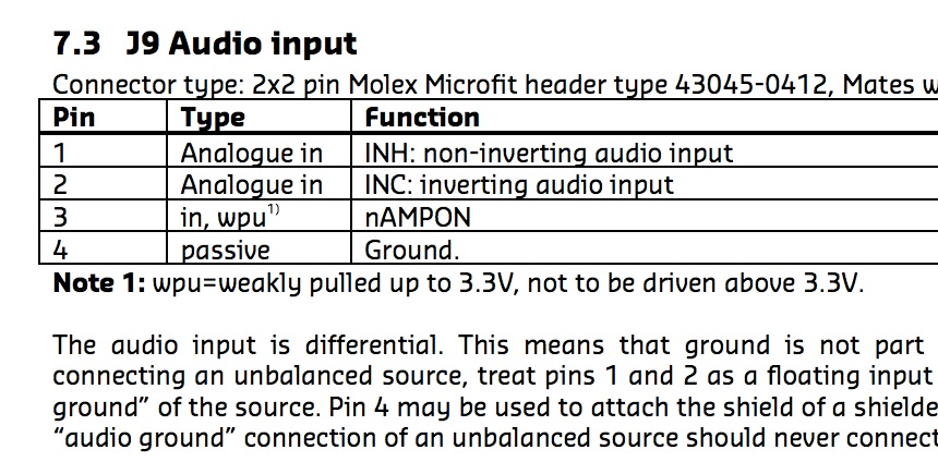

The thin cable is nAMPON - if you ignore it, the amp will not turn on. You have to connect it to ground. Pin 1 is non-inverting and pin 2 inverting input - again, absolute phase doesn't matter, so yes, connect them to the balanced outputs of your DAC.

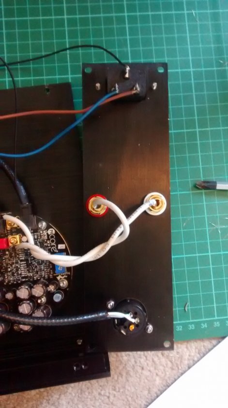

OK I have finished wiring I think. Can someone take a look and tell me whether I can now connect up and switch on?
zenpmd
  • Posts: 160
Re: Newbie Help - Ncore build
« Reply #71 on: 3 Aug 2014, 06:49 pm »
I switched it on, but nothing. Checked signal to DAC and its fine as headphones work. Speaker just gives out a hum. Any ideas? Thanks
Do the lights come on the NC400?
zenpmd
  • Posts: 160
« Reply #73 on: 3 Aug 2014, 07:08 pm »
There is one red light?
jtwrace
  • Posts: 11433
    • TIPP YouTube Channel
« Reply #74 on: 3 Aug 2014, 07:13 pm »
It's been a very long time since I've had NC400's but there are lights so that's a good sign.
Pin 2 is hot on the XLR.  You need to make sure that you have that correct.  Also, the black wire that's on the input loom goes to chassis ground.  Make sure that's connected as is the XLR ground to chassis.
Also, make sure the ribbon cable and other loom with the large molex connectors is really seated into each module (NC400 & SMPS).
MAKE SURE UNIT IS UNPLUGGED!

All the info is in the datasheet.
If you have a DMM and check continuity it's really simple.
Lets get it working first and then we can tidy up the build a little.  You want the speaker wires on the NC400 to enter the posts from the same side.
srb
« Reply #76 on: 3 Aug 2014, 07:27 pm »
I would also check that your speaker output binding post insulators are correctly installed and working so that there is no short to ground through the chassis.
Steve
zenpmd
  • Posts: 160
« Reply #77 on: 3 Aug 2014, 07:28 pm »

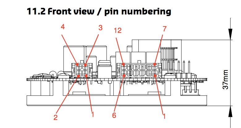

that diagram is meaningless, as there is no way of telling which cable comes from each pin!?
What is pin 4? There are only three cables coming from that connection: positive, negative and Nampon. And hypex does not even seem to say which out of the blue and white is positive (hot) or negative (cold).
What I have done is as per the photo, I cant really explain it because I have no idea what I am plugging where, as Im doing everything by rote.
zenpmd

That diagram is all you need!  Did you use a DMM as I suggested?  That will help you a bunch.
Also, there are four wires in that loom.  Blue, white, black Nampon and the shield.  You need them all.
