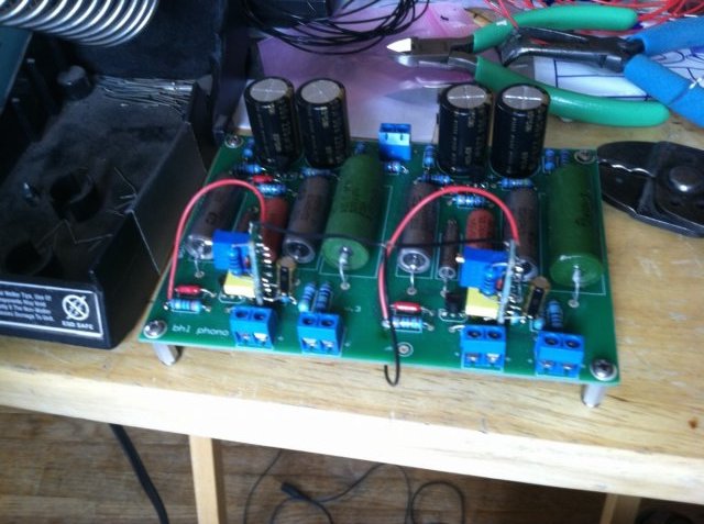

I can't make my iphone or gallery photo make that upright... Sorry.

Scotty, it's not a DAC, I'd be surprised if those sound better than the Muse.
Good news, it's much quieter than my Bugle. It's better in the first minute, and my Bugle is tricked out. The RF is vastly lower.
The gain could be a bit more, but I wouldn't consider not replacing my Bugle because of that.
As you can see signal is LDR and PRP on this BH. It's not stock, which would be mediocure with cheap input resistors.
I can't comment on not burned in stuff to much, but it sounds like wonderful upgrade. Improved imaging and harmonics. Mids are laid back some, but voices are prominent.
By the way the seller is very good to communicate with.
P.S. The LDR power wires are longer because you have to unsolder one leg to set them.
