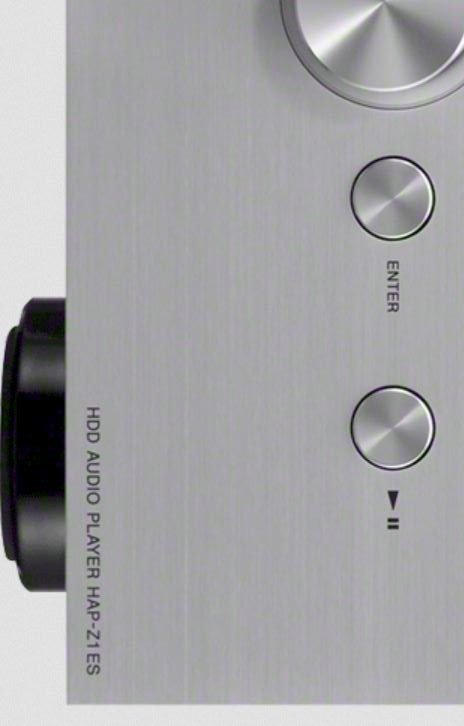

Speaking of front panel, I think I found a misprint.  :o   The model number on the front panel is HAP-ZiES, but everywhere else (website, manual, etc), it is HAP-Z1ES.   No big deal... just thought I'd mention it.
The pictures I've looked at read HAP-Z1 ES.  Either you have a rare misprinted one or perhaps there is a bit of missing silkscreen paint in the middle of the  "1" making it look like an "i"?
Hi srb,
Well, this unit (smargo's) is definitely an 'i" - so I guess his is going to be a rare, collectible edition version!  :green:
