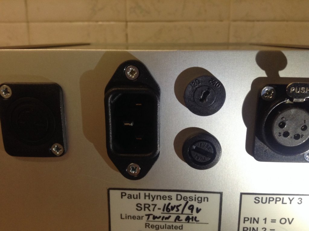

  At this point I stuffed up by plugging it in to give it another try on the Weiss.  I had unknowingly reset the power to 120.  Apart from the size on the plastic screw slot these things look identical, until you put a torch light on them and see the 120 240 on the upper plastic button.  It's really easy to miss, particularly when your brand new power supply isn't working ( I should say that the 16v rail had been working fine, only the 9v was missing in action).

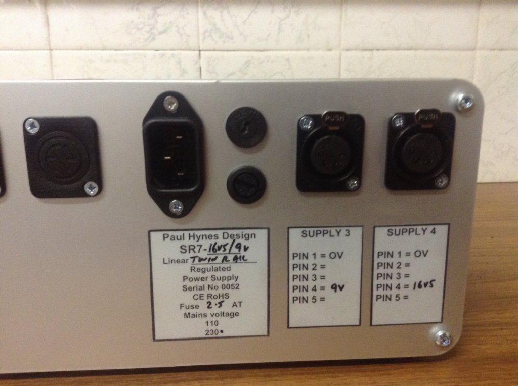

Can you post a picture of what you're talking about?
Briz Vegas
  • Posts: 17
Ha.  You got in before I could post a picture.  The power selector is above the fuse to the right of the power plug.  There is some burring on the selector as it is soft plastic and my screwdriver was a little small.   They are labelled but it's cut into the plastic so it's hard to see in artificial overhead light, particularly for those of us over 40.  I only saw my error when I used a torch light.
Briz Vegas
  • Posts: 17
Better photo.  This is why I needed a torch.

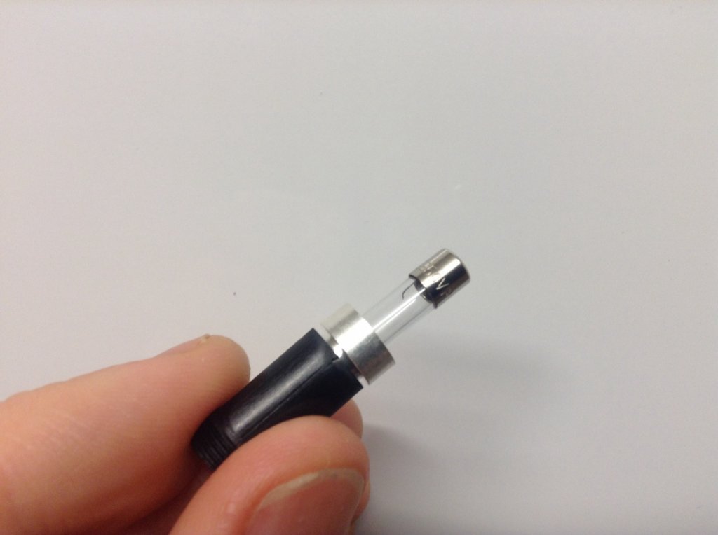

Hey, I might be in luck here.  It's not what I have seen in the past, blown fuses are usually blackened, but this fuse filament looks broken to me.   Fingers crossed on this one. :o
wisnon
For me blown fuses are normally just broken internal wire like you show. Whew, likely you dodged a bullet there, but still you need to repair the 9v rail.

All sorted.
The new fuse has the unit up and running and the 9v issue was diagnosed by a local tech at my hifi store.  Turned out to be a transit related issue at the units 9v power connector and not unusual given that the SR7 is built with audiophile performance in mind, or at least that is what my tech guy told me ( it's the sort of solder used apparently). There was also a fit issue with the plug for the Weiss at the end of the supplied lead, which was just one of those things.

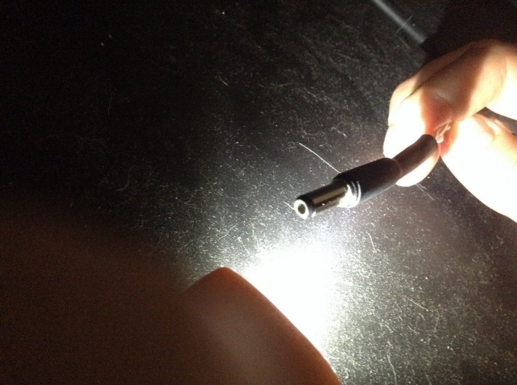

Paul, you asked about the plug size for the Weiss.  This might be tricky as it looks almost identical.  The one you used was just slightly loose,  in that it had a slight wiggle to it, but it was so marginal I didn't think it was a issue until we tried 3 or four others from a set that my tech guy had.  They were all different colours and the one that was snug enough was back.  It has been shrink wrapped so I can't see any numbers.  ( looks like I need to do some dusting)
