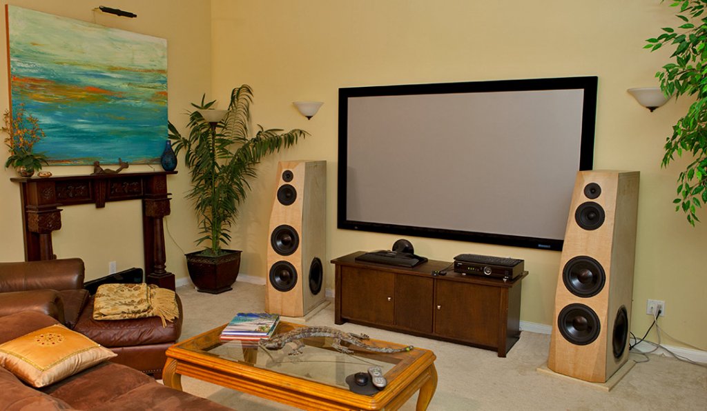

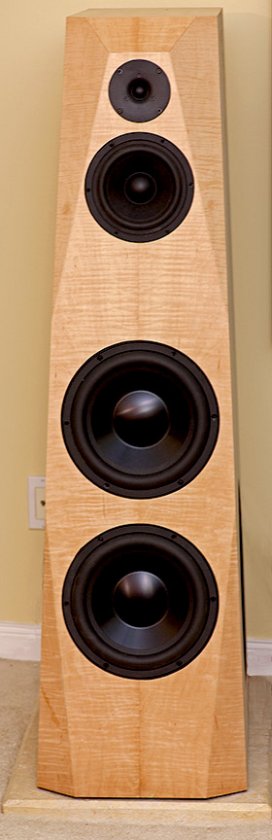

The project has moved forward and here are some pics.  I still get to finish the veneer on the sides and apply some finish.  My friend Dave and I built the cabinet between the speakers a few years back for another place. I might have to upgrade and build a bigger new one with Curly Maple to match the space and speakers.

Very nice build, congratulations!  What kind of veneer is that?  It's beautiful.

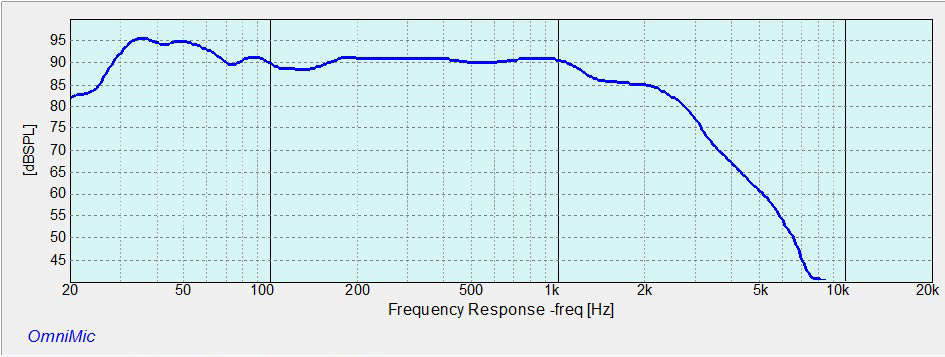

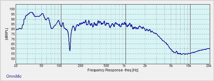

I've had an opportunity to work on the crossover and it is getting pretty well dialed in.  Phil Bamberg designed the topography for the crossover between the tweeter and mid.  That guy is amazing by the way.  You can check out his web site here if your interested.  http://bambergaudio.com
It was my job to get the crossover between the mid and sub right.  The whole system is working very well.  It's all active all channels.  These measurements are with the tweeter off as I was dialing in the low end.  I'll post complete measurements as I get them.

The veneer is curly maple.  It is pretty cool to work with.  It's in the mid price range.  Not as expensive as burly maple, but has more character than regular grain.

« Reply #32 on: 21 Apr 2014, 12:11 pm »

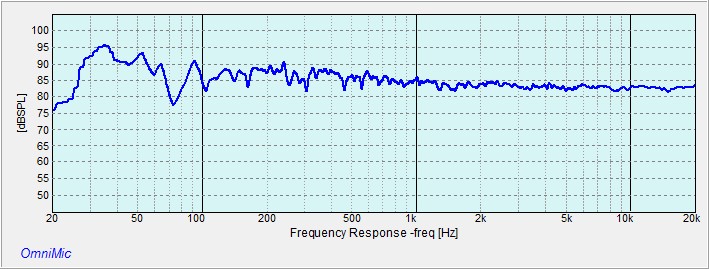

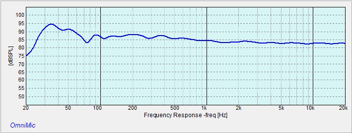

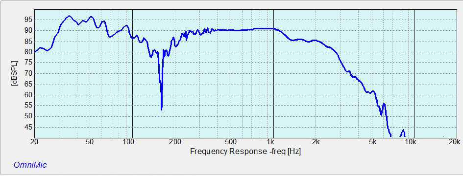

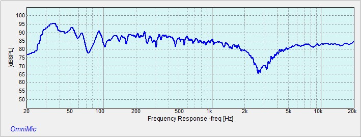

I've had some time to work the crossover and really get an idea of how these things work in the room. This has been a pretty steep learning curve but well worth it.
What I've found is speaker design is two fold.  How do you design a we'll integrated speaker system where all the drivers work together, and then and just as important, how does that integrate with the room.
I've heard that second part from respected designers in the past and I just didn't have an appreciation for how important the room is until now.
The biggest obstacle for this system has been room interactions.  There is a wicked bump at 90hz and null at 70hz that no matter what I do with crossover tweaks or EQ effects the over all feel of the system.  The other part is I am not able to move the system, nor where I sit enough to make any appreciable difference.  Also, I am interested in possibilities of speaker design modifications to minimize room effects rather than jump into adding room treatments.
Not that I am against room treatments. I am not.  What I do want is a design that minimizes the need for them and then see if they are needed at all.
I'm going to start a thread about designing for room interactions that I hope will help me finish this design and have it integrate with the room better.
Here are the latest frequency graphs.   All are done at 1 meter..
