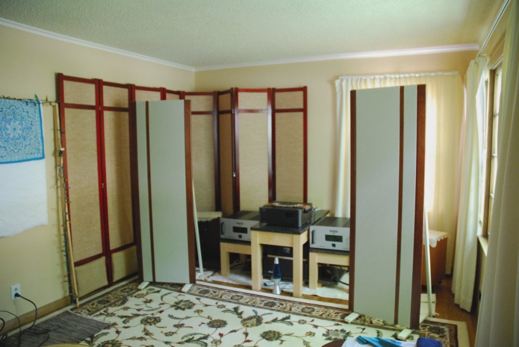

Waker
Re: 20.7s in an 11 X 17 room?
« Reply #37 on: 13 Aug 2014, 08:13 pm »
To bring this thread full circle….
According to the prevailing advice here that my room is just too small, I did not buy the 20.7s.  I have not purchased the 3.7i's, either--still have my 3.6R's.  What I did do was move them out farther from the front wall so they are now 5' out measured from the center of the toed-in panels--lens compresses the room a bit.  Yes, it is a game of inches--the results are dramatic in micro dynamics and imaging.  I just have to slide the couch back to maintain 9-10' of listening distance.
I have also just finished an acoustic treatment for the left side of the room to match the pleated drapes on the right side.  I bought these room divider panels that have a woven jute material. They are 84" tall and have a plywood kick panel, each of which I have upholstered with 2" thick cotton batting, then covered with jute burlap.  The cotton is Applegate, from ATS acoustics.  The panels can be folded either way to add absorption, are free-standing, and don't look half bad, either.  See site "Oriental Furniture" for lots of ideas on room dividers, etc.  The results?  Bass is tighter, detail from left side is a bit better--nothing was made worse.  Even with what were bare walls on the left and heavy drapes on the right, the sound was not bad. It seems the dipole speakers are fairly forgiving in a small room.  Would I go to the 20.7's now?  No, I would rather have the 3 series farther out into the room.  Subs are behind Maggies, lots of gear between--probably detracts from the stage, but room is otherwise dedicated.  Thanks to all for your wisdom on room size.
