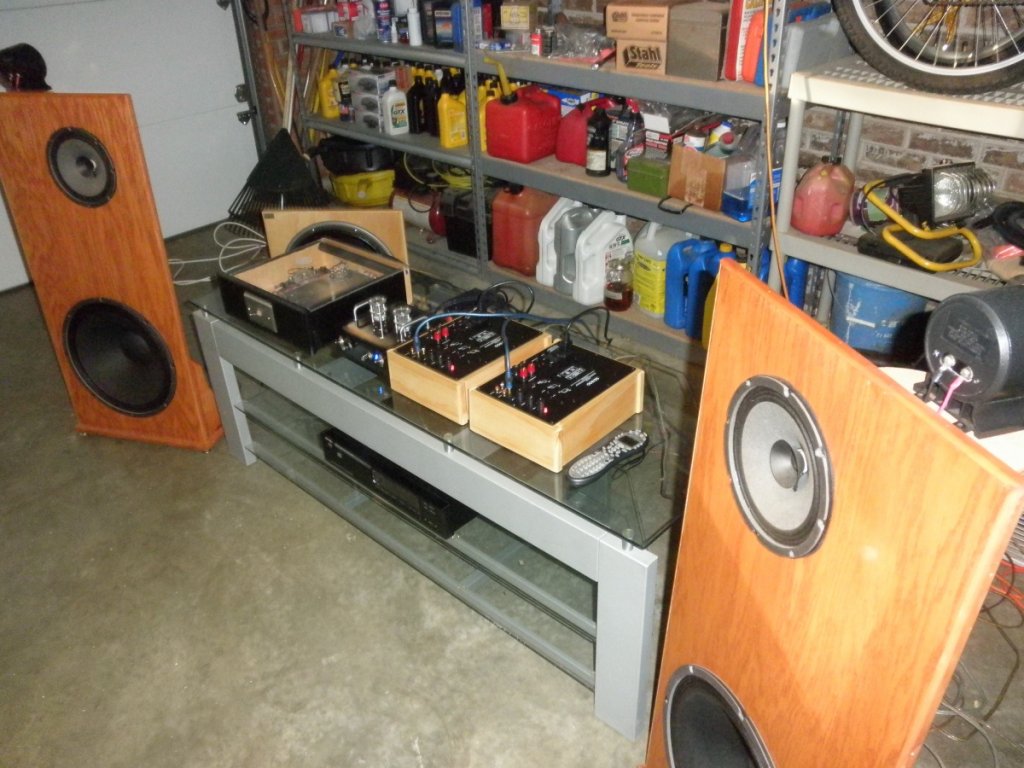

I'm new to OB design but have had good luck and having an awesome time with the approach/open baffle design below.  If you are not happy with the bass response you are getting now, this may be an approach to consider.  It’s flexible and can tailor to your room and driver selection.
Baffle, speakers and amplification
*  U frame baffle : 16 X 36 with 8 inch deep wings, 24 in height.  The depth taken from Martin Kings U/H white paper and used in conjunction with the plate amps xover to achieve a higher cross over point than  plate amp alone can achieve.
* High-freq : Tang band W4-1320SJ with BSC (1.2 mH + 2.2ohm) and cheap cap/1st order to filter bass (147uF at this time).
* bass : 2 MCM 10" pro drivers used in Ed's original Hestia OB design.
* x2 : Yung SD200-6 200W Class D Subwoofer Plate Amplifier Module with 6 dB at 35 Hz.  1 amp for each channel to power the 2 MCM woofers per panel.
Basic design elements
* The key to the design is the combination of a full-range driver that can play low enough to cross over to the plate amp driven dual 10’s.  The plate amp is fantastic and provides the flexibility to adjust the level, xover points and phase.  Can tailor the bass/lower mid-bass to the room.
* I didn’t tweak the 1st order high pass on the Tang Bands much.  Testing values from 100 to 240uF.  Found early to set the high-pass and use the plate amp’s for integration.
Listening impressions
Bass Response:  The bass I'm getting is clean and flat to about 30Hz.  Fast and tight.  Ed's design uses the MCM helper woofer all the way up to about 2K crossed to a 3/4" Vifa.  If it can manage mid-range duties it’s more than adequate for fast bass.  I choose not to go the MJK Alpha route because I tend to prefer mini monitors and wanted better transient response than what a single 15 inch woofer can provide.  I could not be happier with the dual MCM woofers in this design.
Upper bass to high frequencies.
I LOVE the bamboo Tang Bands.  You have the 8 inch Tang Bands so you know how good they can be.  I am listening to the W4-1320’s now but also have the W4-1879 and W5-1880 that I will be trying soon.  I choose the smaller drivers to push beaming a little higher in frequency.  It’s the simplicity of a 2 way design that makes this design work.  Based on what I’ve learned to this point, I believe it would be possible to take any existing 2 way monitor design and throw it on the baffle and adjust the bass units to match.  In this OB design, I had to adjust the BCS so the xover design would need to be adjusted.  Modeling it in Jeff Bagby’s PCD would make it fairly easy and get pretty damn close I imagine.
Like you, I was worried about the bass response I’d get from an open baffle.  But I can confidently say that I just could NOT be happier right now and enjoying music like never before.  I’ve had WAY too many late nights because I could turn off the damn music!!!
Anyway, I hope this gives you some ideas…
Rich
