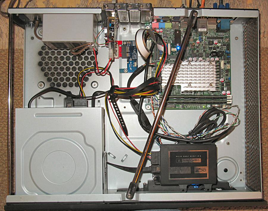

I build my C.A.P.S. server 2 years ago (Dec. 2011) using the Jetway JNF96FL-525-LF board found in the Computer Audiophile C.A.P.S. V2.0. The server has all the power I need and I'm completely satisfied with it's performance. The SOtM tX-USB card was too expensive for me.

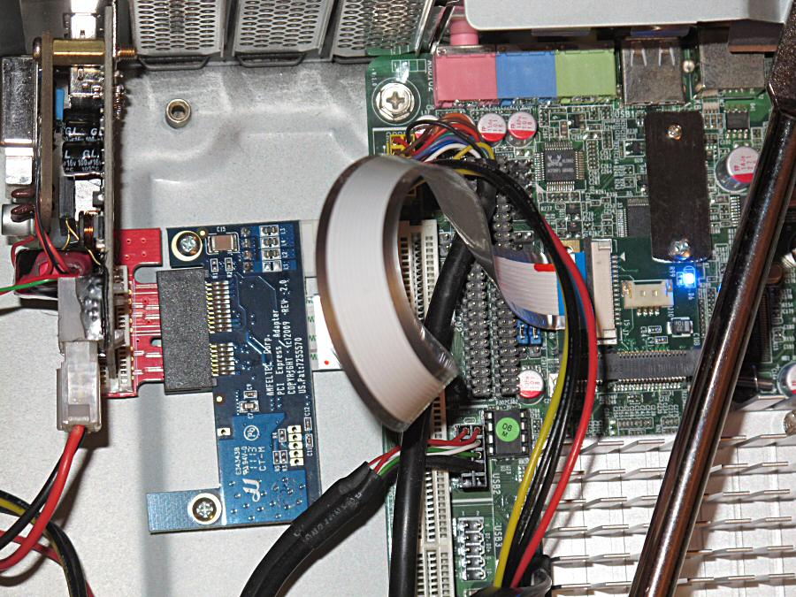

I'm glad I waited to get a card, Paul Pang's card sounds great and it is only $129. I learned a lot too, like a MiniPCI Express slot is different than a x1 PCI Express slot even though they look almost exactly alike. Once I got the right adapter everything worked perfectly the first time. The PPA card is powered by an Acopian 5v 2amp linear power supply from eBay for $20. The Amfeltec Flexible MiniPCI Express to x1 PCI Express Adapter was $55.70 + shipping. The 90 degree riser is a Logic Supply PCI Express x1 Low-Profile Riser Card PCIex1-LPR for $3.99.
Here is what it all looks like put together:
The Amfeltec adapter plugged into the MiniPCIE slot has a cool blue power light.

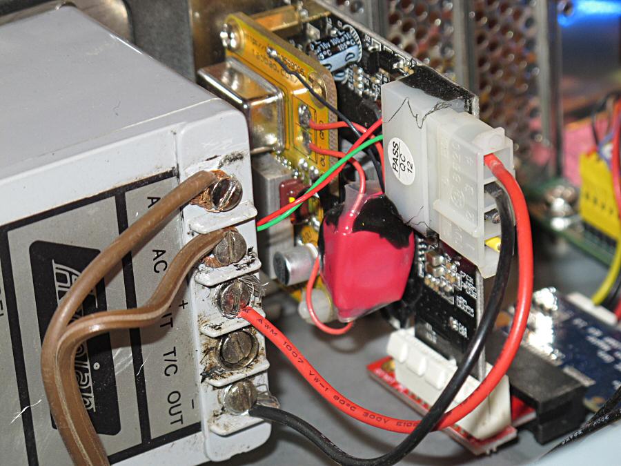

A closeup of the Paul Pang card and power supply, the black stuff on the terminals is impossible to remove gooey insulating tar from the previous owner.
