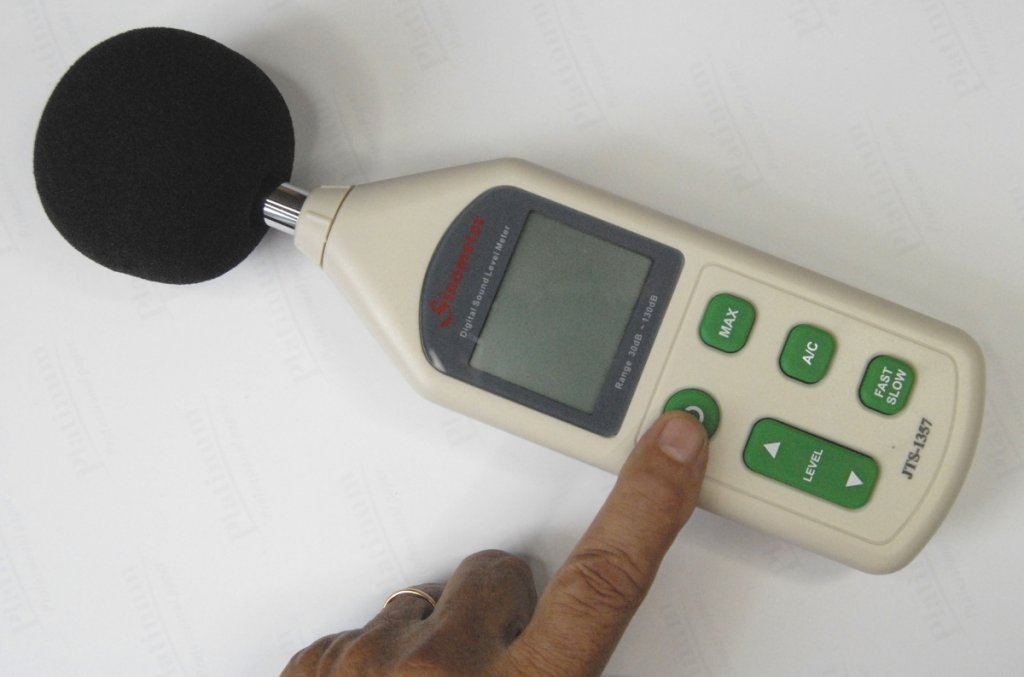

My SPL meter is:
Sinometer # JTS-1357
set on “A” weighted and slow response and 30 to 80db scale.

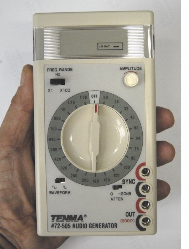

My sinewaves signal generator is:
Tenma # 72-505
20 to 10,000 KHz (It goes higher,
but my SPL meter is limited at 8,000 KHz.

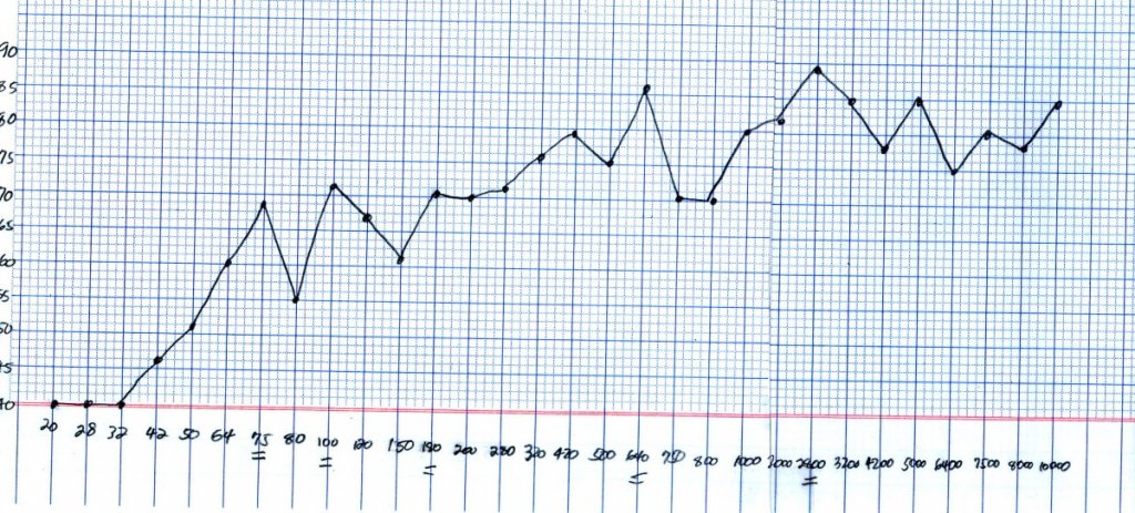

Here is the chart I made from my test.
The problem areas are at 75Hz, 100Hz and 420Hz
The 2,800 Hz is not the room, but the Audio Nirvana 8” full range driver itself.
There it is; any (Constructive) comments are welcome?

This test might be useless to some, but for me it’s useful, as it give me an idea of where the offender frequencies are.
Your test is certainly not useless, but it hides a lot of detail because it only spot checks the response at third-octave frequencies. Most rooms have many narrow peaks and nulls throughout the bass range. The first graph below was measured using the free Room EQ Wizard software, and you can see many deviations in between the standard third-octave frequencies. Another limitation of your measurement is it shows only the raw response, but not "modal ringing" which is just as damaging to bass fullness and clarity. The second graph shows the same data as the first graph, where the "mountains" come forward over time. More here if you're interested:

OK, first please clarify.  You state that background noise is 40 dB, so should your chart be read as 40 dB higher than the stated readings?  (That would place them up to 130 dB, which should be painfully loud.)  If not, how do you have readings below 40 dB?  And how is it that those 4 good sized woofers (not familiar with your speakers) are 30 dB down at 50 Hz?  Do you listen near field (where the mike is shown)?  Why not measure from where you listen?  Not sure if your speakers are dipole or bipole, or if near field testing makes sense/works with either design.
My first attempt used a Radio Shack analog meter with Stereophile CD test tones, but got better results using a Behringer DEQ 2496 with ECM microphone (both from my near field listening position).  Do you know how accurate your signal generator and/or meter are?  (Radio Shack meters have well documented inaccuracies, especially at lower frequencies.)  I also recommend doing each channel separately (my matched drivers varied in my nearly symmetrical room by up to 6.5 dB).
As I've stated before, the room acoustics priorities should be: speakers (duh); proper room (bigger is better with good length/width/height ratios to avoid reinforcing echo); treatments (but don't over do as we're conditioned to listen to 'typically furnished' rooms); EQ (only as a finishing touch).
Read Floyd E. Toole's 'Sound Reproduction'.  It recommends a variety of good room ratios, touches on treatments, and pushes the need for having multiple subs.  Without multiple subs no room will produce flat bass response, except in particular locations at particular frequencies.
Hi JLM and all Audio Circle members.
{{ OK, first please clarify.  You state that background noise is 40 dB, so should your chart be read as 40 dB higher than the stated readings?  (That would place them up to 130 dB, which should be painfully loud.)  If not, how do you have readings below 40 dB? }}
With everything off, I read 40db.

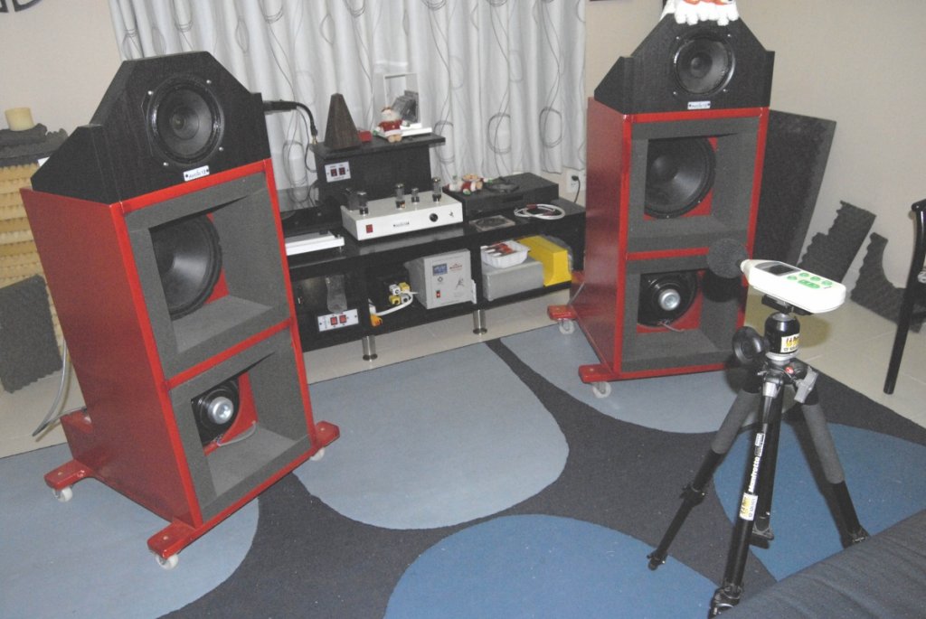

{{ And how is it that those 4 good sized woofers (not familiar with your speakers) are 30 dB down at 50 Hz? }}
Search me, don’t know ? ? ?
{{ Do you listen near field (where the mike is shown)? }}
Yes !
{{ Why not measure from where you listen? }}
That’s what I am doing.
{{ Not sure if your speakers are dipole or bipole, }}
They are equivalent of the V1 from Danny Richie GR Research.
Open baffle, H frame.
{{ or if near field testing makes sense/works with either design.}}
{{ My first attempt used a Radio Shack analog meter with Stereophile CD test tones,
Do you know how accurate your signal generator and/or meter are? }}
Definitely more accurate than a Radio scrap meter…
{{ (Radio Shack meters have well documented inaccuracies, especially at lower frequencies.)  I also recommend doing each channel separately (my matched drivers varied in my nearly symmetrical room by up to 6.5 dB). }}
Yes, maybe I will do that next Sunday.
{{ As I've stated before, the room acoustics priorities should be: speakers (duh); proper room (bigger is better with good length/width/height ratios to avoid reinforcing echo); treatments (but don't over do as we're conditioned to listen to 'typically furnished' rooms); EQ (only as a finishing touch). }}
I agree.
{{ Read Floyd E. Toole's 'Sound Reproduction'.  It recommends a variety of good room ratios, touches on treatments, and pushes the need for having multiple subs.  Without multiple subs no room will produce flat bass response, except in particular locations at particular frequencies. }}
I have two (02) extra Rythmik Servo sealed sub woofer model F12G,
I will try that as soon as I get the repaired Rythmik plate amplifier.
Thanks for the info, I know that I still have some homework to do.

Thanks, but still confused.
Do the readings on your graph include the 40 dB background?  (If so, how do you get readings under 40 dB?)
If the readings on your graph have the 40 dB background subtracted, you seemingly would have been listening to peaks of 130 dB (painfully loud).  Which is it?
Next question:  are your speakers dipole (both woofers fire in the same direction at the same time), or bipole (one woofer fires forward as the other fires backwards on each speaker)?
If dipole, it seems to me that near field measurements (or listening) aren't going to be realistic/recommended as the in/near the plane of the speakers the front and back out of phase waves cancel each other out.
{{ Thanks, but still confused. }}
Let me try to unconfused you.
{{ Do the readings on your graph include the 40 dB background?  (If so, how do you get readings under 40 dB?) }}
First: Where do you see on my graph a reading below 40db?
20-28-32Hz is shown as 40db, but there are not measurable with the SPL, so I show those frequencies as 40db, which is the ambient room noise.
I cannot hear the sound, even if the driver’s cones are moving a little.
Those Eminence Acoustinator drivers start at around 43Hz, all frequencies below that are hardly reproduced.
Second: My reading are including the ambient noise of 40db, which was shown on my SPL meter when everything is off, therefore, the SPL meter has included in the reading the ambient noise.
Are less confused now?
(( If the readings on your graph have the 40 dB background subtracted, you seemingly would have been listening to peaks of 130 dB (painfully loud).  Which is it? }}
It’s certainly not 130db otherwise I would still be in pain with my ears.
{{ Next question: Are your speakers dipole (both woofers fire in the same direction at the same time), or bipole (one woofer fires forward as the other fires backwards on each speaker)? }}
Then it’s bipole, because they fire in opposite directions and are at 5 feet from the back wall.
{{ If dipole, it seems to me that near field measurements (or listening) aren't going to be realistic/recommended as the in/near the plane of the speakers the front and back out of phase waves cancel each other out. }}
The waves of the driver firing at the back wall come back with a delay; therefore, they should not cancel the waves of the front driver.
Does that make sense to you what I wrote?
I hope this helps, if not, ask me again and I will try again.
Hope this ping pong questioning won’t last until next year,
because one of us with give up first and I don’t think it will be me,
because I can be very patient and I hope to learn something from you.

Thanks Guy, just had a hard time reading the left edge of your graph (it's partially cut off on my screen).
Glad to find out they're bipoles (acting like a 360 degree source) as that makes more sense to me, especially for near field listening.  Surprised that those drivers don't go lower, OTOH there's no cabinet to help either.
BTW it's still 2013 here but 2014 there, so Happy (non-chinese) New Year. :beer:

Since you can't get room treatments in Vietnam maybe you could do some improvising with the materials you do have.  Like covering the walls with thick tapestries.  This might not work as well as GIK treatments but it should offer some improvement.  Corner traps will require a bit more creativity.  Maybe large sculptures in the corners?  Preferably geometric ones that would diffuse the bass a bit?

Guy's speakers are OB dipole, woofers are wired out of phase.
