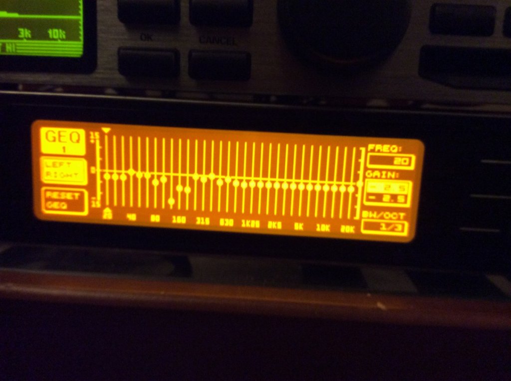

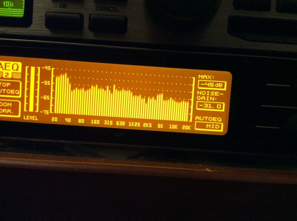

I can't upload pics from my iphone for some reason so I used my iPad to get these...
GEQ
RTA

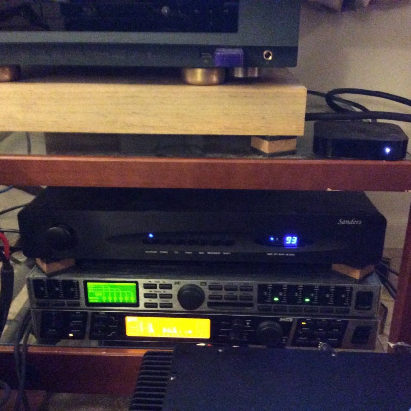

EVS Oppo with Roku stick, Apple TV, Sanders preamp and the Behringers with the 'ears' shaved. Still need to get them off the glass and clean everything up a bit.
The settings below 172hz may change a bit when I install the other Magtech later today (going from the my Zeus gain on the woofers at 33db to the Magtech at 26db), but this is what sounds best now for both music and movies. I changed the DCX back to the default settings that Roger programmed in a few days ago and re-ran the DEQ. Pics of my room (speakers and setup) tomorrow after I clean up.

*RTA picture was taken before the auto EQ kicked in. Looks like a lot of bass between 20-40hz, but it sounds just fine.

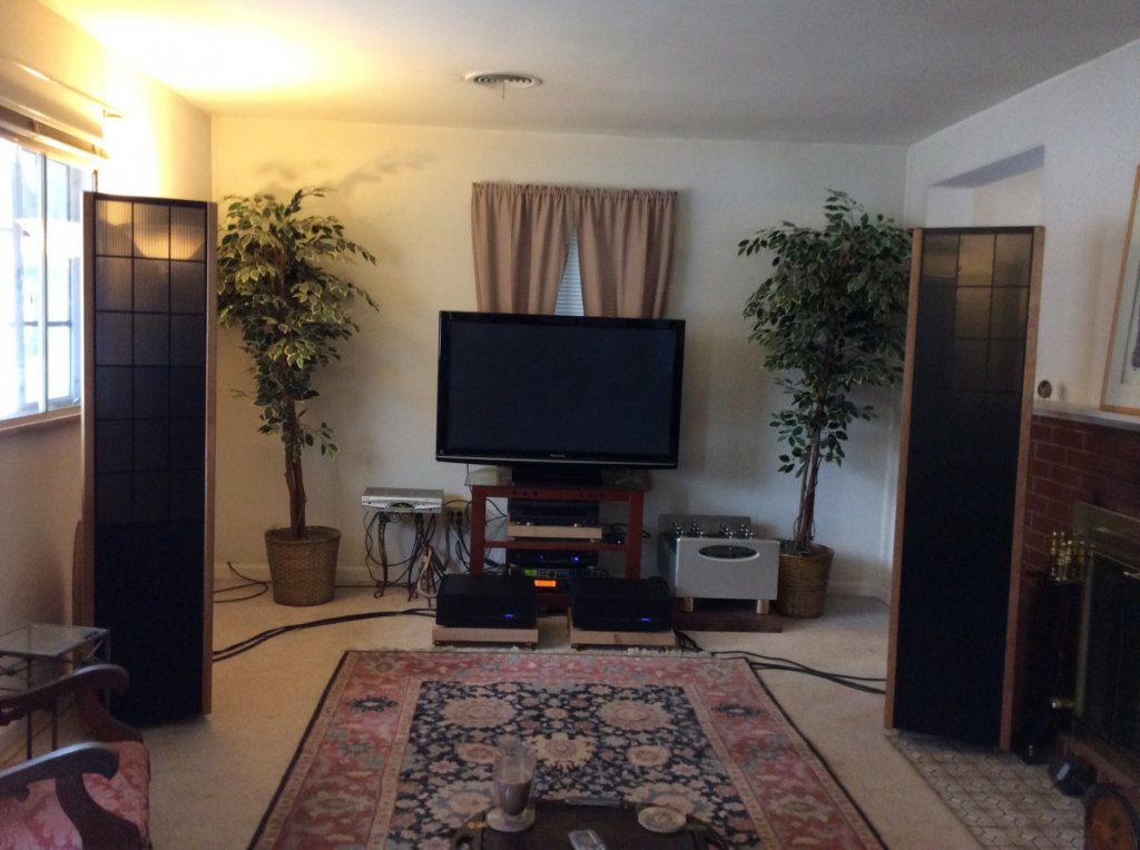

Speakers are 9.5' apart (from center to center) and 9.5' from listening position...
jsm71
Jon, it's funny how one decision drives others.  I thought I had things nailed down after supporting my Maggies with the Magtech, and it was indeed wonderful.  Like you, getting the Magtech amp took me in another speaker direction but for different reasons.  It turns out the Magtech is overkill for the JansZen speakers.  They are quite an easy load with a simple first order crossover and fairly narrow top to bottom impedance swing.
A friend had me try his Decware 25 watt push/pull tube amp and I loved the sound so much I bought one.  Now I'm in line for Decware's next amp, a similar layout but with more watts and an over the top power supply setup.  It will allow the JansZens to fully exceed any volume output I will ever need, even though the current amp does just fine.  I have a small room today, but I'm thinking I will need more oomph if I ever get a bigger rooom.  I'll likely sell the Magtech after the new amp arrives.  It's a fabulous amp, but I just don't need it anymore.  The JansZens are keepers.  Like Roger, David Janszen is a brilliant designer and very easy to work with.  He is working on adding to the product line with both lesser and greater models than the zA2.1 he is currently selling.  I hope I don't like the future upscale models.  My wife would roast me.  :D
Your room looks great.  Have you had any issue with the speakers so close to the side walls?

@Jon K:
WOW, that's a whole lot of subsonic activity from those Sanders.  If that were in my room, I'd be thinking there was a hum being picked up by them.  But as you say, if they sound good...
And you do know, right, that by setting all the sliders above 630 Hz at -2.5 dB you are introducing slight non-linearities and whatever bad ju-ju equalizers do to the upper midrange and treble, right?   :D  Seriously, I can see why you're happy with the settings as they are, since you wind up with a slight downward trend to the "flat" response which most listeners come to expect, particularly far field and the dip at 2500 Hz, while deeper at -5dB than the setting at -2.5dB I use, is basically the "BBC dip" which Thorsten wrote about in the last link I posted.
That plot looks scarier, though, if you first turn on the pink noise in the I/O section then set the RTA display width to 15 dB vice the AutoEQ default of 30 dB.  Since you've already gone to the dark side of the Force by EQ'ing the treble down, try playing with squashing some of the peaks a bit so the trend stays the same.  Whether or not the results are theoretically valid, you just might like what you hear - which is the whole point, no?  And your Sanders do look quite handsome...  Congrats!  I wish my room was as well behaved as yours appears to be.  For me, IN MY ROOM (standard disclaimer) I couldn't get away with a setting like yours where you keep the DEQ linear past 630 Hz.

@MGbert, from what I understand (from a review, I haven't asked Roger yet) there's an intentional boost below 35hz. I've lowered it to where it looked flat with the pink noise, but the low end sounded too thin. The boost makes Music that goes that low sound full and natural.
I knew what you were talking about when you mentioned the 'BBC dip' and was a bit surprised to see it show up on my RTA. I still think the sound my ears hear at the listening position is a lil different than what's gathered by the mic for the RTA meter...going back to what the brain interprets from direct music vs. delayed and reflected sound coming from the room.
I'm not sure I get what you're saying about the RTA width. I'll have to play around with the DEQ a bit and see if I can figure out what you mean. I have about 8 settings so far. While I'm mainly concerned with the frequencies between 125-200hz, I'm still doing a lot of experimenting with frequencies up to 1k...above that it really does effect the sound for the worse with these speakers.
@a.wayne, the Behringer DCX comes with the speakers. The Behringer DEQ was suggested by Roger Sanders to deal with the room modes that were bothering me (he uses them in his personal setup(s) for different reasons).
