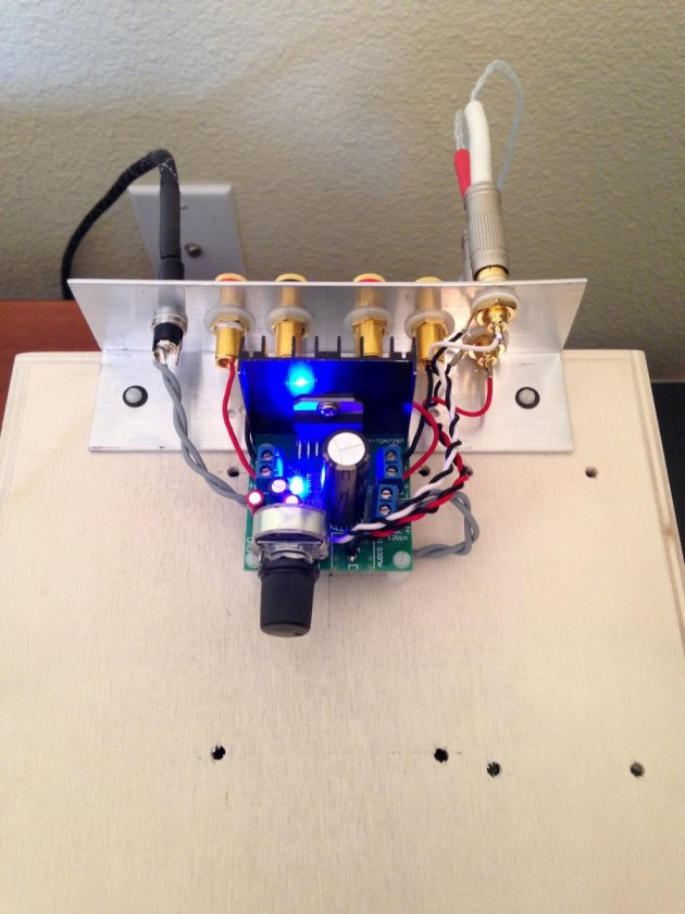

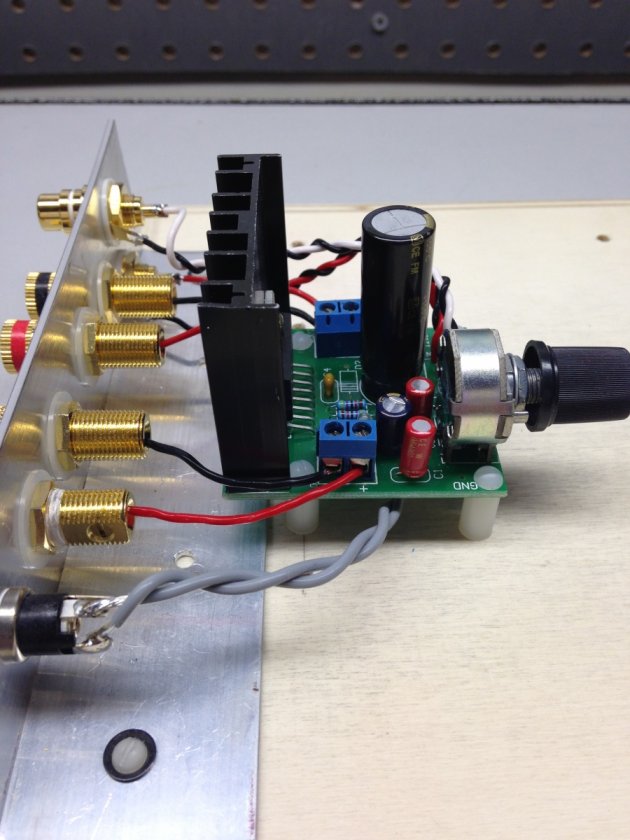

I dusted off my last TDA7297 amp in my garage storage, and connected it to some speaker binding post connectors from Lowes and a pair of Vampire CM1F RCA connectors. Previously, I had been toying with a Sure TPA3116 amp, and decided it was time to give the TDA7297 another try again.
Per Salis Audio's recommendation and based on some of my own experience with these amps, I did the following:
  • Replaced stock volume pot with 50k log taper, 21-position SMD resistor stepped attenuator
  • Replaced stock .22uF metallized Polyester film caps with 1uF/25V Black Gate N non-polar electrolytic capacitors
  • Replaced large stock DC decoupling electrolytic cap with 2,200uF/25V Panasonic FM cap
  • Replaced DC polarity protection diode with a small jumper wire (Kimber Kable TCSS, 19AWG)
  • Removed 3.2mm mini stereo plug and directly wired inputs to RCA connectors
  • Wired signal inputs with Kimber Kable TCSS, 19AWG Teflon-insulated Copper hook-up wire
  • Wired DC power input with 16AWG Teflon-insulated Silver-plated Copper Mil Spec wire
I connected the TDA7297 amp to my Audio Research LS7 line stage and ARC PH5 phono stage, and my modified Klipsch Forte II speakers to see how good this amp can be. For power, I used my modified Astron RS-12A regulated linear power supply.
Well, it sounds really good. In fact, I think it sounds better than my original TDA7297 amp with the .22uF Mundorf Supreme film caps. The Black Gate N caps take a long time to break in, but once they do they really open up nicely with a warm midrange and deep soundstage. I really liked the tonality of this amp with the exception that the bass doesn't go deeper. What bass is there seems solid and well-defined down to 45-50Hz, but nothing ground-shaking.
I've been experimenting with the Texas Instruments TPA3116 Class D amps and even replaced the input coupling caps with CineMag CMLI-15/15B input transformers to take full advantage of the differential inputs. I am quite pleased with my efforts with the TPA3116 Class D amp, but I have to admit that the TDA7297 isn't far behind, and it's considerably easier and cheaper to modify. I'll do some more critical listening. Comparing amps can be very difficult, but with listening to very familiar material, I can start drawing some comparisons.
I have yet to take that little yellow ceramic cap off the board. Perhaps I'll try experimenting with the Nichicon ES bipolar caps once I get a solid feel for the Black Gate N caps. I wouldn't mind trying some 1uF Polypropylene film and foil caps either.

You still have some upside potential there. The speaker wire connectors on the board are ferromagnetic. The screws are steel. You can remove those connectors and solder the speaker wire straight to the board. So there is one improvement for you that won't cost you a dime.
Excellent point. I want to use connectors to play around with this amp. I have some Weidmuller 2-position terminal blocks that use Tin-plated Copper alloy contacts. I bought these from Digikey for this very purpose. Eventually, direct wired connections are the way to go.
