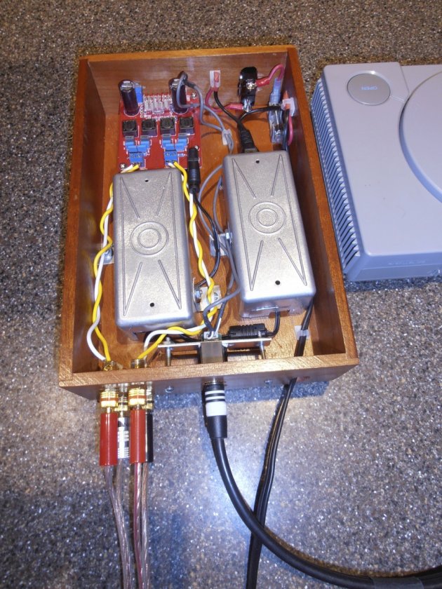

This is how she looks topless.

That's a big box for a small amp. What's all going on in there? And what are you using for a power supply?
Looks like the two silver "bricks" are 12 volt power supplies wires in series to get 24 volts.
Wind Chaser, if this stuff is new to you, then you are in for a treat!  If not...sorry for the newbie advice.
I'd get some standoffs, if you don't already have some.  I like the aluminum 4-40 one's on ebay.  You'll need some 4-40 screws as well.  These amps are VERY light, and if you secure them on a small piece of plywood or the like, then the cables won't drag it all over the place.
Then you can connect the power supply, speaker wires, etc. to the amp, plug in the PS, and enjoy.  From there, you can go to the next step...a real enclosure.  You can reuse the standoffs to mount in the case.
Again, sorry if this doesn't help.  The neat thing about these amps is learning all the other stuff, like switches, jacks, binding posts, ...
Hi Mike,
I had played around with the DIY Paradise Charlize about 7 or 8 years ago. Don't recall exactly how (or if) I mounted them. I had two and the plan was to mount one amp on each baffle with 2 Visaton B200's. The Charlize was a very nice amp, and it was quite a bit more costly than the TPA 3116.
Thanks for the tip on the standoffs, but I'm hoping to get them locally.

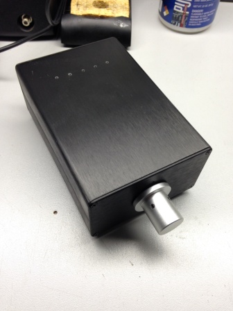

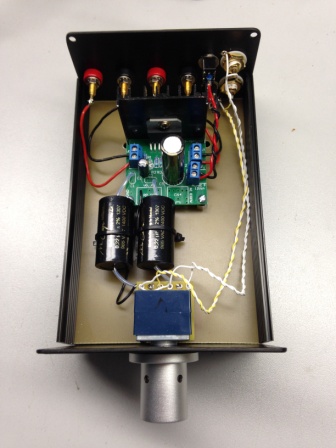

I played around with t-amps for few years as a hobby, just got my first chip amp TDA7297, hooked it up to small desktop speakers.  To my ears it sounds surprisingly good.  I am excited to connect to my main full-range and see.  I agree it is excellent and cost me $7.
I also have a TDA7297 Class A/B chip amp that I had assembled into an enclosure and upgraded with an Alps volume pot, some Mundorf Supreme film caps, Mundorf Silver-Gold hookup wire and a Panasonic 2,200 uF / 25V power supply cap.
This is a very fine sounding amp--much better than the Tripath amps I've owned. However, the bass on the chip amp itself (not on my own personal implementation) is reported on the ST Micro datasheet to begin rolling off at 40Hz. If you have speakers that go down to 31-35Hz, you will not hear really low notes. My modest-powered Sure Electronics TPA3110D2 goes deeper than the TDA7297. To my ears, the mids and highs are clearer sounding with the Texas Instruments Class D amps with greater detail in terms of attack and decay. I followed Salis Audio's advise and removed the polarity protection diode, and that improved the sound quite a bit, but the Class D amps are better.
The Texas Instruments amps cost more, but provide greater performance for the extra expense. I liken the TPA3110/TPA3116 amps to be like refined, next generation T-amps. Any shortcomings with Tripath amps were either reduced or eliminated, and the bandwidth and tonality were improved.

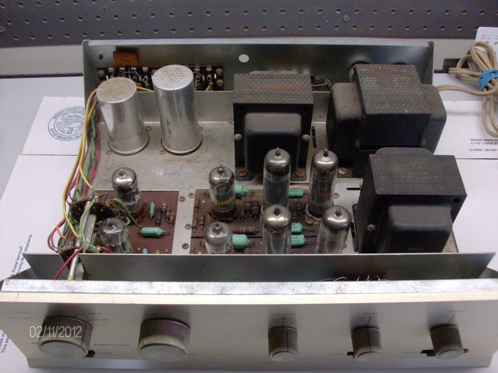

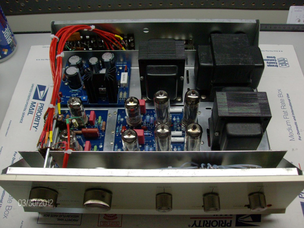

I can vouch for the performance of the Wima MKP10 caps and Belden 8864 shielded hookup wire. I restored a Dynaco SCA-35 6BQ5/EL84 integrated amp using Wima MKP10 caps as coupling caps in the phono stage and in the driver stage. The output coupling caps (tubular white caps next to 6BQ5/EL84 tubes) are Sonicap Gen 2 metallized Polypropylene film caps. The new replacement PCBs including the power supply cap and Enhanced Fixed Bias (EFB) board were from Audio Regenesis.
Here are the before and after shots:
For the money, the Wima's sound very good, but they do need some time to burn in and really sing. The Belden shielded hookup cables are great for maintaining a low noise floor.
