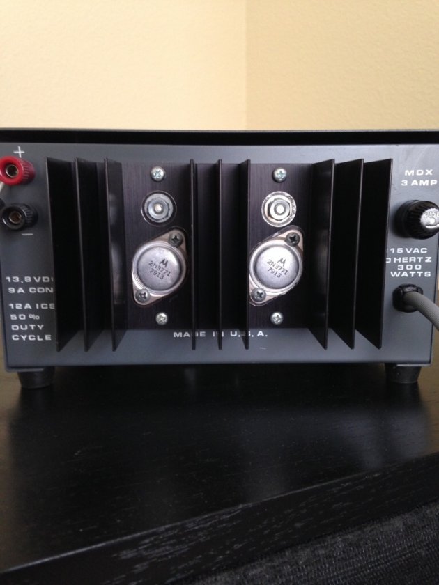

4.5" (H) x 8" (W) x 9" (D)
Keep in mind that the heat sinks on the rear of the case need full exposure to properly channel heat away from the Motorola transistors and the rest of the unit. Also note the 1/4" air gap between the top of the rear panel and the top of the enclosure. For safety purposes, I wouldn't have this in a home with small children.

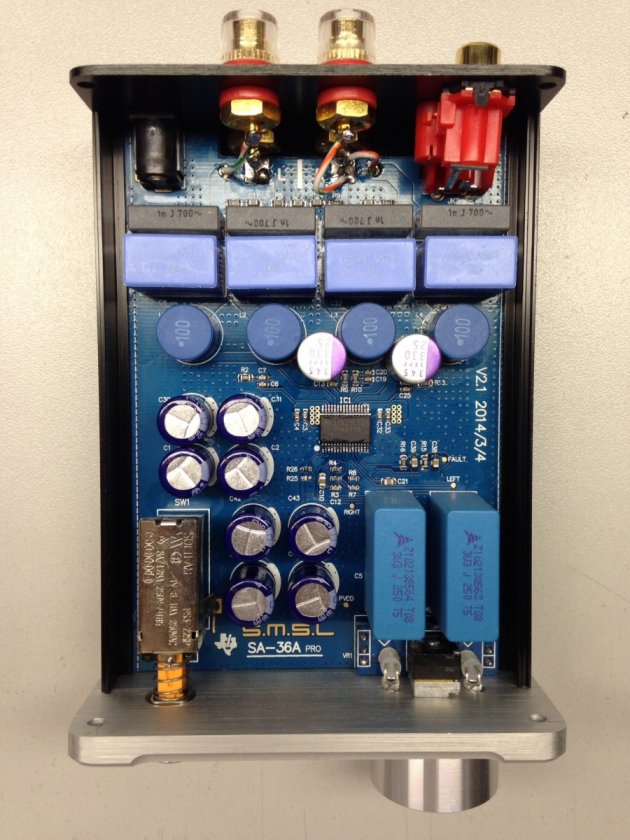

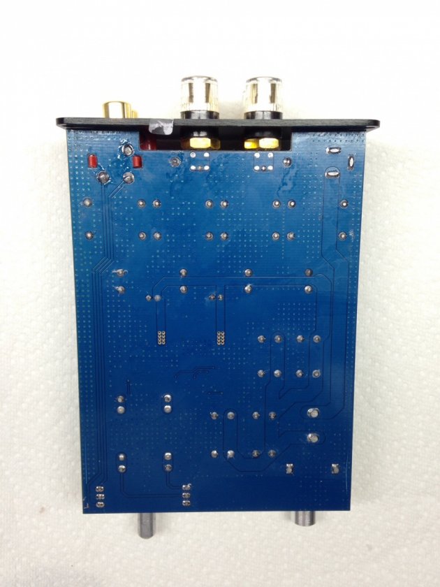

I still had a couple 330uF/25V Panasonic SEPF OSCON caps in my parts bin, so I decided to upgrade the power supply decoupling caps in my SMSL SA-36A Pro TPA3118D2 amp. As with my Yuan Jing TPA3116 blue amp and Sure Electronics TPA3110 amp, the improvement was significant. The amp sounds less analytical and more musical while still increasing the level of detail. The bass is tighter and the soundstage is more three dimensional with the image is more focused.
To upgrade the caps, I had to remove the board from the chassis, which meant breaking that small piece of foil seal tape that voids the warranty. Oh well. The board is nicely laid out, and I used this as an opportunity to add a touch of Cardas solder to most of the solder joints. Whatever solder SMSL uses doesn't flow at all. I had to add Cardas solder to get it to flow so I could use my Radio Shack solder sucking tool to clear out the thru-holes. I still had to use a medium-size safety pin to ream out the thru-holes to allow me to fit the OSCON leads through them.
These caps barely fit in between the inductors. Ideally, the 180uF/25V Panasonic SEPF OSCON caps would have fit better since they are a bit smaller, but more capacitance and a slightly lower ESR of 14mohms are good things.
Eventually, I will replace the eight (8x) general purpose 470uF/25V Panasonic M electrolytic caps with better 680uF/25V Panasonic FM electrolytic caps with lower ESR and longer life.

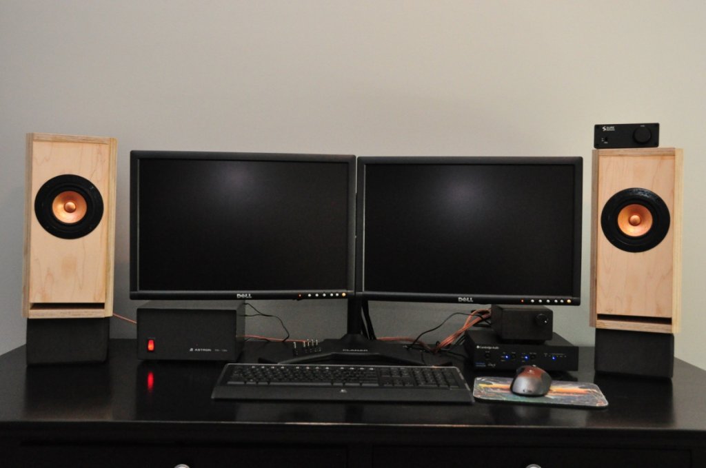

I don't know why you don't hear differences between power supplies.
I am not sure what your sources are...
A picture says a thousand words:
Source is CD audio in FLAC format on computer.  Optical SPDIF to a Cambridge Audio DACMagic (original), to tpa311x amp.  Speaker cabs were built from a Slim Classic Golden Ratio (CGR) dMar-Ken7.3 flat pack Planet10 cut for me.  Drivers are Markaudio Alpair 7.3 with Planet10's EnABLed process.
As you can see, this is a very nearfield setup.  When I'm sitting at my desk, my ears are probably about 2 feet from the speakers, and listening around 60--65 dB.  (The other side of that wall is my toddler's bedroom; I usually only get to listen when she's sleeping, so practical considerations force me to keep it down.)  Today I had a bit of time to "crank it"... by my standards anyway, I had the music around 70--75 dB.  (SPL measurements taken with an app on my phone---obviously not the last word in precision, but presumably the right ballpark.)
In this setup, I don't think the room dynamics should matter too much.  Speakers are front-ported, and I'm very close to them.
Anyway, I kept going back and forth between the cheapie wall-wart and the Astron... I plugged the wall-wart straight into the AC outlet (to remove my UPS as a variable).  I think I could hear some difference.  It wasn't night and day.  But to me, by analogy, the wall-wart was kind of like looking at a picture that is ever-so-slightly out of focus: you don't even notice that it's out of focus until you see the proper focus version.  The Astron is the "proper focus" version, of course, some sounds were just a bit "crisper around the edges", so to speak.
I told my wife I want to close my eyes and have her switch (or not) power supplies randomly, and see if I could hear a difference.  She sighed and rolled her eyes.  ;)
I'm happy with the sound either way, though it is fun when something gets tweaked and the change is obvious and immediate.  Aural considerations aside, I like that little wall-wart because it's more efficient (according to my Kill-a-Watt) and also physically small.
