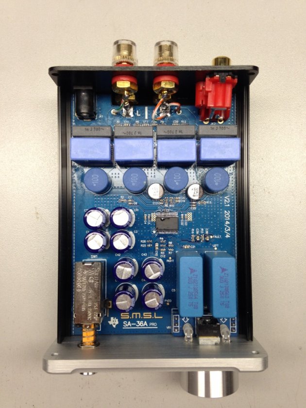

In working with these TPA31xx amps over the last several months, I've come to the conclusion that the DC power supply decoupling caps closest to the amp IC are very critical to the overall sound quality. In most Texas Instruments schematics for these amps, these are typically the 220uF/25V caps in parallel with a couple ceramic SMD caps.
With wushuliu's idea of using hybrid organic polymer-electrolytic caps on his Yuan Jing TPA3116D2 2.0 blue amp, I started trying 330uF/25V Panasonic SEPF OSCON (formerly Sanyo OSCON) organic semiconductor in these amps. I've added these to my Yuan Jing TPA3116D2 blue amp and to my Sure Electronics TPA3110D2 amp, and in both cases, the sound quality was significantly improved with deeper, punchier bass, improved tonality in the mids and highs, a deeper soundstage and more focused imaging.
I opened up my S.M.S.L. SA-36A Pro TPA3118D2 amp and this little guy has the following caps inside:
  • 2x 47uF/35V organic polymer cap, 8mm dia
  • 8x 470uF/25V Panasonic M electrolytic caps, 10mm dia
  • 4x Pilkor 680nF/450V MKP LC filter caps
  • 2x 3.3uF/250V Epcos MKT film caps
The amp sounds great, and I think it can be improved with replacing and removing some of the caps. It does have an annoying turn-off pop, but I think making the changes will reduce it. I've tried this amp with the stock 12VDC/3.8A SMPS brick that came with the amp and my upgraded Astron RS-12A. The difference is night and day. For someone looking for a complete TPA31xx amp, this little $50 amp could be the one, especially with an upgraded power supply.
