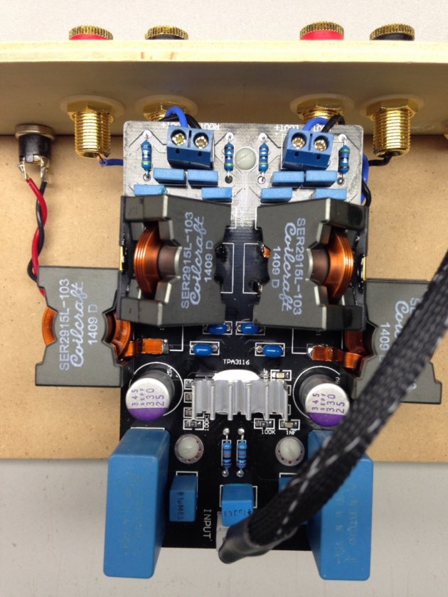

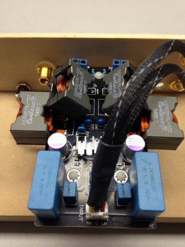

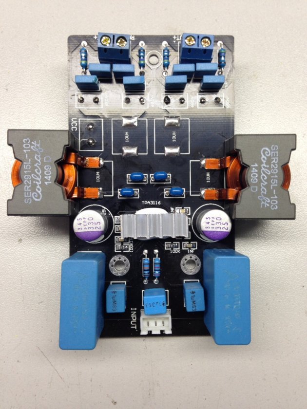

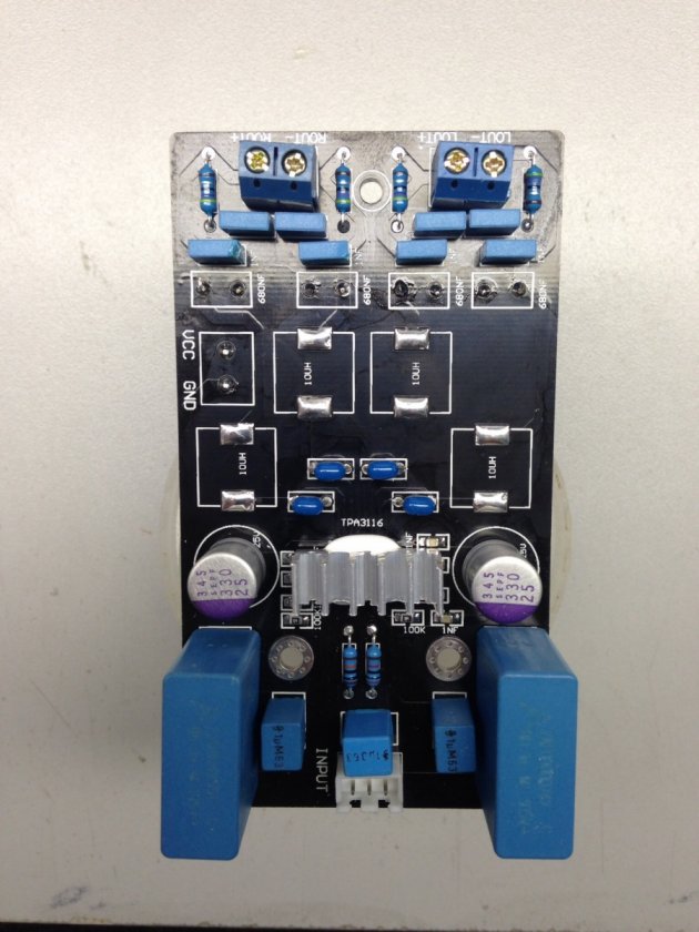

I installed a set of the 10uH Coilcraft SER2915L-103KL nductors in my Yuan Jing blue amp, and I have to say the improvement was noticeable from the start. It's like a veil has been lifted and the amp has reached another level of transparency. It's difficult for me to make an apples-to-apples comparison to the Bourns 10uH inductors I've previously tried, since that amp was shipped off elsewhere. I will say that the current amp has a big, full bodied sound, and I haven't even upgraded the input caps yet.
These are some bulky inductors and I took my time planning how I was going to fit these on the Yuan Jing amp and in what order I was going to install them. I am please with how it looks even though it does look a bit different. Once this amp gets placed into an enclosure, I'll forget about it.
One thing is sure, upgrading the inductors adds a higher degree of clarity and transparency to this amp. It's almost like I don't have anything between my phono stage and line stage and my speakers except gain.

Wow Rhing, special admiration for the soldering of these coils, i think you kept DCR intact (ultralow) by keeping contact beautifull level and minimum solderthickness. I believe 1mm solderthickness could increase DCR 4times, thats how low these DCR ratings of this coil are. Now handle with extreme care not to have the weight pull off the pcbtraces, or do they look heavier then they are?

Thanks. The Coilcraft inductors are on the board very solidly. For the two inner inductors, I did my best to insure the leads were bent to make the best possible contact with the solder pads. I even applied some masking tape to my needle nose pliers to protect the joint surface from getting scratched when I bent the leads. I use Cardas quad-eutectic solder, which has served me well over many projects. To solder these on properly, you really need a good 40 watt iron with a narrow neck and a small chisel tip to be able to get into the tight spaces without scorching adjacent components and rapidly heat up the joint. The Copper coils in the inductors work like a heat sink, so you need to be able to transfer heat quickly before the coils start to conduct heat away from the solder joint. Once the coils were secured, I re-touched the joints one at a time to get them nice and shiny--I hate cold solder joints.

What do you think about putting a glob of epoxy like JB Weld over each of the inductor solder contacts to further reinforce the connection?  Might be overkill, but for example, if you ever shipped it (listening tour version 2?) it might need safeguarding against ham-handed shippers.  (I'm sure we've all seen the videos of UPS/FedEx employees caught in the act, making that scene in Ace Ventura a little less comedic, and more like documentary).
Or maybe you could JB weld "flanges" to the bottom of the PCB, effectively increasing the width of the PCB, given those inductors something to "rest" on, and relieve the torque on the solder joint.

That's not a bad idea. I think I'd rather go with a non-conductive adhesive to avoid the possibility of connecting the inductor housings to the ground plane. A few dabs of Silicone adhesive or hot melt adhesive should be sufficient since these inductors are solidly on the pads.

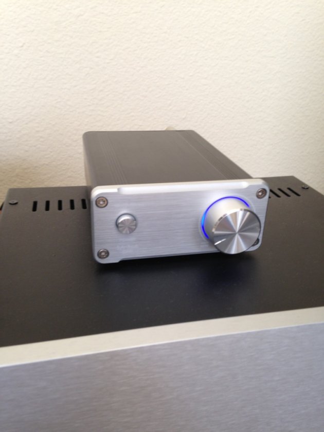

I just received the S.M.S.L. SA-36A Pro TPA3118 today and hooked it up in my system. Even though it came with a 12VDC/3.8A brick-type SMPS, I connected it to my upgraded Astron RS-12A regulated linear power supply. I will listen to it more and report on the sound quality and how it compares to my other TPA31xx amps:
  • Yuan Jing TPA3116D2 2.0 blue amp, near stock (only swapped in 470uF/35V Panasonic FM caps in for stock 1,000uF/25V Nichicon PW power supply decoupling caps)
  • Modified Yuan Jing TPA3116D2 2.0 blue amp
  • Modified Sure Electronics TPA3110D2 amp
As with my S.M.S.L. SA-S1 TA2020 T-amp, which I sold to a friend, this is a very attractive amp inside a nice Aluminum enclosure. I haven't opened up the hood yet. Just playing music and letting the amp settle in before I do some critical listening this evening (I want to catch the NBA playoffs too).
