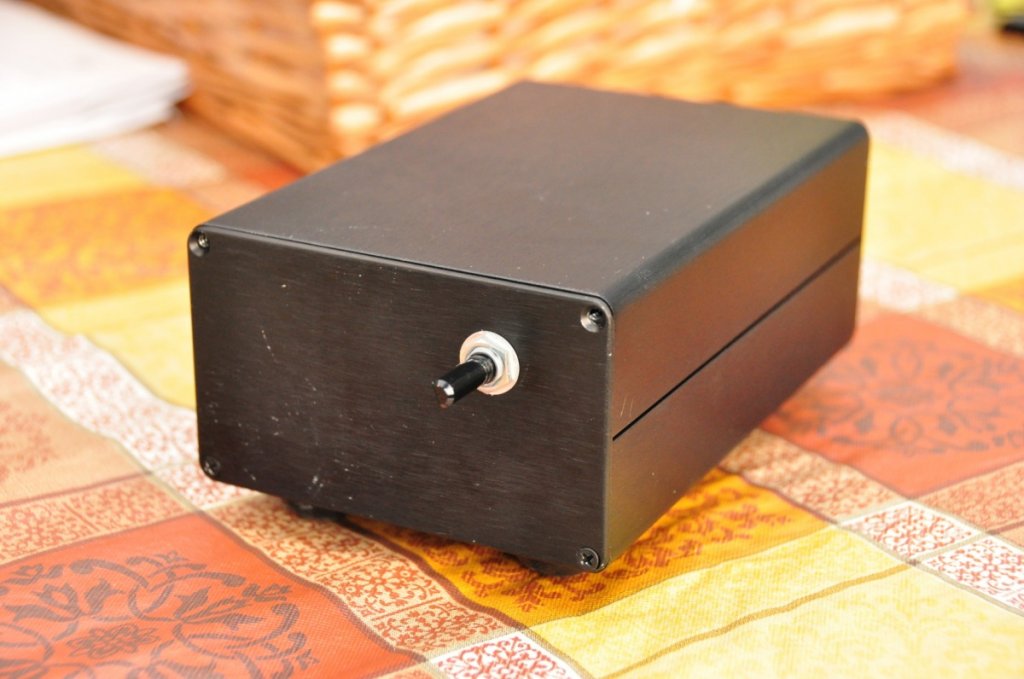

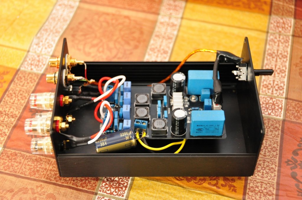

This weekend, I tweaked my tpa3116 build a little bit.  Main change was to add a volume pot (same $1.37 Panny EVJ 50k ohm I used on my tpa3110 build).  I also tried to clean things up a bit.  Still looks messy compared to Rhing's builds, but I think I'm moving in the right direction.  You can see I also threw a 2200uF / 35V cap across the power inputs.  Furthermore, I'm using shielded wire for the input, and before, I didn't connect the shielding to ground, so the effect was presumably negated.  This time I actually soldered the shielding to ground.  The shielded wire I have doesn't have a drain wire, so I have to bunch up the un-braided foil and just solder it as a big glob to ground.  I covered up all that messiness with electrical tape.  :)
Here's a shot of the (mostly) finished product (waiting on a volume knob from ebay).  This is a reminder of why you always use masking tape over everything when drilling.
Anyway, adding the volume knob allowed me to do a more "fair" comparison between my tpa3110 and tpa3116 builds.  Before the volume knob on the tpa3116, I had to control volume via software.
I spent some time this weekend going back and forth between the two.  On my system, and to my ears, I think I still give the 3110 a slight nod.  Could I tell the difference in a blind test?  Probably not.
Side note: I also picked up an Astron RS-12A power supply from ebay.  (FWIW: $36 + $10 shipping, in pretty good condition.  Hard to beat Rhing's $20 like-new Craigslist score!)  I did a lot of back-and-forth between the Astron and the "K-Tec" 12V/2A wall-wart I got from Parts-Express (Part # 120-052) with the 3110 only, and I couldn't hear a difference.  I know, that's blasphemy!  :)  But, I wonder if power supply quality matters more at higher current draw levels?  Just an idea, but with my nearfield (desktop) setup, and ~65 dB listening levels, I'm not pulling much juice; a minimal load even for the wimpy little wall-wart.  That, and/or my system simply isn't revealing enough.
I'm also starting to re-read the entire diyaudio tpa3116 thread.  A lot of info I skipped over or didn't understand the first time through now seems much more relevant.
In particular, I realized that the 3110 is a filterless design, i.e. the $10 Sure board doesn't have any large LC output filter.  And that's why the ferrite beads are recommended, as they can help filter the FM frequencies out of the output (i.e. prevent your speaker wires from becoming broadcast antennas).
Whereas the 3116 boards all have an LC network for filtering out the inaudible noise introduced by the class-d amp circuit.  One interesting note is that the older/cheaper "red" YJ boards used 22uH inductors and the newer "blue" YJ boards use 10uH inductors for output filter.  Based on my (cursory) understanding, the former is better suited to an 8 ohm speaker load, and the latter a 4 ohm speaker load.
Given that my speakers are 8 ohm, and lots of people report improvements with output filter inductor replacement, I'm thinking that's where I ought to focus my next mod efforts.
