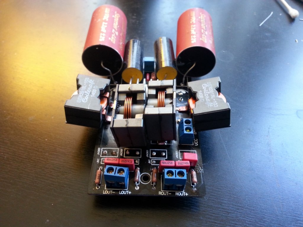

Wow, that's epic!  Do you have a stock board to compare to the "transformer"?  Is that board fragile with all that stuff hanging off it?  I'd be afraid to move it for fear of busting something off!
Pretty nice!

« Reply #653 on: 26 Apr 2014, 08:10 pm »
Awesome!! :thumb: have you listened yet?

Haven't the time yet. hopefully soon...

« Reply #655 on: 26 Apr 2014, 10:55 pm »
Nice work wushuliu. You really took advantage of the Yuan Jing blue amp's thru-holes for modification, which is the main advantage of this design.
Yes, this board is a joy to work with in terms of desoldering and space. Took me only a fraction of the time to mod compared with other boards.

« Reply #657 on: 27 Apr 2014, 03:09 pm »
can you run down a list of the components you used, for those of us who can't recognize such things on the spot with an unclear picture? :P
Coilcraft SER2915L 10uh inductors
TDK .22uf 250v X7R caps (bootstraps)
330uf 25v Panasonic hybrid electrolytics (PS caps)
Wima FKP, MKP, and MKS for .68uf,10nf, and 1nf output filter caps
36db gain resistor setting
Dayton MKP 2.2uf input caps
Jantzen Superior 2.2uf input caps
Amp sounds *excellent*. Clean and clear, no grain or edge. *Pure*.Best build yet. All done now w/ the TPA. Ready to move on.
