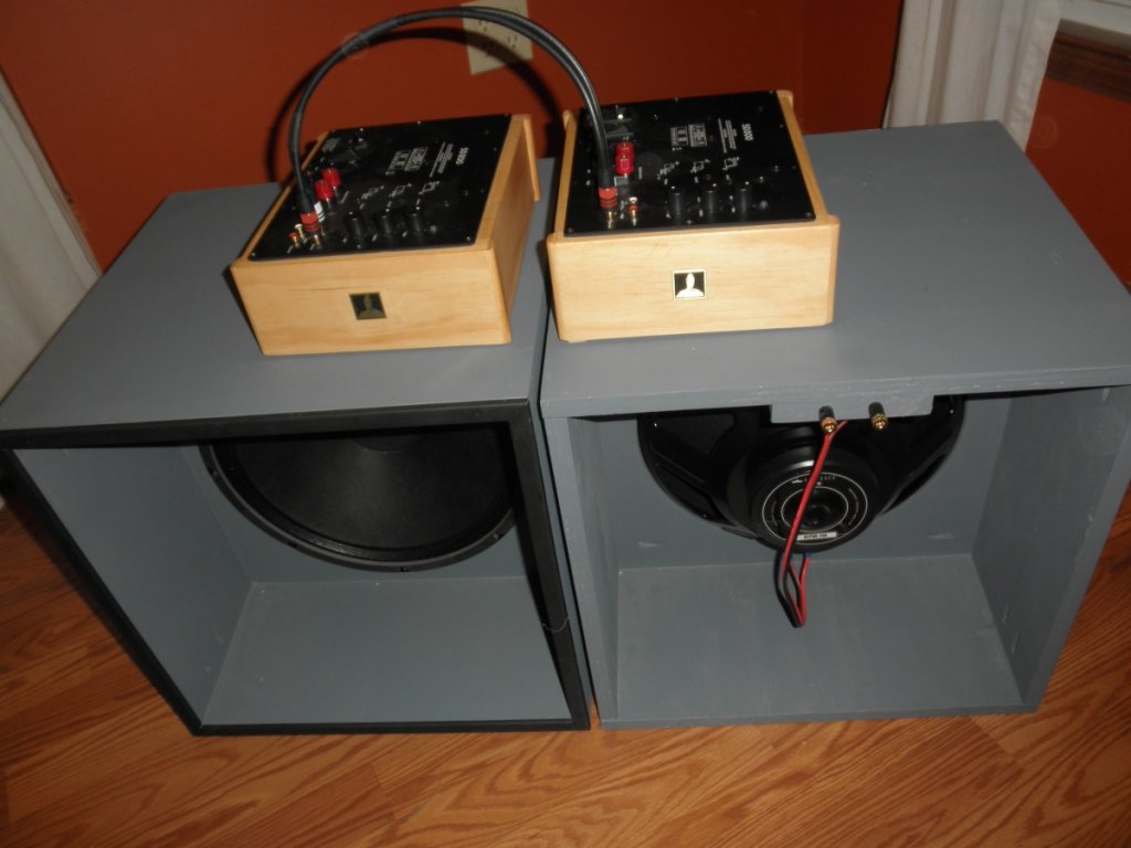

rajacat, thanks for the link, I think something like that would be a better choice... those woofers are capable of WAY over 112 dB, I want peaks in the 120 dB range!  :icon_twisted:

The Class D Yung plate amps from PE are hard to beat for driving woofers in a bi-amnped system.

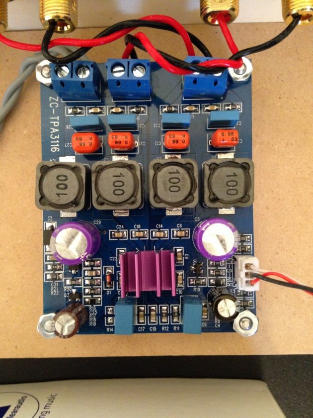

Rhing: can you post a picture of lower part of Chengzhi board taken from straight above it? Or could you tell to what pins of tpa chip the added transistors (circuitry) lead?
This is about as good a photo as I could get with my iPhone. As for what pins are connected to the added circuitry, I cannot tell unless I pull the amp off the standoffs and check with my DMM. That is not going to happen soon, because I am enjoying the amp in my system right now.

Chengzhi did some noise prevention, resistors near input, a good thing most others neglected. Also seems the transitor on the right is mute circuit like the green audiobah. But 2 transistors on the left side, is he doing something with sdz chip-pin2 to alter startup time (and switch off time) maybe??? And what about the 2 added larger lytics, mmm... I did buy this pcb from alieexpress, but only cost money and never got pcb, alieexpress/alibaba ignore complaints, never respond, they did do a partial refund (they advertise full refund) but transfered the money to my bankaccount and guess what....transfer cost I had to pay were equal to the partial refund...lesson learnt, no more buying from alieexpress for me :D
You must be correct, because this amp has the least noise (faintest hiss) of the TPA311x amps I have. There is no turn-on/turn-off pop using the power switch on my Astron linear power supply or when I have the power supply powered on and I plug and unplug the DC power connector on the amp. I've never experienced the turn-on thump with any if my amps, and the turn-off thump is a very faint thump (really a tick) that does not cause my woofers to move. I always have my source (line stage preamp) plugged into the amp. The power amp is the last to be powered on and the first to be powered off. I don't use any line conditioners or surge protectors. I have a Wire Mold 9-outlet power strip that I bought years again when I had Naim gear.
