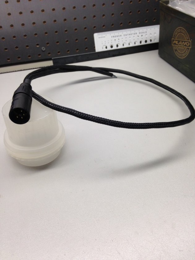

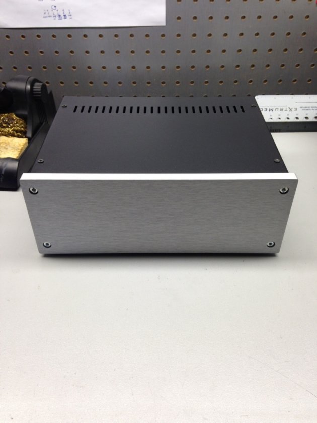

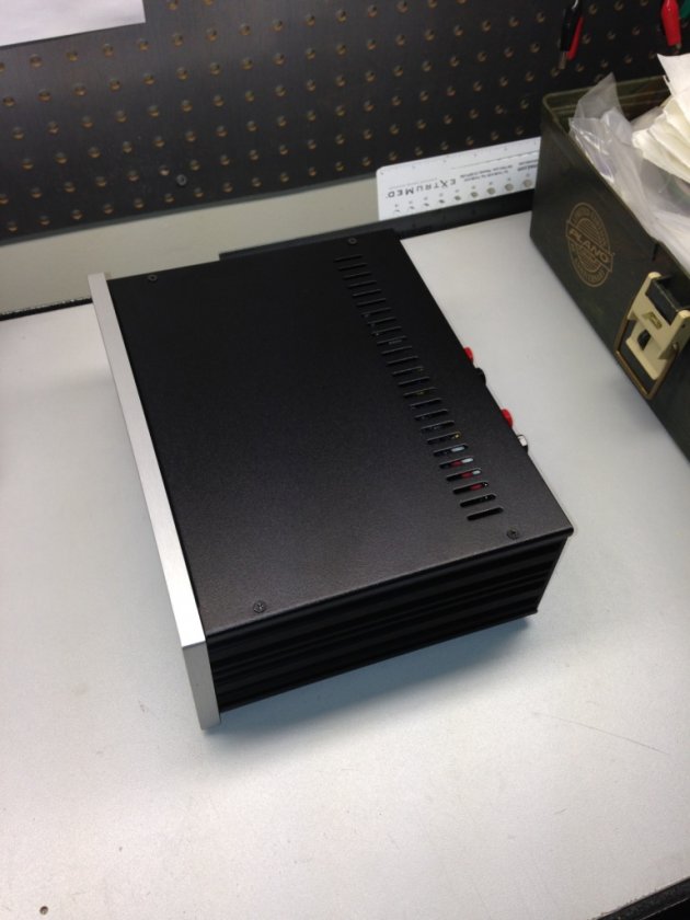

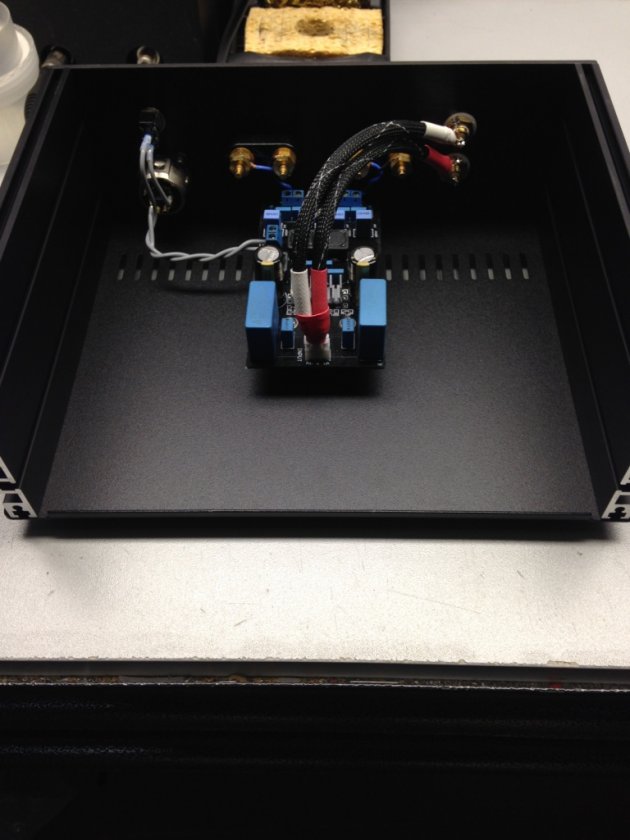

So today, I transferred my Yuan Jing TPA3116D2 amp into a Modushop enclosure that I've had for quite some time. I bought two at the time when they were on sale for about $45 each. I decided that this amp was worthy of putting into a nice enclosure and it matches my Audio Research gear very well.
I started out fabricating a new DC power umbilical cable to go from my Astron RS-12A regulated linear supply to the amp. I decided to ditch the small Switchcraft coaxial DC connector in favor of a Neutrik 4-pin XLR connector. I followed the standard convention of using Pin 1 for "-" and Pin 4 for "+." The cable is nothing more than a twisted pair of 16AWG Mil-Spec Teflon-insulated Silver-plated, stranded Copper wire I picked up at a local surplus electronics store. I put spiral wrap tubing over that and then a Techflex expandable sleeve on top.
I then had to drill out the holes on the chassis rear plate and bottom plate to mount the connectors, power switch and the amp.
I took my time assembling the chassis since most of it is Aluminum. I didn't want to rush through it and end up scratching and marring the surface. The Modushop chassis from Italy is extremely well made. I bought mine directly from the manufacturer, but diyAudio.com sells them now, although at a much higher price.
I know some people are thinking why such a cheap amp in an expensive chassis, and why such a large chassis? First, I really like this amp in my system, and I didn't want to see my wood-mounted prototype anymore. Secondly, this chassis can accommodate some input balancing transformers like Jensens or Lundahls, which I plan to experiment with in the near future.

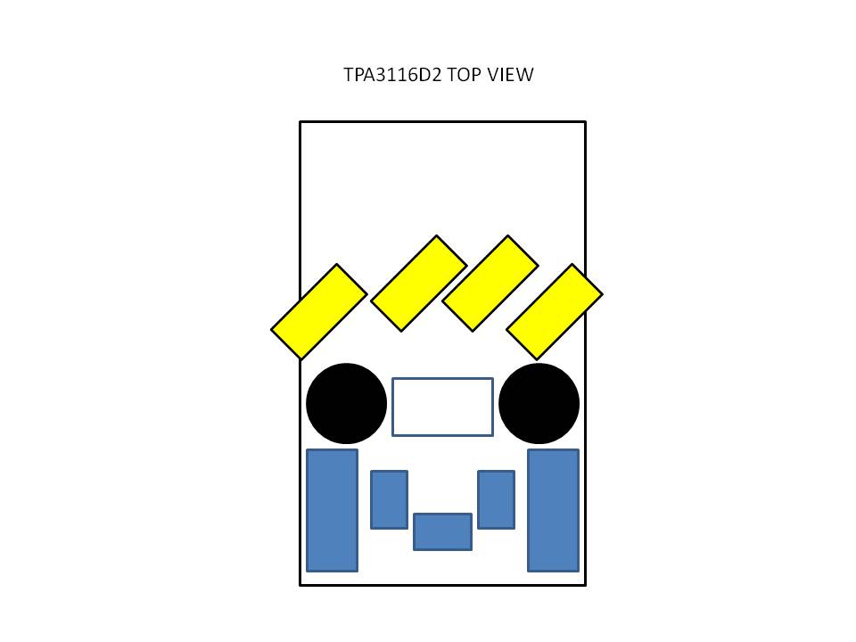

To mount the Bourns inductors, the objective is to keep the vertical lead legs vertical. So if you have to mount them at an angle, you should probably bend the leads about 1/16" to 1/8" below the "mounting plane" point as indicated in the Bourns datasheet.
http://www.mouser.com/ds/2/54/2100ht_series-8038.pdf
Maybe this top view diagram will better illustrate what I am trying to describe.
