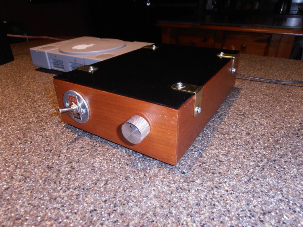

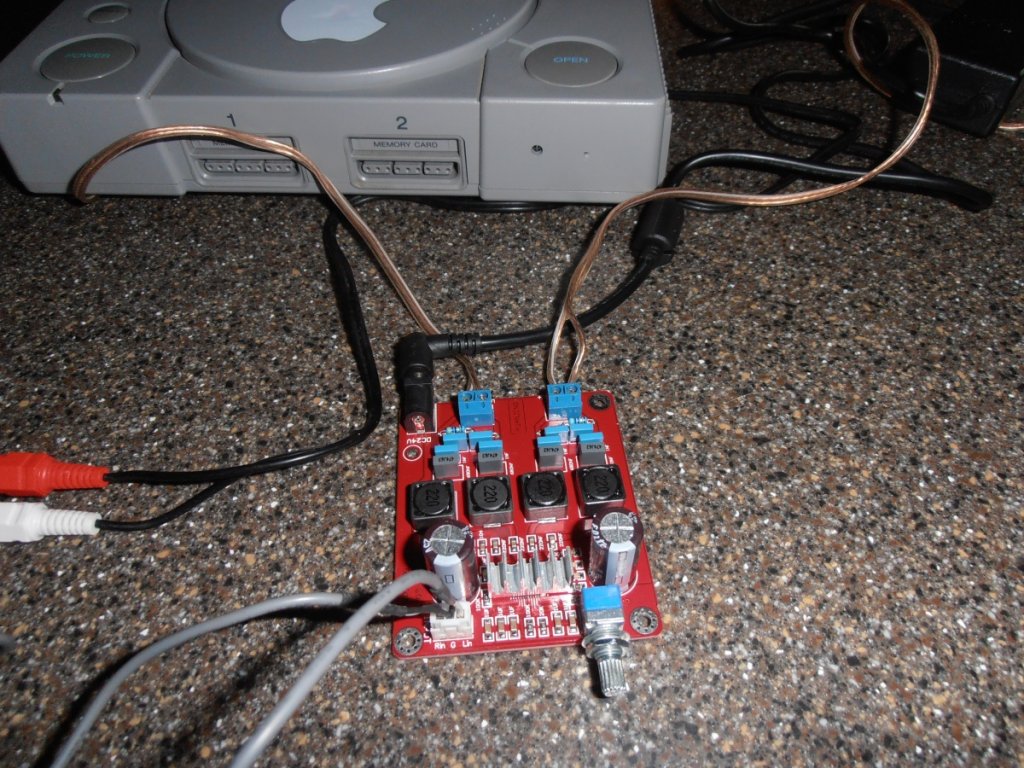

Poultrygeist
Re: TPA3110 and TPS3116 amps
« Reply #274 on: 18 Feb 2014, 12:12 pm »
If you buy the $5 RCA gray cable that snaps into the socket on the board it's plug and play. This one is playing from the PS1.

Poultrygeist
« Reply #278 on: 18 Feb 2014, 11:44 pm »
Naked board amps like many naked people look better with clothes on. A $5 decor box and a little imagination goes a long way.
The above is cheap, but not very cheerful.
The image below is more tearful than cheerful.
I'd like something a little more on the cheerful side.
