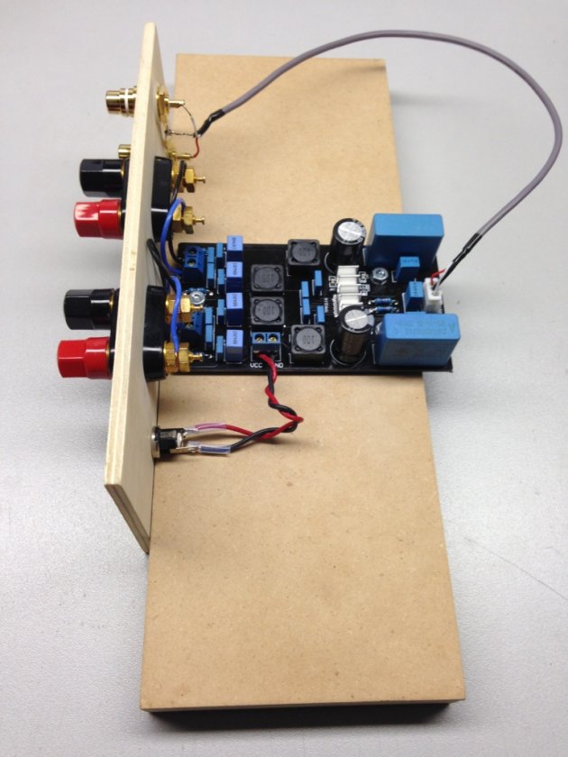

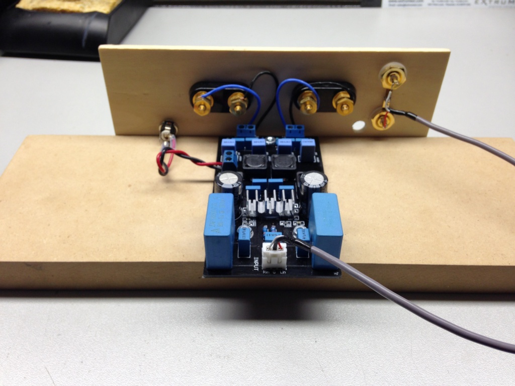

I ordered one of these Yuan Jing TPA3116D2 amps directly from Yuan Jing Audio to compare to my Sure Electronics TPA3110D2 amp:
http://www.yuan-jing.com/tpa3116-class-d-2-0-stereo-amplifier-board-50w-50w
Wow! This sounds really nice. I have a faint buzz that I suspect comes from the long hookup cable that came with the amp. My speaker binding post connections should be shortened as well. When playing music, I don't hear it, but it bugs me because I'm OCD about noise in my system. I may need to add my own custom-made shielded cables later on, but just wanted to listen to it in stock form first. Compared to my most recent Sure Electronics TPA3110D2 build, the soundstage is deeper with more space between musicians, the imaging seems to be well focused, the bass is deeper and it sounds warmer to me than my modded TPA3110D2 Class D and TDA7297 chip amps. Keep in mind, this is only based on some limited listening on SACDs and CDs I am very familiar with. I really have to give this amp more time and listen to more music to make a call in this, but I think this amp is very promising in stock form.
One thing to note is that they have the left channel connections labeled as right channel and vice versa, but it's nothing like feeding the right input and getting the output on the left channel. The channels are consistent, they are just mislabeled. At least the power supply terminal connections are properly labeled. I checked those before plugging the amp in.

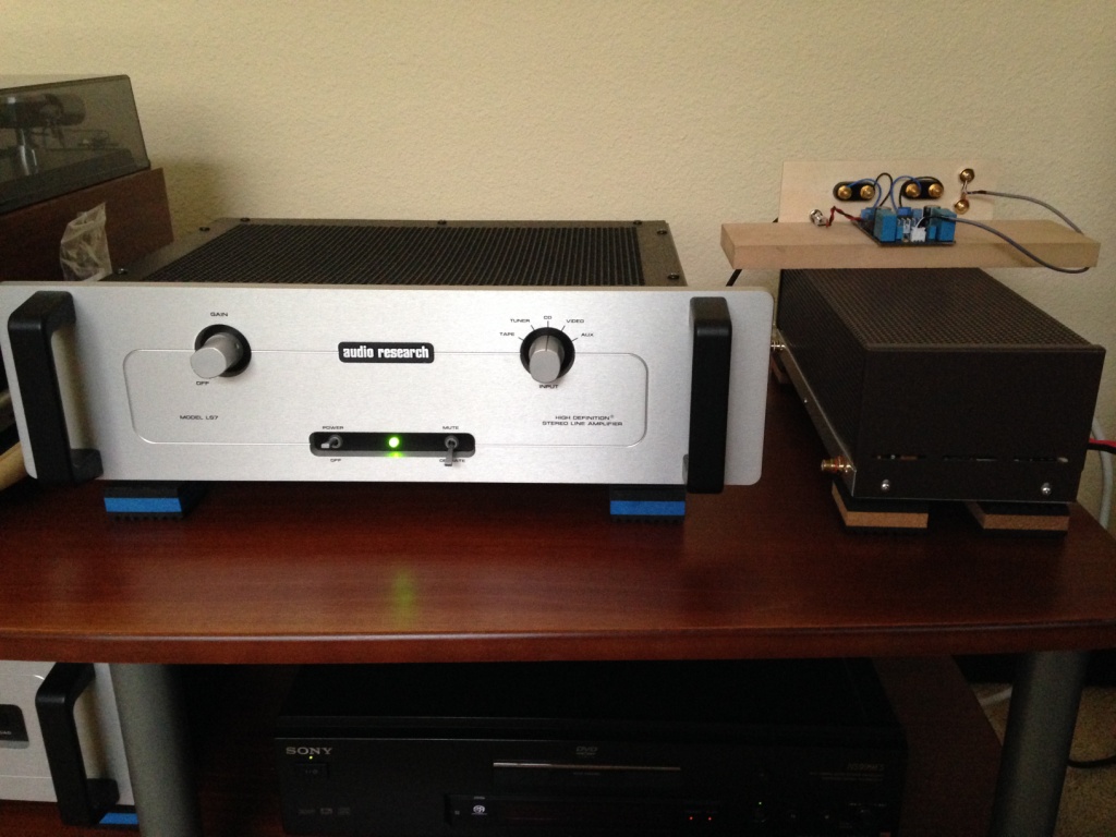

I am using my trusty modified Power One SMPS set at a 12.5V DC / 6A output. I don't think I'll need more power than this for my 98dB Klipsch Forte IIs unless someone really convinces me that I need to upgrade to more power.

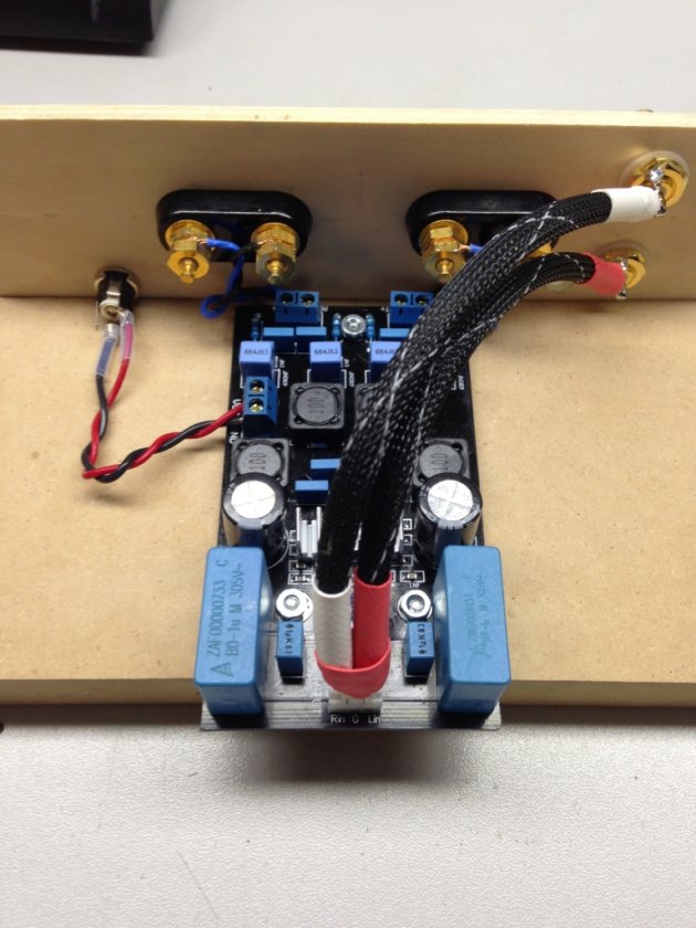

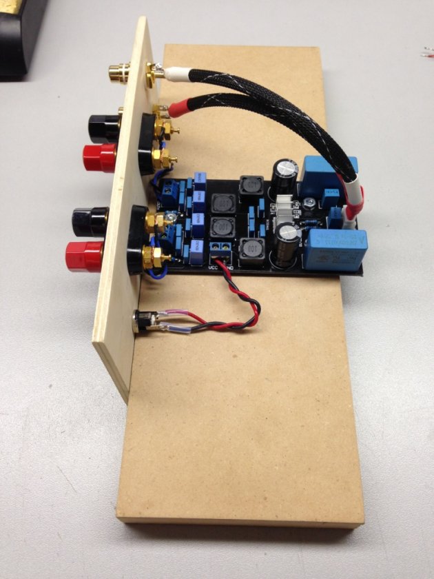

I made some custom shielded cables for my Yuan Jing TPA3116D2 amp using some Mundorf Silver-Gold wire, Teflon tubing, Teflon tape, Tinned Copper braided shielding, Techflex sleeving and some heat shrink. The noise floor has decreased going to shorter, better cables. I kept the 3-pin connector and wrestled with the crimped pins to reuse them. I am very pleased with this amp. To my ears, it sounds slightly better than my latest Sure Electronics TPA3110D2, but not by much. It definitely sounds better than my TPA7297 chip amp and it easily beats any Tripath Class D (T-amp) I've had:
