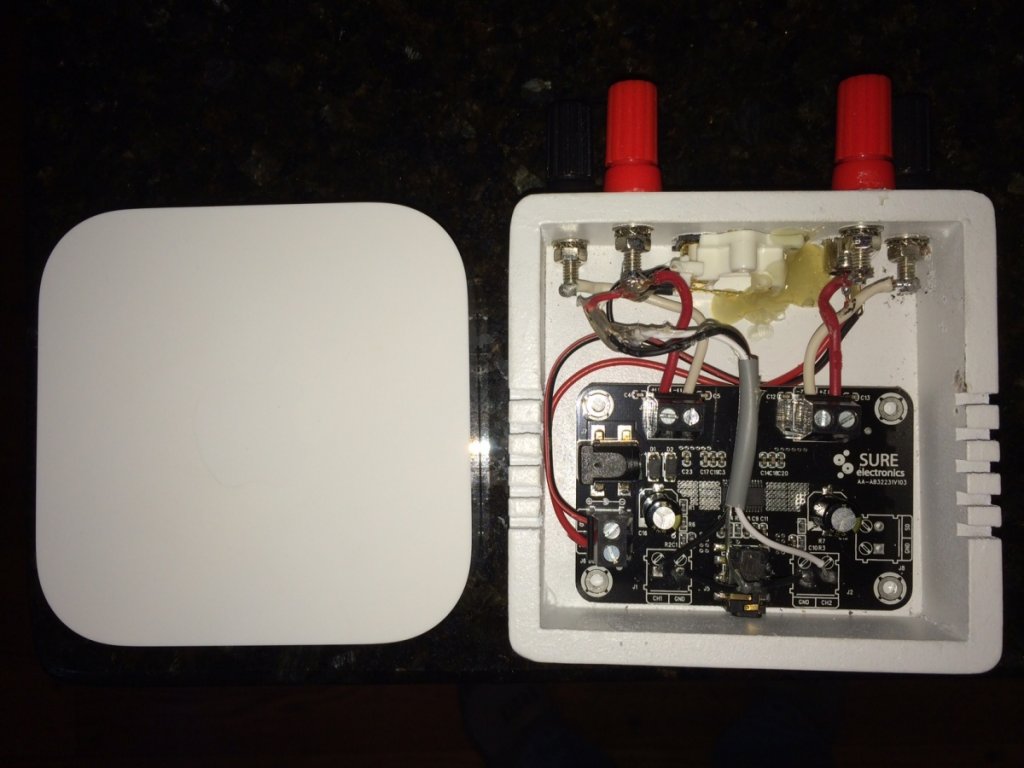

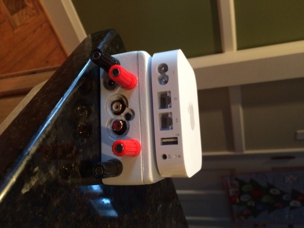

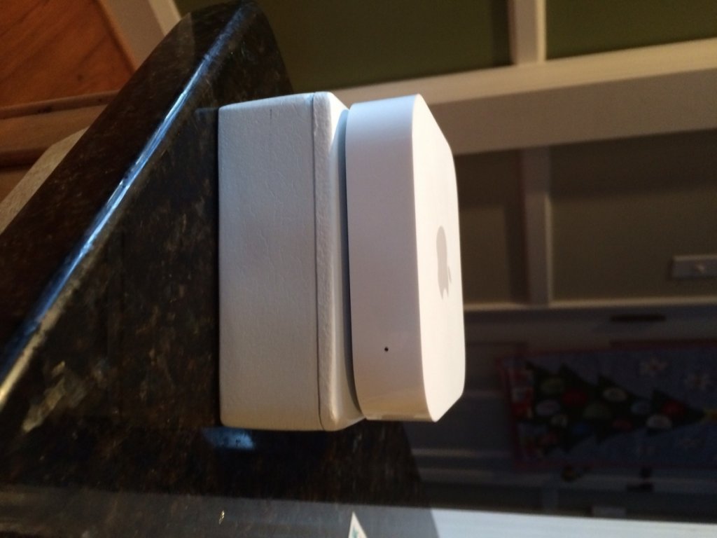

MLS
Re: TPA3110 and TPS3116 amps
« Reply #34 on: 15 Dec 2013, 09:25 pm »
Here is my Apple Airport Express inspired TPA3110 build.  I really like the way this little amp sounds.  I think it sounds better that the Sure 100X2 2050 amp.  I made it from parts I had lying around and some 1/4 MDF board.
I can't figure out how to get the pictures to be right side up :duh:

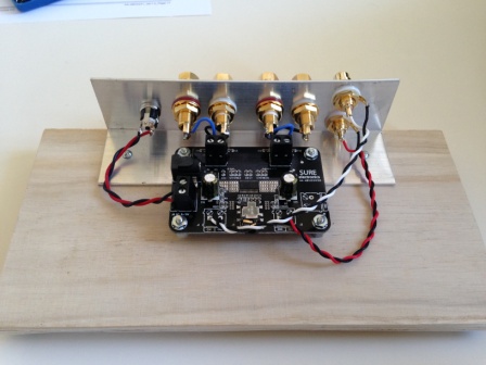

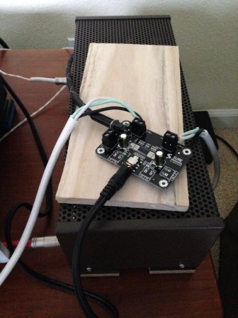

I received my Sure Electronics TPA3110D2 amp board from Parts Express. I started with the basic, "can't wait to set it up" setup with the amp and connected it to my ARC LS7 tube line stage preamp and Klipsch Forte II speakers.
Overall, I really like the presentation. To my ears, this amp is capable of delivering really good sound that is better than the older Tripath-based Class D amps I've had and still own; however, I have an issue with background noise that sounds like RFI. When I engage the MUTE on my preamp, the noise goes away.
MLS on another thread here mentioned he had the same problem with his TPA3110D2 amp when he connected it to his preamp, but when he connected it to his Airport Express, the noise went away.
http://www.audiocircle.com/index.php?topic=122152.msg1287675#msg1287675
I fabricated a makeshift test chassis using some scrap wood, Aluminum angle stock and better connectors. So then I connected my amp to my iPhone and played some music and the noise went away.
  • Anyone have any ideas as to why I am hearing noise with my preamp?
  • Is it an impedance-matching issue where I need to add 47kohm resistors between the signal inputs and ground?
  • Is it a shielding issue where this amp needs to be in a metal enclosure with shielded hook-up wire to limit RFI emission?
MLS
« Reply #38 on: 22 Dec 2013, 12:56 pm »
I have my TPA3110 set up with RCA inputs also and if I have a 3mm plug that converts to RCA's hooked up to the amp with the plug unplugged it makes noise until I plug it in the the Airport express.  It also makes a different weird noise when I have it connected to my with MacBook Air with MacBook Air running on battery.  I have a Maverick Audio D1 pre-amp that I use for an office set up and when the TPA 3110 is connected to that with RCA interconnects it also has the background noise.  The Maverick has a 3 prong plug where the airport express has a 2 prong plug.  I have tried connecting an alligator clip test wire to the metal screw holes on the TPA3110 and the chassis of the Maverick and the background noise was a little lower but still there.
So I am stumped?
