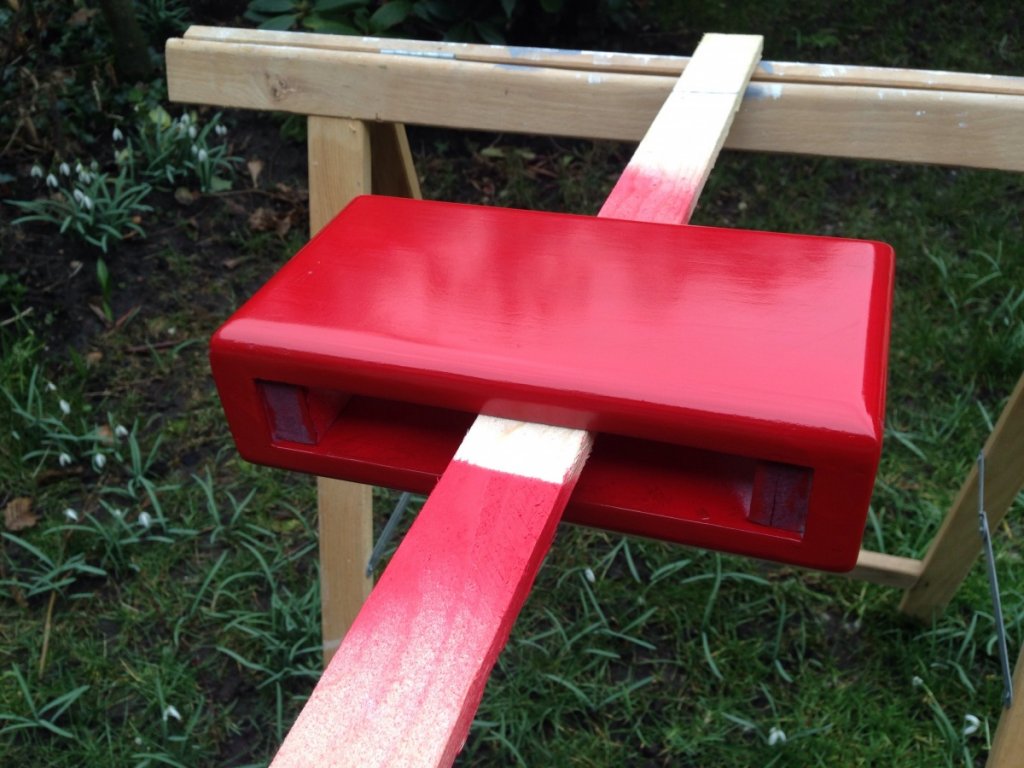

Ok so I have a question. 3116 fever struck hard so I bought the Yuan Jing blue board and some other stuff to put it all together in a home built cabinet. Maybe I will do some mods later if I have time but..... I do see that a lot of people put a Panasonic FM 2200uF / 25V on the power supply. Is this always an improvement or does it depend on the board??  And is it possible to use a bigger cap (I have a 3300uF 35V lying around)?
Also, I read in some posts that this board does "pop" when flipping the power switch. Now the board has not arrived yet so I don't know if this  "pop" actually occurs , but any suggestion up front  on how to prevent this "pop".
Update 2014-03-05:
I the meantime I received the board and it does not pop so I don't have to worry about that. Also I did end up buying the Panansonic FM caps because these appear to be the best onces. According to many hour of reading online.
I made some progress on the cabinet/enclosure already. I used some pieces of MDF, some red spray paint and I bought a strip of alumuninium (30mmx3mm).  I think will not use a volume pot because when this i finished I would like to combine it with a 6n3 preamp. I temporarily connected everything and so far I am pleased with the results. The board is connected to my airport express for now.
