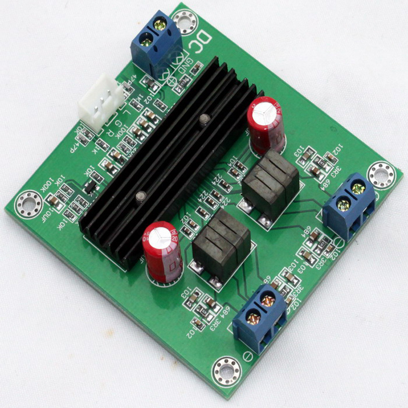

Got one of these on order.  Seems to be the same design as the Audiobah green board.  Now the hunt begins for all the other parts...

Just received my 3110 2 X 15 watt amp board from Sure in a nice box .
RCA input jacks are mounted on the board itself.
Now just waiting for the caps and switches from Digi-Key.

Got a break from work and hooked up my Sure 3110 board to a pair of Amethyst speakers . Source was a Sony portable minidisc player for starters.
Right away sounds very nice at medium to lower volumes. I'll have to add a pop protection like the one Matt used on his board.
The 16 v/ 4.5 amp   laptop brick I got on line has a 2.5mm barrel and was really tough to unplug . The Sure onboard jack must be for 2.1mm jacks ?
Since the Amethysts are 4 ohm cabinets I then changed to the 24V brick that came with my Dayton DTA-2 and it must be a 2.1mm plug barrel as it's a much nicer fit.
I then interfaced my Little Dot MKII+ tube preamp which the Sure board quickly didn't like  as it went into shutdown mode in about a second.
The Little Dot works very well with my Topping and DTA , not the Sureboard  though.

« Reply #1275 on: 20 Jan 2015, 06:28 pm »
Some mentioned earlier tpachips getting real hot with Dayton brick, inductors too, so could be unfiltered switchingfrequency???? When little dot adds a little in that frequency range it could be too much maybe???? BTW above 16V tpa3110 isn't giving anything extra imo, power is identical if I remember datasheet correctly.
Check the output voltage of the 24V Dayton brick. The one I have delivers more than 24V.
