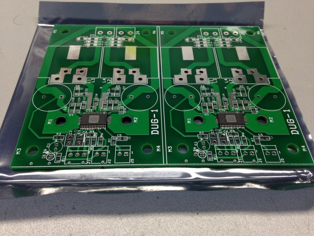

I just received my DUG TPA3116 PBTL amp PCB's with the TPA3116 IC's mounted on them. I purchased these PBTL boards through the diyAudio.com Group Buy thread:
http://www.diyaudio.com/forums/group-buys/257996-gb-tpa3116-8-pbtl-bare-pcb.html
I can work with the other SMD's, but I didn't want to risk wasting my money or boards trying to mount the TPA3116 IC's myself. DUG will test them too for an additional charge.
