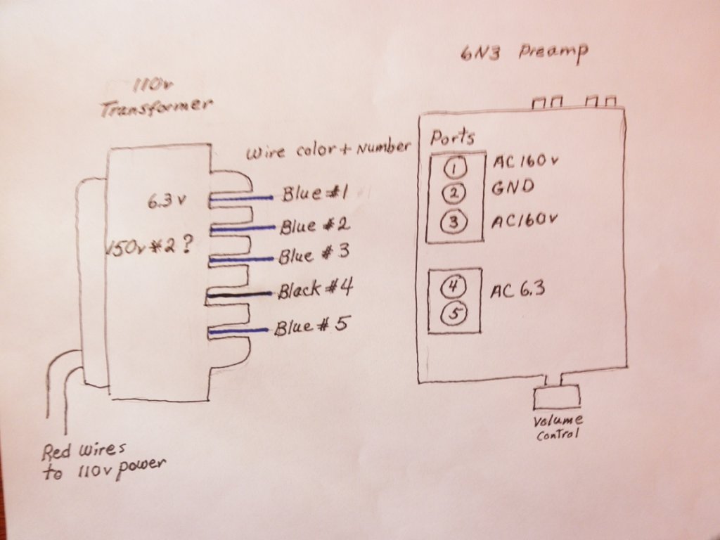

« Reply #1140 on: 16 Sep 2014, 12:41 pm »
If your 6n3 preamp is like mine:
Blue #1 to #5 port ( AC6.3 )
Blue #2 to #4 port ( AC6.3 )
Blue #3 to #3 port ( AC160v )
Black #4 to #2 GND port
Blue #5 to #1 port ( AC160v )
« Last Edit: 19 Sep 2014, 10:40 am by Poultrygeist »
