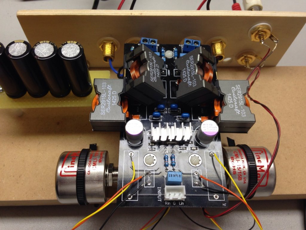

I followed dboy's lead and installed a pair of CineMag CMLI-15/15B input transformers on my modified Yuan Jing blue amp. This has to be the ultimate mod for these amps. The soundstage is huge and the tonality is so natural. I wouldn't recommend this for a desktop computer system, but if you use these TI Class D amps in your main system, this should be a serious consideration.

Fantastic Rhing. Very glad you like this, although Sharpi31 on Diyaudio deserves the credit as first here, not me.
If I remember correctly from several years ago when I first installed transformers in my dac, they took quite a while to reach their best performance. So you may have further treats to look forward to (although different transformers so no guarantee).
Your results mirror mine - the size of the soundstage was the thing that really hit me at first. Then the sense of intimacy with appropriate recordings.
Are you still using your line stage as well or have you removed that from the equation now? I was a little unclear when you wrote about your intention here a few days ago.

Rhing, another question if I may. Do you have any hum coming through the speakers if there is no component turned on connected to the transformer primaries. I found I got a hum if my dac was off but the amp turned on. I avoid that happening now by having the power transformers for both in the same box, fed by the same power inlet. But I am curious whether this happens for you too.
I have not heard any hum issues since I've connected the input transformers in my YJ blue amp. I always have everything connected before I power up equipment. First I start with source equipment and work my way to the power amp. When powering off, I work in reverse order starting with the power amplifier and work my way backwards through the chain to the source equipment. I learned this working with pro audio systems where you could easily blow out speakers and amps. A sound systems consultant who used to be the concert sound engineer for Van Halen taught me this simple rule.
This guy had golden ears too. I had never seen anyone EQ a room with a complex dBX room correction system by ear before. He opened my eyes to Allen & Heath mixers and Lab Gruppen Class D pro audio amps--high end pro audio gear. That's why I'm stuck on Class D amps and using balanced inputs now.
The soundstage with the input transformers is incredible, but it's also the transparency of the amp that impresses me too. I hear more music; it actually sounds like it's playing louder, but not in any obnoxious way. It also seems like the dynamic range has increased like there is no ceiling to transients, especially loud events like thwacks on drums.
I am still using my Audio Research LS7 tube line stage preamp along with my Audio Research PH5 tube phono stage. With tubes up front, I get more of that holographic magic that tubes can produce.
