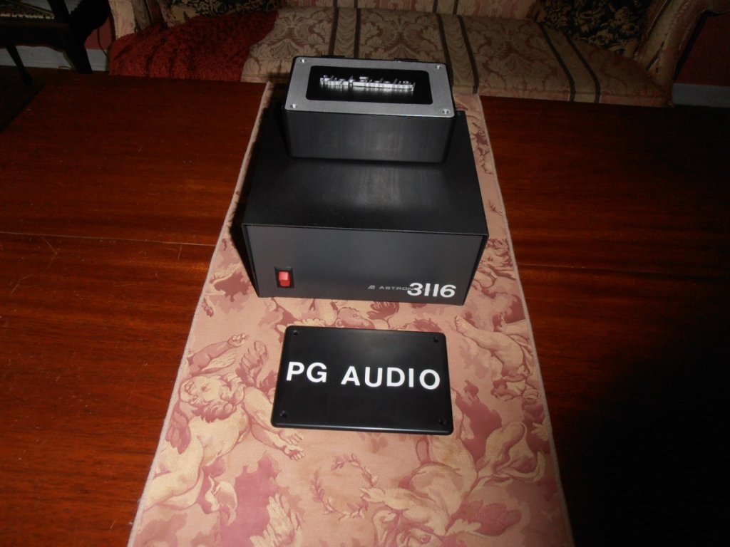

Here's my 3116 mounted and internally wired to an Astron power supply. The Astron takes it to another level.

How are you guys doing the face plate labeling? It looks 'sweet' :thumb:

Nothing special in my case, just small stick on letters.
