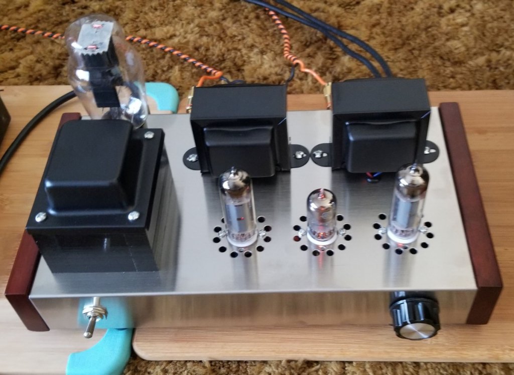

4' x 2' x 3/4" birch plywood baffles - mounting holes cut yesterday evening - no bracing yet - no legs/support - held up by an ottoman (L) and a DR table chair (R) so I can listen/evaluate.
So far I am impressed with the bass from these Zenith 49CZ903's (FS is @ 52Hz - some 30+ Hz lower than the popular 852's) with the music I mostly listen to (Brubeck, Petersen, Webster, etc, Mozart, Paganini, etc).
I was listening to a Focal demo disc at louder SPL's than I realized (louder than I normally listen) when a choral piece (Verdi track #14) made these drivers fall apart*, everything before it was pretty good, and the choral piece was much better after lowering the volume control some.
If you like complex music fairly loud these are not for you. Hopefully you already knew that.
* part of the problem may have been the 1~2 watt inexpensive triode strapped JBH 6P14P tube amplifier I was using was past its limit.
