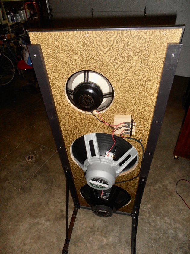

Maybe my best open baffles so far: Lowther, F-15, and Eminence Alpha
Poultrygeist
Re: Lets see your O.B. speakers....!
« Reply #530 on: 8 Jul 2022, 10:58 am »
I noticed many of the youtube videos are featuring the Lii Audio Fast 8 wired in parallel with the F-15. I didn't think too much of the idea until I tried it with the Lowther DX3 and F-15. Now I'm a believer. No crossovers or filters other than the frequency control on the plate amp which powers the Alpha bass woofers. The DA-9 amp I'm now using to drive the Lowthers and F-15s does have some useful EQ settings. I'm lost for words to explain how good this set up sounds.

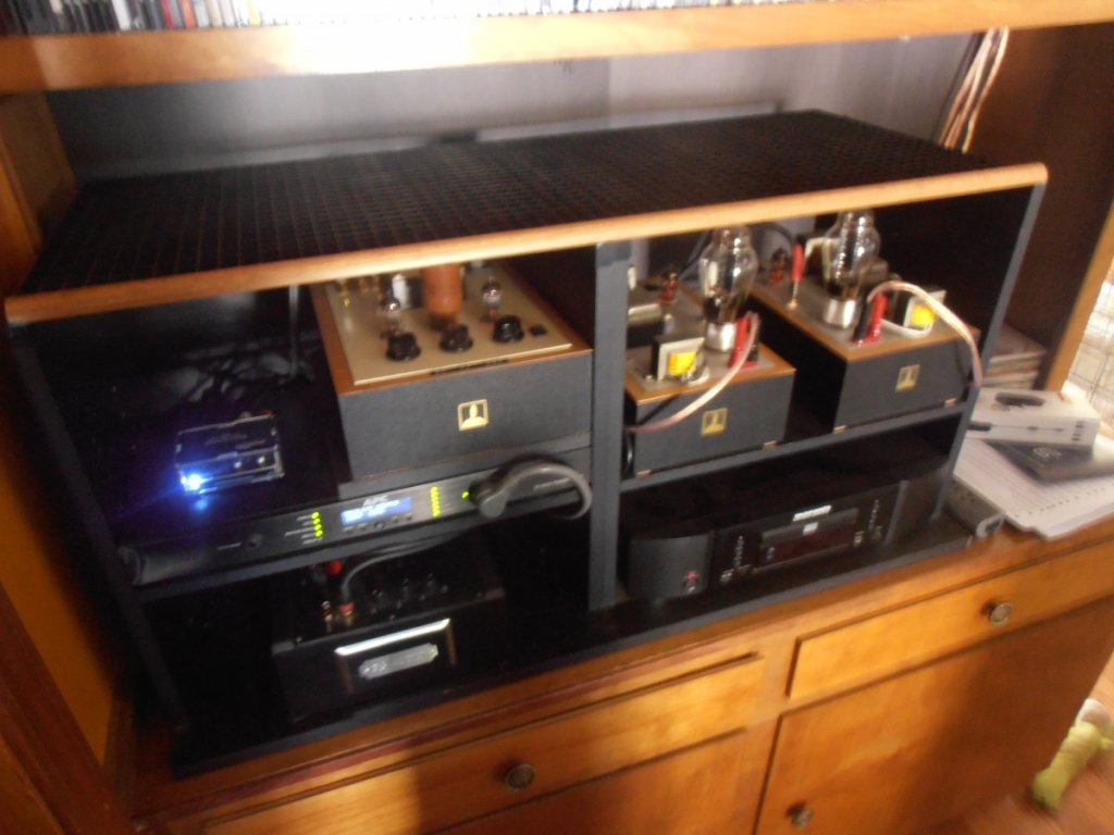

As nice as the SMSL DA-9 amp sounded driving the DX3's and F-15's things improved when I subbed in the 2a3 Bottlehead mono blocks. Had to rewire the OB's from 4 ohm to 16 ohm as I was afraid I might stress the Bottleheads which are wired for 8 ohm speakers.

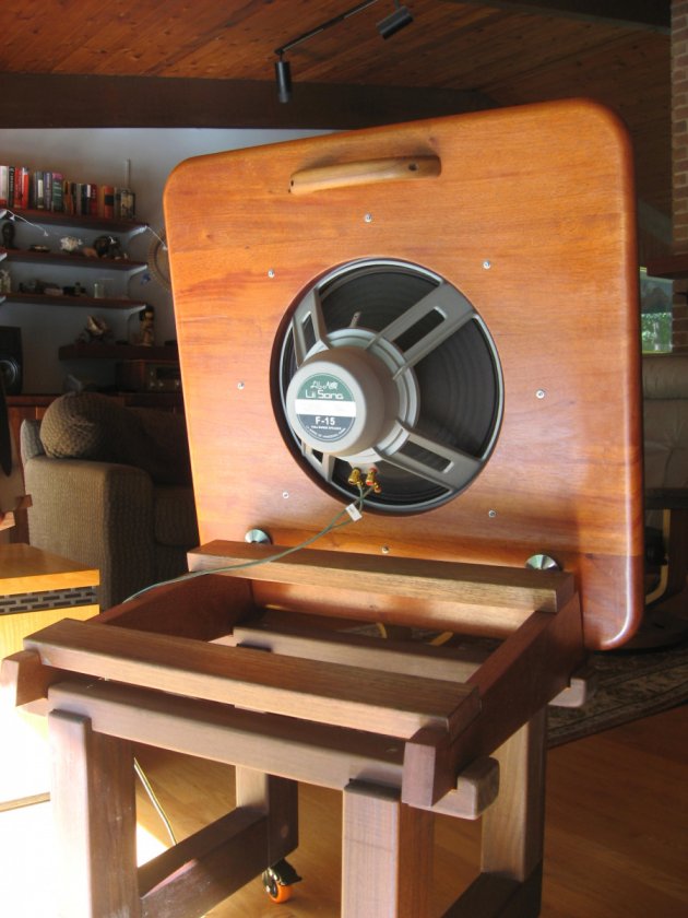

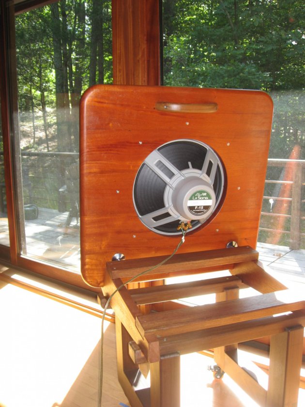

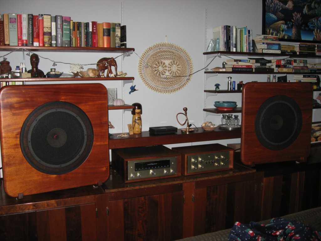

I started out by building solid mahogany baffle boards (28" x 28" x 1.8") for the Lii-Song F15, with flush grill rings. Also, floor mahogany stands with adjustable tilt.
The imaging was suboptimal with the floor stands, so I tried raising the speakers to built-in cabinet height - imaging greatly improved, but now too high for my taste.
After several more experiments, I built a set of ironwood (ipe') rolling stands to raise the floor stands to my ideal height and make trying different speaker positions easy. Now it all sounds great IMO. I do use a subwoofer occasionally to augment the bottom octave, but it's rarely needed I've found.
