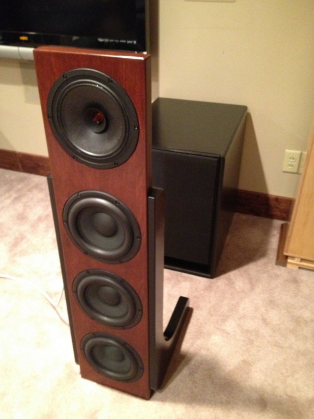

Sure it's a dayton RS270 xO at 300 and a Peerless HDS 6.5 mid xo at 2500 to a SB29 tweeter all 2nd order and mid polarity inverted. The cabinet internal volume I think is 1.7 cu ft. I can send schematic if you wish. Also since I believe speaker project is never "done" if there are any changes in the drivers someone would make please suggest. I am always looking to improve. BTW the XO parts are all good quality caps (Jantzen). I will be upgrading the internal wiring and binding posts.

Jimbones,
I think it looks very good. Very nice design.

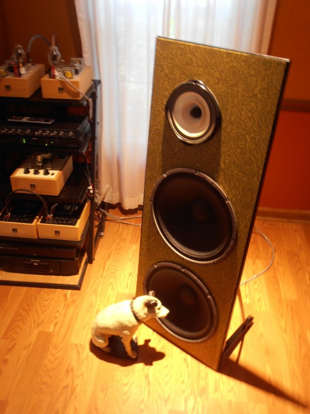

Dayton Audio PS220-8 full range over a powered H-frame Eminence Alpha 15. The network is a parallel notch filter that very effectively tames the Dayton's 3.6khz peak.

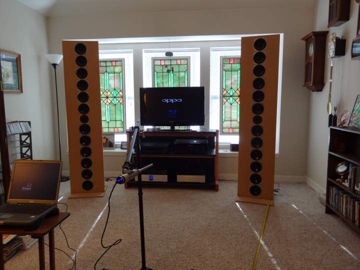

The "Sweet 69's". Twelve PE 69 cent buyout Sony 5.25" woofers with a Vifa DX25 tweeter. These cost about $100 to build, and they are worth every penny, but not one penny more. The Sony midwoofers perform no better or worse than you would expect a really cheap boombox speaker to perform, with a significant breakup peak around 5khz, but when you combine twelve in an array, the comb filter effect almost completely eliminates this effect. So the woofer array runs full range with no low pass filter, while the Vifa tweeter is crossed at about 2.2khz using a 3rd order high pass filter, resulting in a reasonably smooth transition. Nobody will ever confuse these with high end speakers, but with a subwoofer to handle the bass these are great party speakers that you would find it hard to blow out, even at very high volume levels.

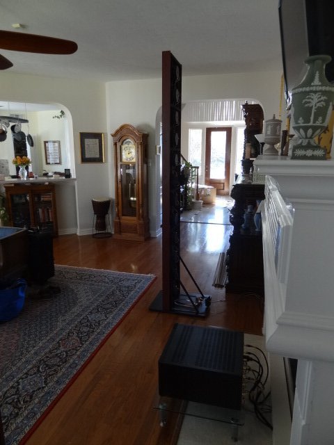

The "Towers of Awesomeness". Each 7' 9" tower incorporates twelve Dayton Audio RS180 midwoofers and nine BG Neo 8 PDR tweeters. Bi amplified using a DEQX processor for preamp, digital crossover, speaker correction and room correction. The midwoofer/tweeter crossover is a 48dB/octave LR at 1.2khz. The subwoofer/midwoofer crossover is a 48dB/octave LR at 100hz.

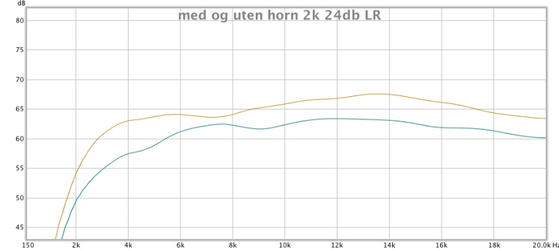

Can you just give a short comparison of the sound of the Raal with and without the wg? Lastly, will it go down to 1200hz as the specs say?

i cross them at 2500hz and probably wouldn't go any lower.
the reason for the low limit of the horn, is that you don't want that limit to be anyway near your XO point if you want them to sound any good.
compared with the stock ribbon, the horn has a very good disperion off axis, and more power below 6k hz.
when i compared them, i found the horns to give a more tactile and punchy sound to the speakers.
good off axis disperion is also a plus, as my livingroom is untreated.
here is a measurement of the RAAL with and without the horn.
