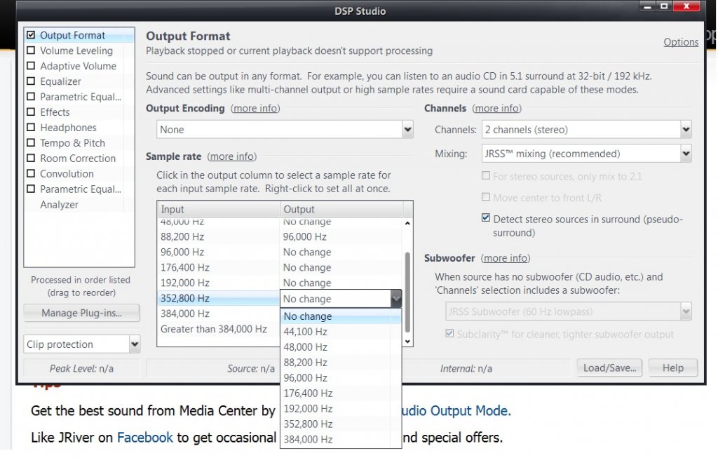

Can you take a screenshot of your DSP page?  Your JRiver install my be re-sampling.  It should look something like this...(in this older example the dac couldn't handle 88k so I had all 88k upsampled to 96k) with everything set to no change except any sample rates too high for the BDA2 (like 352k), or set to downsample DSD to PCM, for example.
All of this is in my videos, btw.

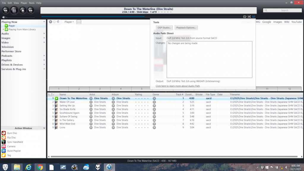

Hey Ted

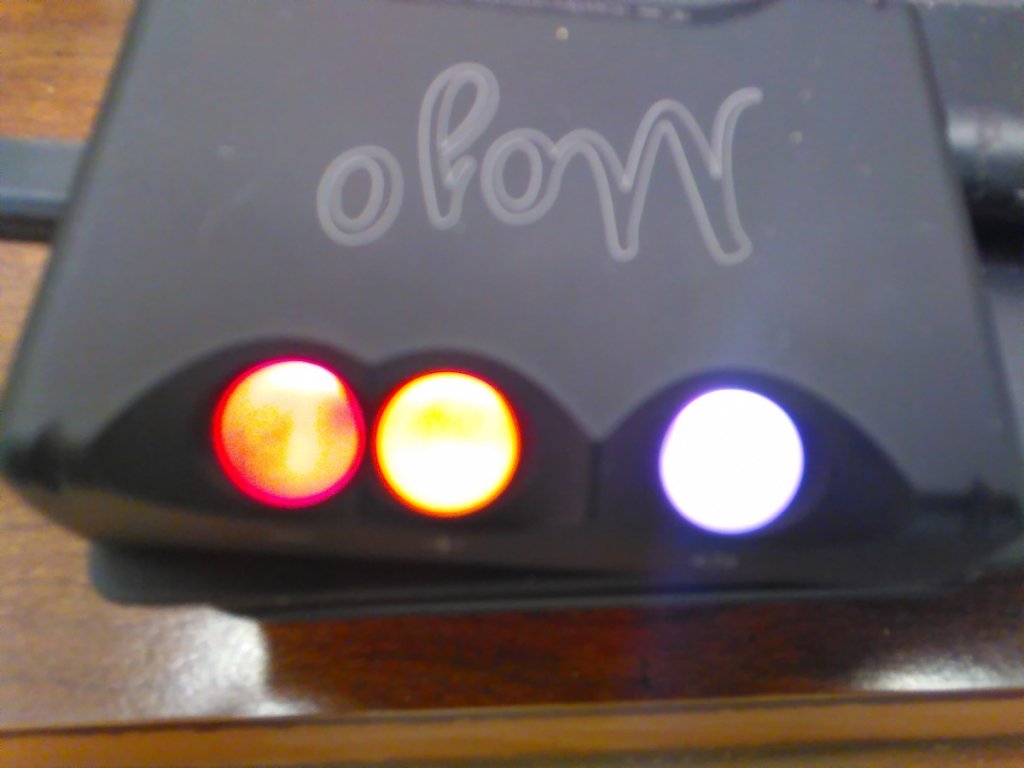

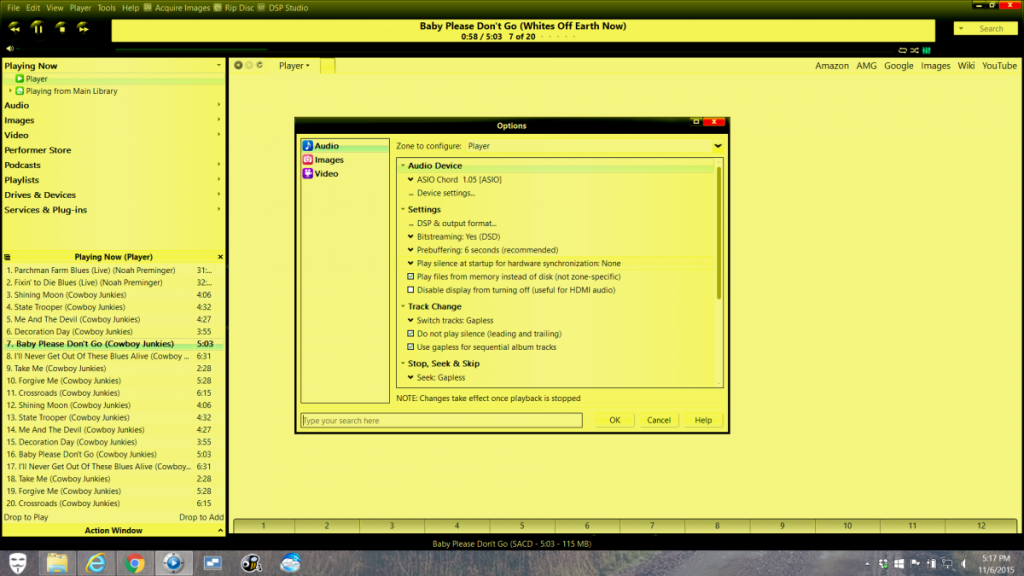

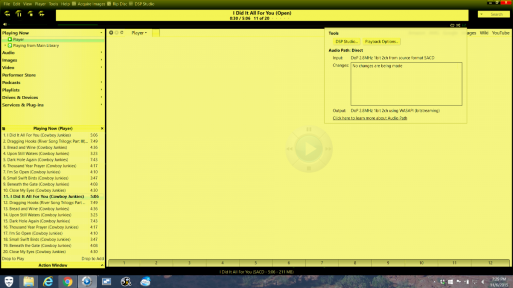

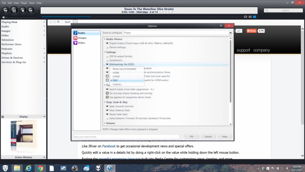

I just got my Chord Mojo and it's playing dsd as 768k. I have JRMC19 and downloaded 21 as a trial. I have teied asio, wasapi and ks. It's set to bitstream dsd and no resampling is taking place. Here are a few screenshots. Thanks

« Reply #22 on: 8 Nov 2015, 12:10 am »
Your screen shots confirm that input and output are both DSD64 (2.8Mhz).  JRIver is playing it fine.  Where do you see 768k (color wheel on Mojo)?

Yes the power button/sample freq light is wrong on anything over 192k. Dxd shows as 192k. Dsd shows 768k.
Hard to tell in thepic of the mojo but it is light purple- 768k.

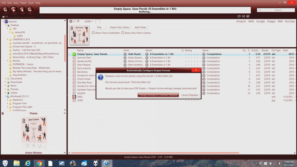

« Reply #26 on: 8 Nov 2015, 04:07 am »

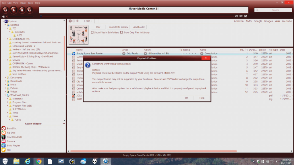

Ted I also had a coupon code 8 Ensembles in 1bit and it wouldn't play at all.
