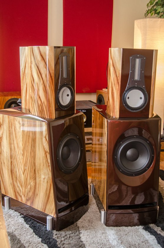

Beautiful
Could you describe the finish/veneer?

Beautiful
Veneer is Walnut Burl with a touch of amber added in the finish.  The finish itself is about 30 coats of 2K Urethane, wet-sanded to 3000 grit and the buffed.  The painted parts are a AMG Mercedes color called Sepang Brown, dark brown base with heavy gold/bronze flake.

I wanted to share a few pictures that show how the top and bottom cabinets interface.  Like everything we do it's well thought out, with much consideration for appearance AND function.  There certainly would be easier ways to do it, but easy isn't my concern ... making each design unique, elegant, and able to separate itself from the rest of the pack is my concern.
So with the Joule we have two distinct cabinet, each shaped the way they are because function and performance does come first.  Every curve and angle is there for a reason which translates into performance of the final product.  But the end result is two cabinets with very different profiles, how to blend those two pieces together visually so they look like they belong?
The bottom cabinet is stacked ply side to side, that allows us to cut into the slices a perfect 10:1 tapering TL - no stair-step internal bracing to form a line like essentially everybody else does.  And by having the perfect taper, gone are all the midrange resonances that come from having any constant cross-sectional area inside the line.  Port output from the Joule measures textbook perfect, a peak at tuning with resonance free 2nd order roll-off above.  But stacked side to side, that makes the top to bottom cross section rectangular.  So to blend it visually with the curves of the top section, we add 3D CNC's pieces on the top and front of the bottom cabinet.  The front baffle adds curves and visual interest that couldn't be there any other way, and the top section does the same but also creates a cradle for the top cabinet to rest into.  Also in the top piece are pockets for Herbies Fat Dots to isolate the two pieces.
The top cabinet is shaped the way it is because for midrange/treble reproduction, there are different considerations for ideal performance.  Eliminating edge diffraction and cabinet resonances are the primary focus, and the top cabinet does that completely.  The other consideration with the top cabinet is creating an internal shape that greatly decreases the sound inside the cabinet from reflecting back through and out the woofer cone.  The internal shape was designed through use of Finite Element Analysis, and I'm unaware of ANY other company who has employed such an approach.  And finally stacking the top cabinet top to bottom allows us to create a void inside the cabinet walls which is filled with our Inversion Layer material before being capped off, this greatly reduces sound transmission through the cabinet walls.
Tell me anybody else out there who goes to these lengths for less than kilobuck asking price?  And not just in pursuit of performance, but also for appearance.  Compromise and making things easier is of no interest to us.

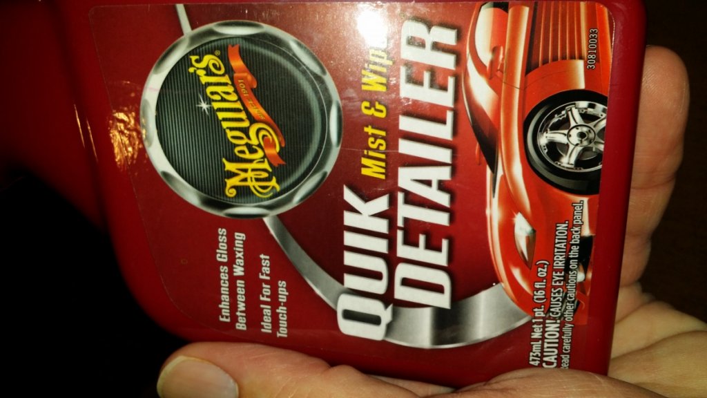

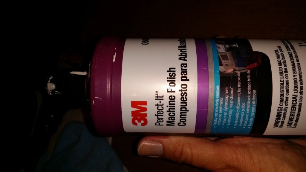

bajaed
Re: Our latest builds
« Reply #113 on: 15 Nov 2014, 02:36 am »

I'll be wet sanding/buffing something this weekend if you want to watch, or I could bring pieces down to Casa Jackson.
Daily care is same as a car, always remember dust is nothing more than teeny tiny rocks ... don't rub them to remove, lift them off, or else learn to enjoy swirl marks.  And when you do get swirl marks, buff them out same as you would with a car.  Wax helps to protect from those teeny rocks touching the clear and scratching, and can fill small swirls.

Try the new Ex in the slightly darker purple bottle, thank me later  :wink:
