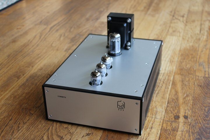

It is a large tube and the shape of it puts the tube about 2mm from the transformer.
And Contium, it is a sexy looking phono pre, thanks to Jim for building it and offering for sale. I was glad to win the auction. Jim thought it was too much silver, but it looks great in my system.

On a side note, the 2mm spacing should be no problem.
